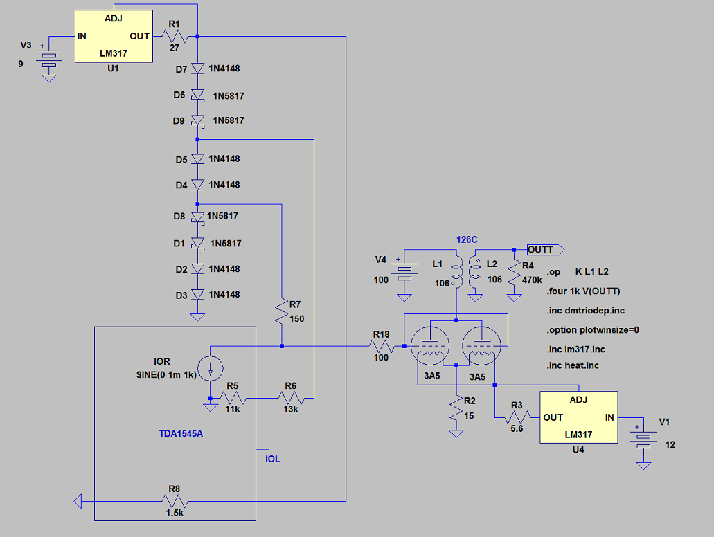

O.K. than please tell me, how is the circuit biased here:
Phono Preamplifier with 3a5 Directly Heated Triode
I would like to understand.😕
Tyimo
In this example, the bias is a form of filament bias. The resistance of the filament supply itself is used to bias the tube. Let's break it down:
For V1 one terminal is taken from the middle of the common filament (pin 4). The other terminal is taken from the ends of the filament (pins 1,7), which are connected together. This is now two 1.4V filaments in parallel, but you can treat it as a single filament from here on. It doesn't matter which of the two terminals is connected to supply negative or positive. What does matter, is that whichever terminal is connected to the supply negative (battery or filtered DC), is also connected to common. If this is done, and the filament supply is 1.4V, then one end of the filament will be at 1.4V, and the common end will be at 0V. So the difference between the filament and grid, will be be a linear ramp from 0-1V. If you look at the plate curves, this represents the 0V curve. So the bias for this tube is considered to be 0V.
For V2, a second supply is stacked on top the supply for V1. So this filament is actually biased from 1.4 to 2.8V above common. We again take the negative side for our calculations, and call that 1.4V bias.

Tyimo,
The section on the bottom right of my phono amp schematic is the current source I'm using. It's actually simpler than it looks, only 5 transistors, and performs very well. The ZTX and MJE Darlington pair form a simple cap multiplier, that feeds a diode biased current source. The BC transistors are wired as diodes to bias the 2SA1887. I used what I had in my parts bin, so lots of different possibilities for parts. But the 2SA part is a nice one for this. I'm using one cap multiplier to feed two CCS's (one for each channel).
Sheldon
Tyimo,
Did this design quite a while ago for my friend Bardis who built it and showed it with great succes at our yearly DIY-fest.
Bardis decided to use a DN2540 circuit on top to get low Zout. Have schematic somewhere in my computer.
I don´t remember, but the figures for the DAC where decided after a discussion with Thorsten L. here at diyaudio.
R2 is choosen to give the right bias with 220ma going through it. Ia somewhere in the ballpark of 9mA for both halves together.
