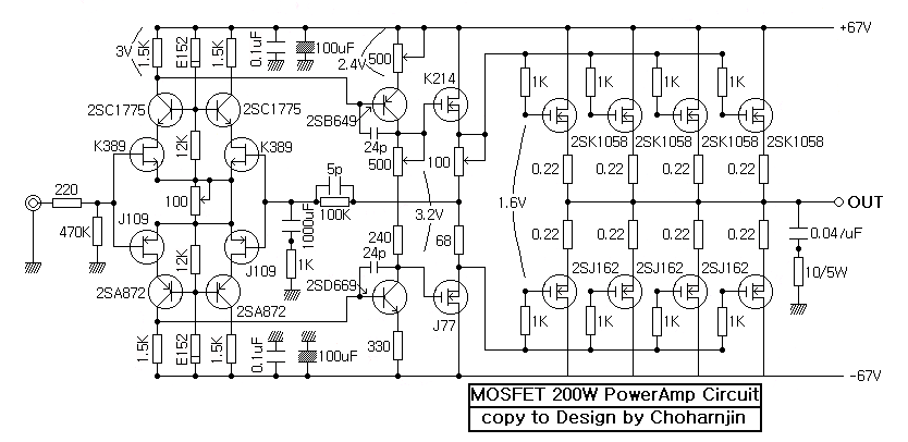

K170/J74 are quite hard to get and expensive, so I was thinking of using K389/J109 instead because I have two pairs of them.
What is going to happen if I convert the F5's front-end like this one using K389/J109 with or without C1775/A872?

The 100rVR has a short across it.
Is that circuit from a reliable source?
389/109 are 170/74 , double die
JFets on that schematic must be cascoded , due to rail voltages involved
if you read F5T article , everything is explained there - when and how to cascode (or not)
Sure, if I am going to actually use 389/109 with 24V rail of F5, I will remove the cascode.
What do you think about the differential topology of 389/109? Will it work with F5? To my understanding level, it will, but since I am no expert...

It is basically designed by a renowned Japanese audio reviewer and designer,
Kubota Takashi
His favorite style is (although not always used):
- No NFB from the speaker output
- FET
- K389/J109 pair for input
- Regulated PSU for input/VAS, unregulated for output
- Simple is better approach
His work has been published on Japanese audio/diy magazine MJ, as can be seen here:
MOS-FET AMP - ???? - Audio ??? - Yahoo!???
Some critics that his symmetric design has too much odd number distortion.
What do you think about his circuits? It looks like they were very popular in Asian countries in 80's and 90's.
you can either put them in parallel , having iteration of F5 with slightly greater OLG etc. , but if you use that differential topology .... that's another amp

So I simulated F5 with K389/J109 differential front end using LTSPICE.
Basically I could achieve similar output characteristics but with more carefully feedback. I think it is because feedback is fed by one of K170/J74 in the K389/109, which is different from feedback fed into the source resistor in F5.
