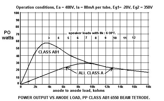

the classic Dynacos are well built if you compare them to present day China made amps, have seen one using KT88 tubes but using OPT's that are smallish in size....

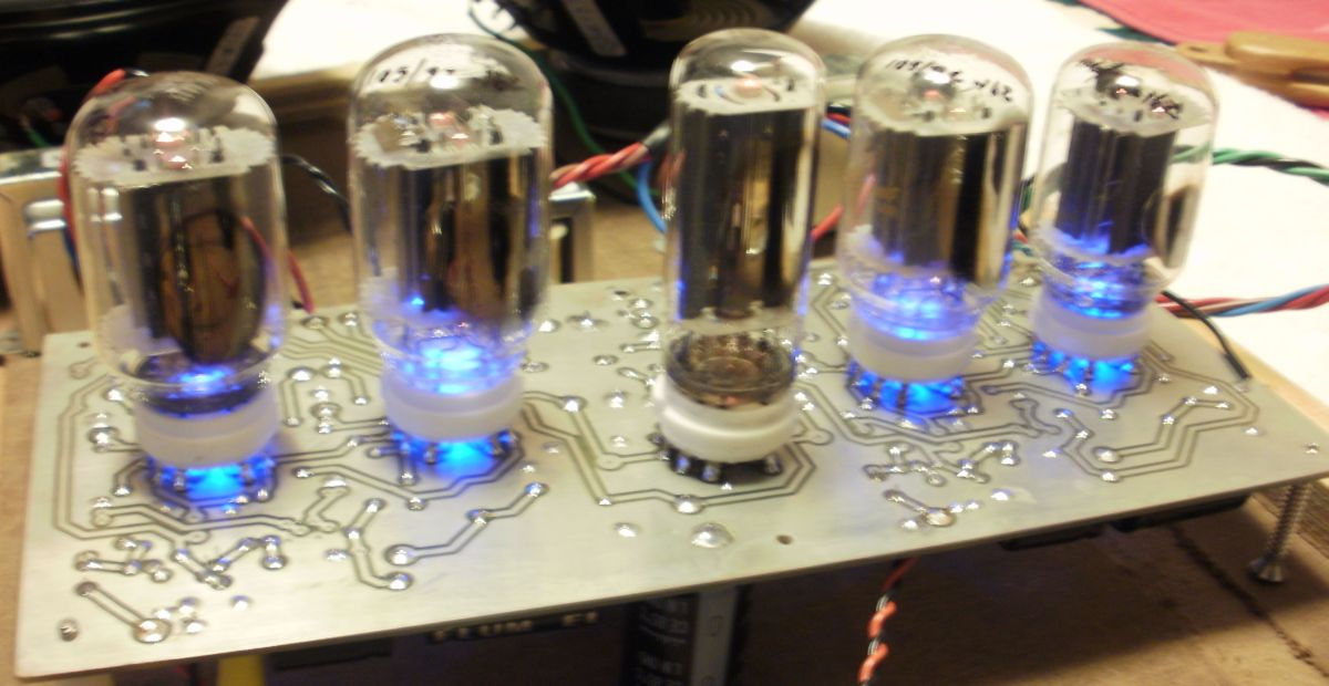

I've been trying to find older iron for both power and output. My latest MEC ( mouse electric chair) project is based on 6LU8 family in the Dynaco St70 topology. Main difference is in the feedback. The Bogen output iron is 6.6KRaa which allows for more class A output, yes less overall power and the PT is from an organ donor. Large iron with 12Vct heater winding. All iron stays cool after 8hrs of thrashing. Sweep tubes in place of the 6L6 based tubes. I used .22u PIO to couple the cathodyne to the outputs. Diode and large cap power supply allows for the low end to breath. The 6LU8 family are 14 watt tubes and can perform at higher than rated levels ( some not all). This proves the basic St70 topology is very good. There are just many ways to implement it with their trade offs.... Dynaco chose theirs and I chose mine...

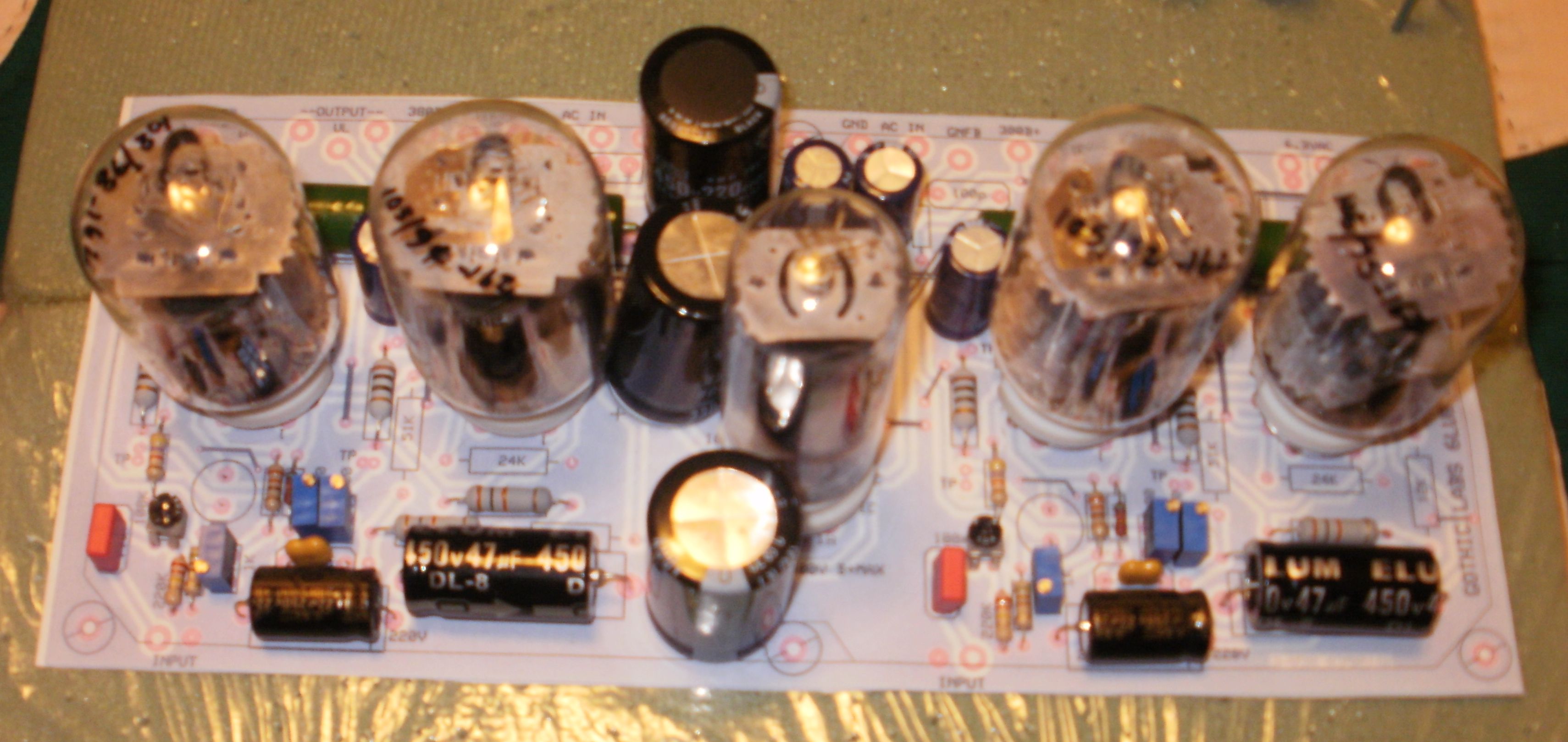

The next PCB is again the basic St70 topology, but with 17JT6 and 18GB5 output tubes...
