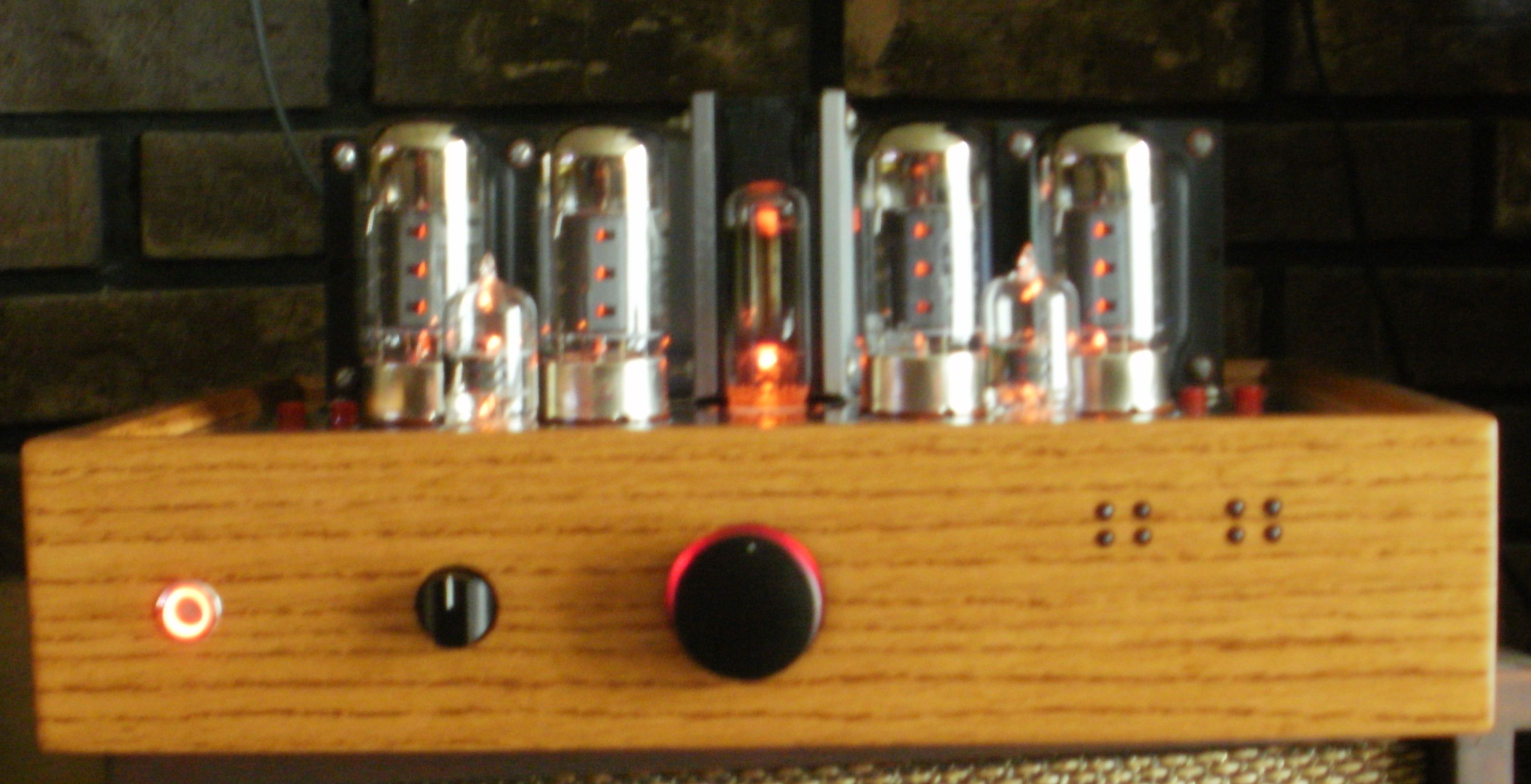

Here's my ST-35 with tesla tubes.

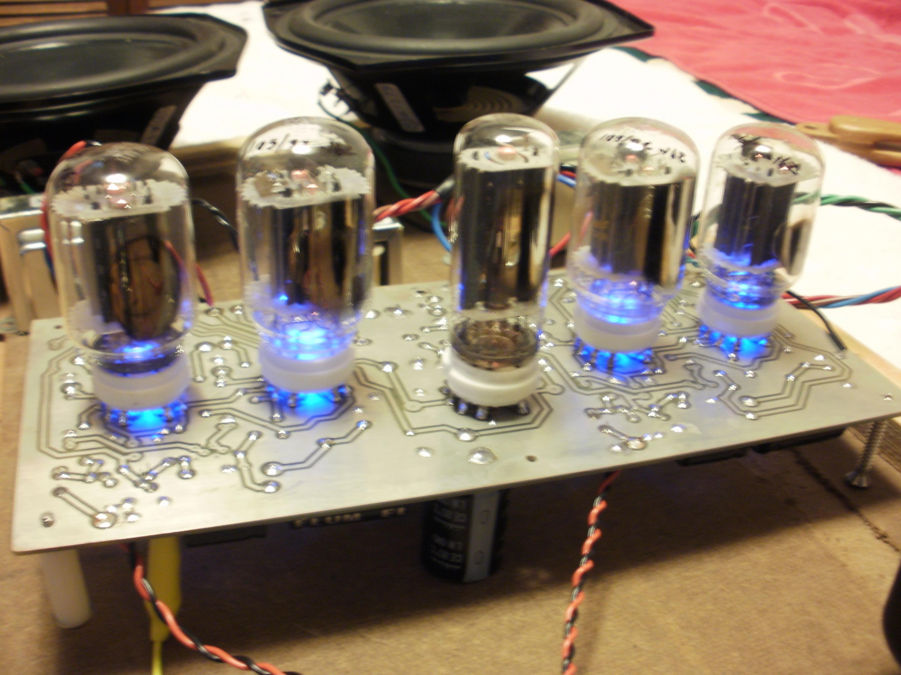

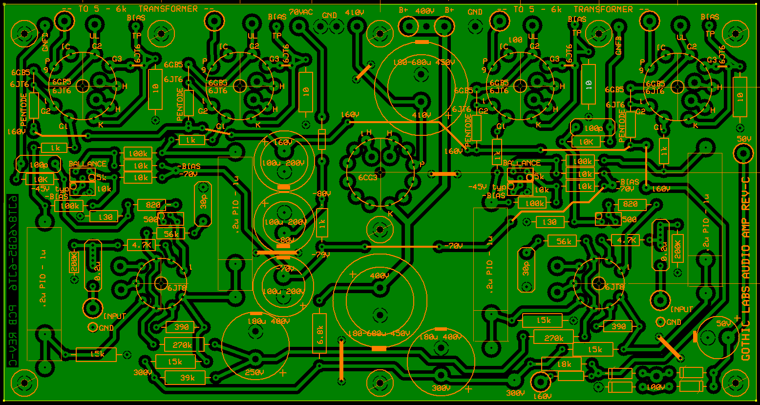

I did a KEGGER ST-70 clone PCB and I've been playing with an assortment of iron and output tubes.
The little 6P3S are the least expensive and worked great at 360V with little 8k-8 30watt iron triode more and 6.6k hammond 40 watt UL and Triode mode.
I bumped the power to 475VB+ and tried 6P3S-E 5881 wafer bases, UL and triode mode in 40 and 60 watt 6.6k hammonds, then Svet 6550=C=, followed by EL34's and KT88's.
I've been listening to the Russian 5881 wafer bases for a couple weeks in triode mode with the 40 watt hammonds and found it to be very respectable for the low cost of the 5881's. All tube/transformer combinations sounded better than SS, some were better than others. ( 5881 and 6550 were my favorites in triode mode, 40 or 60 watt 6.6k outputs)
With my speakers and listening room, triode connected is preferred for the fullness of sound, UL sounded a little hollow.

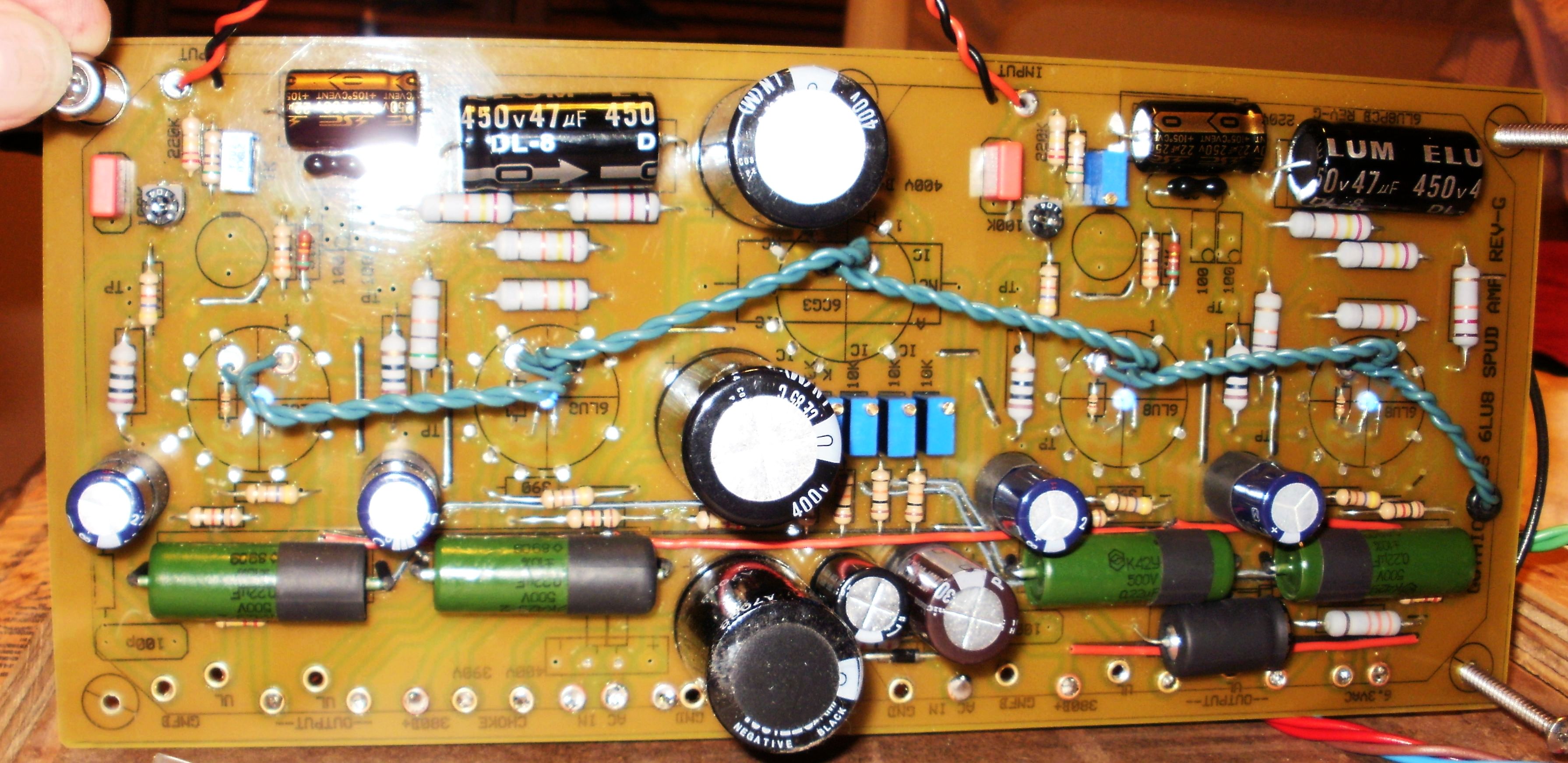

The stock ST70's were weak on coupling caps and power supply, each can be addressed. A truth in advertising was done and revealed that the Stock St70 was only about 18watts RMS/channel.
The modern driver boards with LTP design are a huge sonic improvement, adding additional filtering for the B+ helps to sustain the low end, larger PT current capacity also helps and runs cooler and can boost the true output power!

I prefer DIY designs, currently working on a 6JT6 output tube PP amp PCB. I can find the tubes for under $2 each in the 17 volt heater flavor, at 17watts I should be able to squeeze 30watts/channel from them. My current project was a 6LU8 in PP and with Bogen iron a very nice amp. 6LU8's are only 14 watt tubes. Another novar or Magnovar tube is the 6GB5, 13GB5 and 18GB5 European sweep tube. With a top cap and a couple jumpers it can be used. This new design is based on the same mounting locations as the 6L6 based amp that was finished last year with the option of having the slow start damper tube on PCB instead of off PCB. I removed the diodes and first filter cap that would feed the choke from the PCB.
