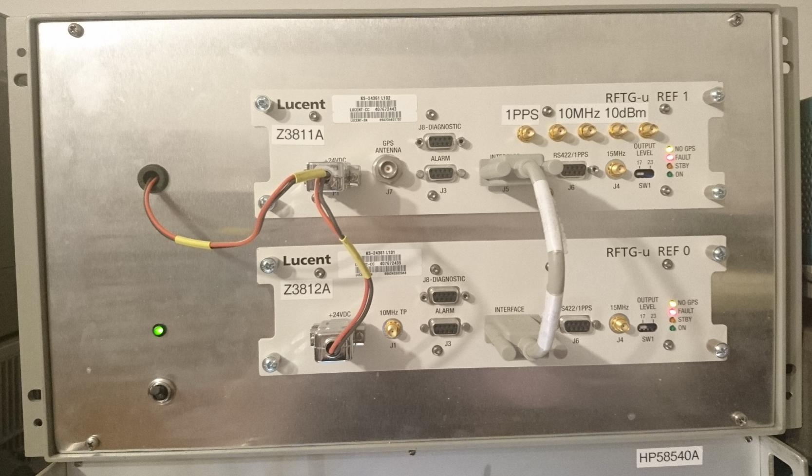

This here is my Lucent pair. The Z3811A is modded for 10 MHz and TTL 1PPS out.
The modification is described here:
< http://www.hoffmann-hochfrequenz.de/downloads/DoubDist.pdf >
I have also bought quite a lot of GPS-less Z3812A for their MTI-260 ovens
when the offer was right on ebay. They have been built by Agilent for Lucent
and stocked as spare parts. I had not much luck with crystal ovens from China,
these came as originally shrink-wrapped from FLA.
I'd like to phaselock 16 of them very slowly and then powercombine them
for averaging phase noise. BVAs are no longer available, so there is
some need for a replacement.
I have made a carrier board for that purpose that can house an MTI-260,
10811A or MV-89.
The 10811A would be the one from my 5370A, which is just an array of
intermittent contacts. Hopeless. Bought the SR620 instead.
< dsc_472 | Gerhard Hoffmann | Flickr >
< dsc_0471 | OCXO carrier board. Hosts an MTI-260, Morion MV89… | Flickr >
Gerhard

Hi Gerhard,
Many thanks for the links. That Lucent is the exact thing I have. Looks like I will be modifying it at some point in time.
I have the same ovens in mine. They seem to be okay. I also have an HP 10811A that I can use as a stand alone oscillator for sanity checks. The E1938A is a newer oscillator. I have a pair, one has a dead oven that I'll try to fix.
