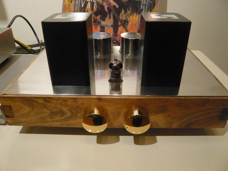

I have built a opt-coupled linestage and I agree. With termination resistors across the secondary of the OPT the sound gets less "punchy" and a bit more "dull". Why?
