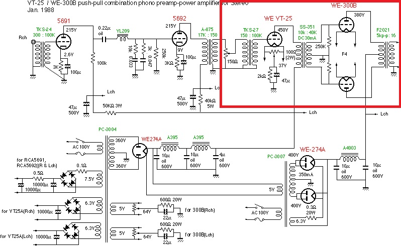

After studying Sakuma-san website, I decide to go after the attached schematics (only the part in red box) given that it's the most simple one I can find, and that my phono stage's output transformers have 150R output and I also have 150:100Kpp input transformers. The problems here are:
1. the 100R volume control. I couldn't find one.
2. 450V B+ for VT-25, can it be lower?
Please kindly advise me if the direction is ok to go.
BTW, I find that Sakuma-san often uses 150:100K input transformers with 300B or other power tubes. Would it limit the bandwidth?

Hi!
When you want to drive 150 Ohm, ideally your source would have much lower impedance. Something like 5 times lower, at least 3 times lower. All depends on the output circuit of your source of course. The 100 Ohm pot would be in parallel to the capacitance and inductance of the step up transformer, so yet a lower impedance.
It is all a matter of what you want to achieve. If you want a high resolution amp, neutral, with good bandwidth, this is not the approach to follow. These high step up ratios are a huge compromise. Sakuma is after tone. I never heard his amps. A friend of mine visited his restaurant once. He described the sound as very good AM radio.
Sorry if this sounds discouraging, but I think this is not the right project to start with. Try a simpler one first and then work your way into transformer coupling. I like Sakumas designs and I adapted many of his techniques, but at the same time try to achieve high resolution and decent bandwidth.
Best regards
Thomas

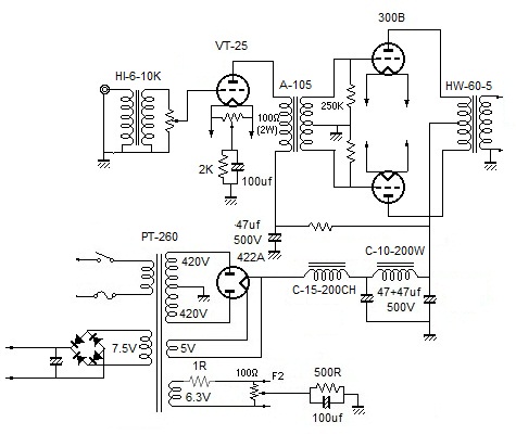

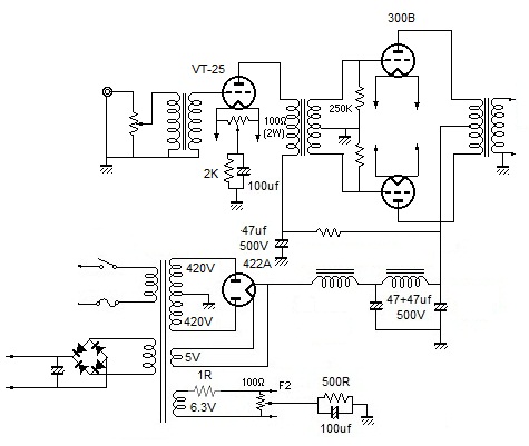

VT25 - 300B amp
The schematics would look like this. Can you please kindly advise me the optimum B+ levels for VT-25 and 300B tubes?
As the input transformers are Hashimoto HI-6-10K (600:10K) transformers is it ok to use 100K volume control?
Andersen, "optimum" levels depend on design (class A; class AB a.s.o.).
You come up with rather ambitious designs, and in IMO these are for the more experienced.
I advice to begin with a known design of which all parameters are given, so the chance of success is there (and you learn in the meantime).
No, 100k volume controls do not mate very well with a low input impedance that you have with a 1:4 step up input transformer.

Hi Andy,
I have to agree to Pieter and I would also again encourage you to start with a simpler project or with a schematic which is proven. This would help you a lot to learn and then as a second attempt build an all DHT amp. There is more to good amp design than just selecting a B+ or arbitrarily choosing a volume pot.
BTW a resistive volume pot would destroy some of the advantages of such a transformercoupled amp IMHO. This just begs for a preamp with TVC.
In my experience, the filament supply of a 10Y is critical. I had poor results with such filament supplies as drawn in that schematic.
You might want to check my blog for some insight into amp design. Check the single ended amplifier concept series of articles which might give some direction and go from there. Here is the first part of these articles:
VinylSavor: Single Ended Amplifier Concept, Part 1
Also read tube datasheets, look at the plate curves and put in your loadline and op point there to understand how it will work.
