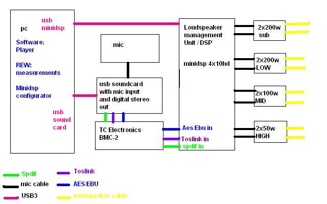

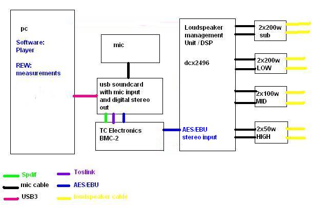

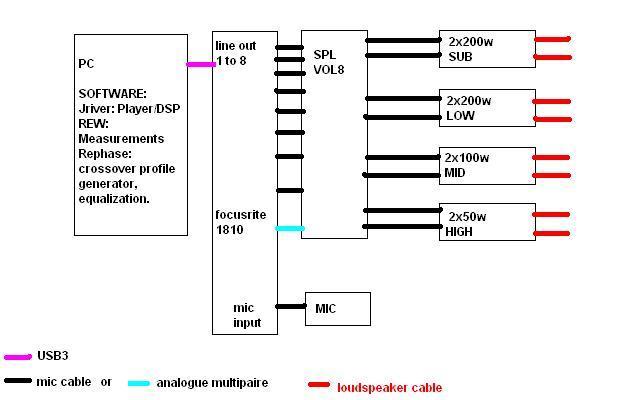

About dsp here are three typical example of config for a multiamp/dsp approach. They include everything needed except mains supply connector.
It should help to evaluate costs to engage if it is high on your design criteria.
Those are stereo config only (for a 4 way).
