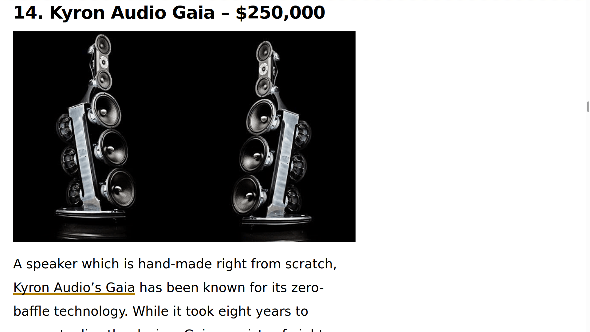

This is an example of how you can build the same for less... The top and 3rd speaker down are the same Scanspeak Illuminator 18WU's I use. The tweeter second down is also Scanspeak and costs around the $500 mark. There is a lot of electronics in that price as they are active open baffle, but that is a lot of built in profit. From memory all the lower drivers we AE.
