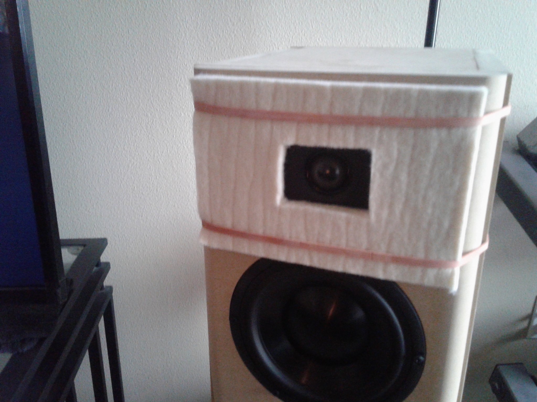

Baffle diffraction induced FR irregularities can in theory be EQed out of a speaker's FR, but the audible effects and sound signature can't be.
How can we EQ out baffle diffraction (other than on a single axis)? From what I've seen it creates an uneven response on or off axis. EQ one and the other will get worse. Once you remove the diffraction ripple (for instance with a smooth shaped baffle or proper mouth termination on a horn) the on and off axis curves will start to track each other (look similar/the same shape). To me this means one cannot EQ baffle diffraction and one should deal with it in another way. I guess that was the reason this thread was started. EQ-ing away ripple induced by diffraction would work in 2D only. At a single point in space. Not very useful.
I'm not convinced added horizontal reflections (through minimal in room sound absorption) are a desirable way to enhance the L/R stereo image. Even if you're OK with an artificial sounding image, it will impact the speaker's CSD in a bad way, even moreso when playing music louder, which just extends the in room energy decay time and further smears intelligibility of individual instruments and vocals with increasing playback levels. This also applies to HF drivers radiating rearwards. Unless you prefer an artificially diffuse and vague spatial image, it won't recreate accurate sounding width or depth missing from the recording.
To me, the above depends on timing. In a large enough room the reflections (now arriving later) may not be that harmful and even pleasing. Take an open baffle speaker, where the nulls avoid early side wall reflections, but that back wave is going to come back. It there is a proper time difference, it can sound very pleasing. Believe it or not, it can actually enhance the front stage if the timing is right. Due to the larger distance that reflection has travelled, it's SPL level will be lower too and it will be largely decorrelated from the direct sound if it reflects off of distant walls and furniture (making it more diffuse). Same goes for that HF driver firing backwards, timing (and level) will dictate how pleasing the end result will or can be. A room void of reflections will show the flaws of Stereo. Ideally we'd have some level of reflections (timed right) to enhance the Stereo illusion.
We almost always have reflections though, even in a reasonably large room it will be tough to avoid the vertical reflections anyway.
If the room is treated properly and speakers are able to hold even horizontal and (relatively narrow) vertical directivity well into the lower midrange, you will end up with a great sounding system that can play all sorts of music with equal satisfaction. This of course means in room FR is linear, THD and IMD are low enough and sufficient SPL headroom is available.
Have you guys seen how tight the vertical pattern needs to be to really avoid floor and ceiling reflections? And do we even want to avoid all of them? Some level of reflections is quite welcome and we will still be able to listen "trough" it easily with our brain trained to do so. I take it when someone talks to you in a room you can still follow what he/she said... There's bound to be reflections during that conversation.
Take away all the reflections and a lot of things change. Stereo cross talk will become much more obvious (*), you'd hear the balance change with little head movements because the nulls caused by cross talk (right speaker heard by left ear and vice versa) will shift. Slightly off axis the balance might even be better, as in the exact sweet spot both ears have these dips at exactly the same spots while off axis each ear gets them at slightly different places. Luckily reflection present in a normal room hide these anomalies. There are bound to be reflections with most type of speakers in a normal room. Even with horns we'd still have floor and ceiling reflections, though at lower levels than with most direct radiators.

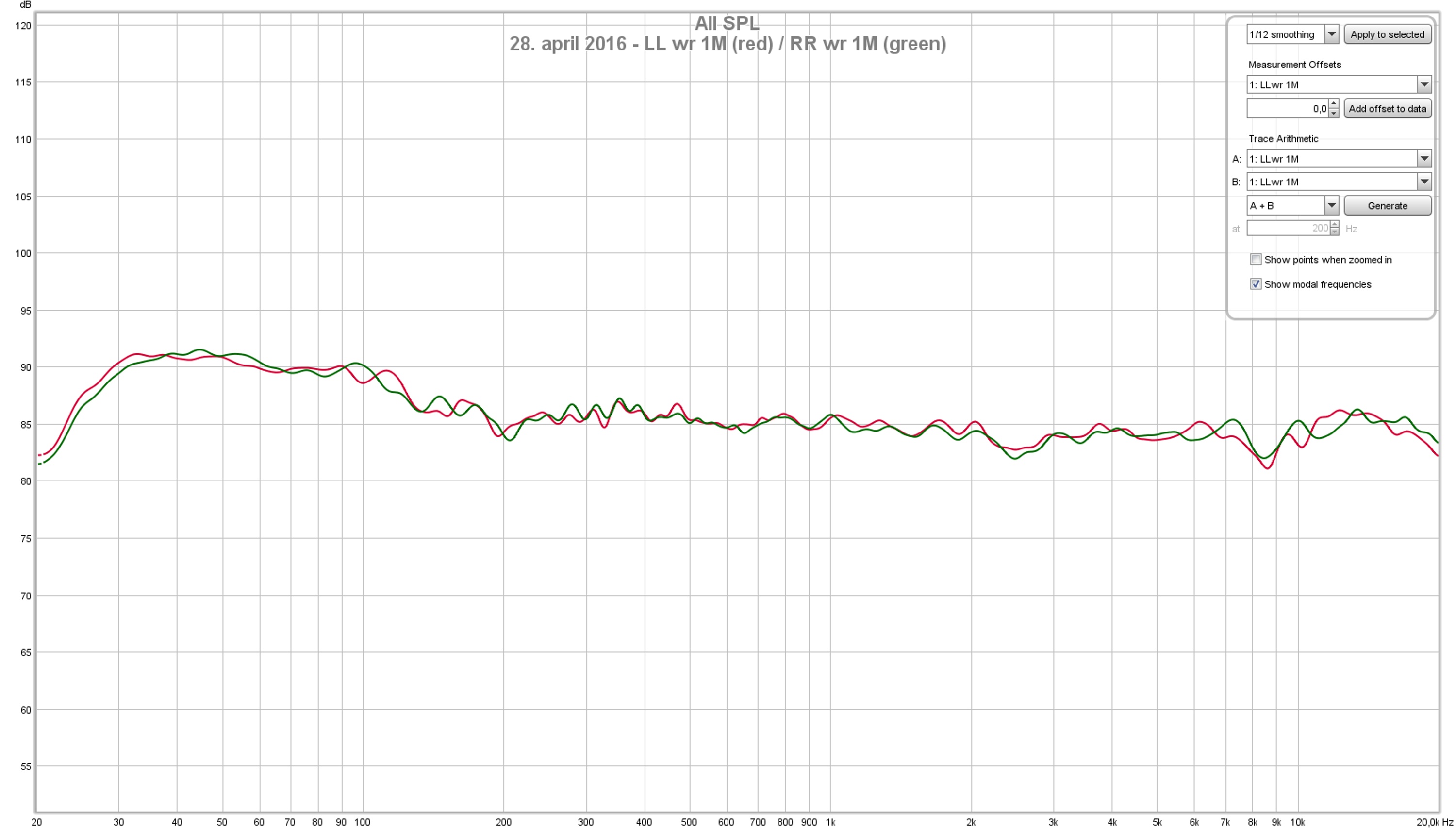

A measurement at the ear position in a very well treated room (not my room, think above studio grade room treatment):
In the exact sweet spot, you'd be getting something close to this curve at both ears, if the room is void of reflections. The green trace is without reflections, the other two colors show a Hass Kicker (orange) and Haas Kicker with ambient channels (red). Original link.
This room is painstakingly engineered to remove all direct reflections, including floor and ceiling. It doesn't even look like a normal room. It was build for one purpose only: as listening room. Here's a link with a description of that room, with a bit of luck there's still some links to the measurements he made inside that room at the listening position. I had never seen anything like it (except semi anechoic measurements but never at the listening spot).
The FR of one channel measured at a time, both channels shown:
So be careful what you wish for... you might be surprised what happens if you do get it...
