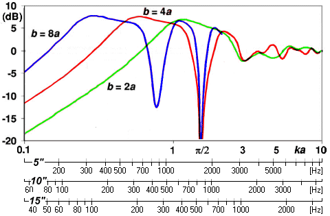

There are a number of studies for the lowest diffraction enclosures (ie. Olsen, Modern Sound Reproduction) often reprinted in other books.

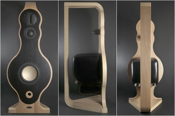

Lowest diffraction is the sphere, followed by tapered back compound front like the speaker (Avalon Acoustic) in post#1. Even the tall narrow box is not too bad.

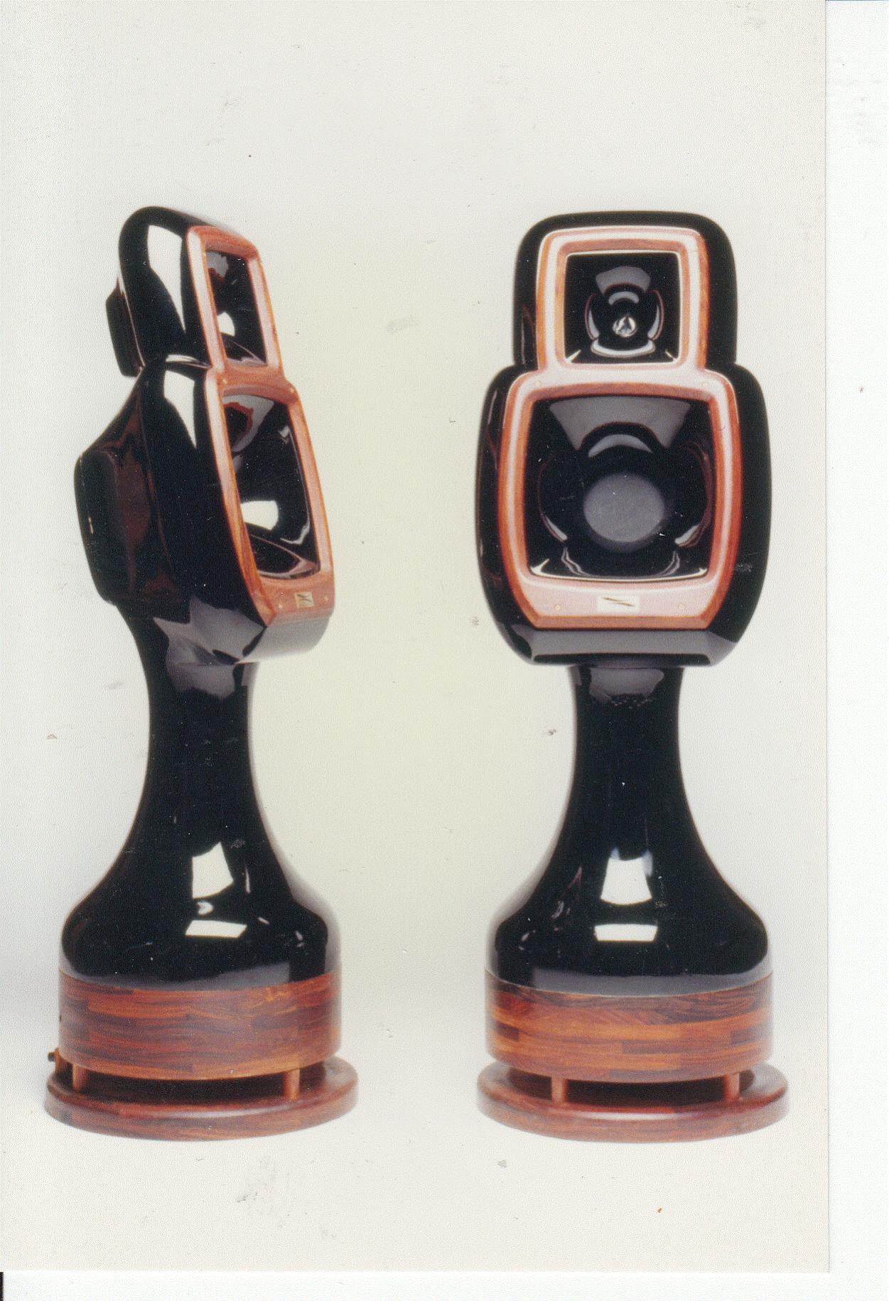

Olson did not test every shape. B&W has taken his studies further and the ideal shape is more like the teradrop they use in the Nautilus or that Eclipse uses for their FRs. Also backed up by studies on the shape of cars & bike helmets as further examples.

I think the wide baffle is not just about diffraction but about dispersion control. A good combination. 🙂

And about baffle diffractions - the best way to avoid them is tu use a dipole or cardioid system below it's dipole peak range! Then we don't encounter edge diffractions until we reach say 6kHz with a minimal baffle width! This means usually a 4-way construction like Linkwitz's LX521 or Kreskowsky's NaO Note II! My attempt in this genre is in my signature AINOgradient

That is the thing - a good baffle design that not only minimize diffraction but looks good too. There are some good designs on this thread but either they are not easy on the eyes or too difficult to make for DIY. As for the Stradivari, it may eliminate some of the diffraction issues, but introduces other problems. I don't think the wide baffle images very well. I actually have the Stradivari clone and especially at low frequencies, there are some phasy things that shifts the image around. Maybe it's my room but a pair of good monitors don't have this problem on the same setup.
