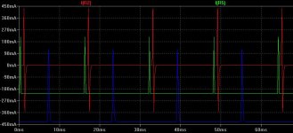

Then, I better ask.
What about the relation between the bandwidth, the crossover point and the impulse response?
Is it advisable to go for a higher crossover and thus for a driver that has bigger bandwidth based on all of the above considerations? Regardless of the rule of thumb, that it should be crossed over two octaves below it's upper limit or below it's cone breakup frequency. The last is applicable for second order, for higher or lower order it is less and more respectively.
Does the impulse response benefit from broader bandwidth of the bass driver?
What initiated the whole thinking is that the highpass crossover never shows even a close approximation of what is at the input.
See attached simulation.
tRise-0.0002ms, tFall-0.0002ms, tOn-0.0001ms; Total lenght is 0.0005 ms (approx. half of 1000hz impulse); Crossover is first order Butterworth at 1250 hz, 1.02mh, 15.9mf;
Green - input signal;
Blue - LF 8 ohm resistive load;
Red - HF 8 ohm resistive load.
And what bothers me is the shape of the HF signal.
Thanks in advance and sorry if the question is completely wrong. I apologize for the above conclusions.

Then, I better ask.
