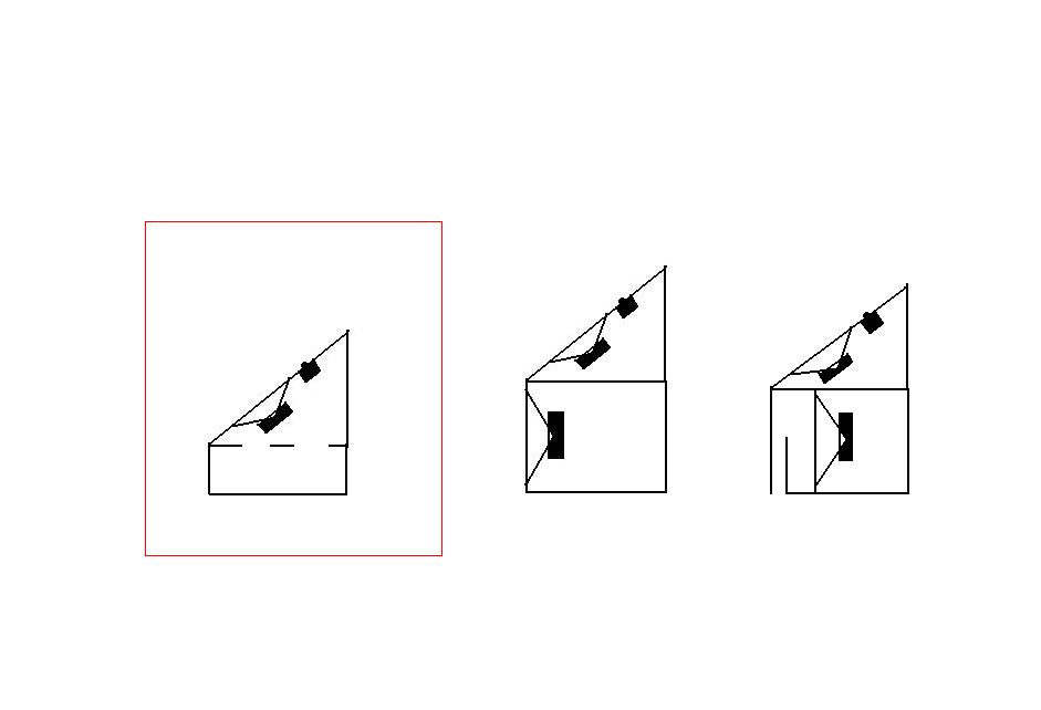

Below is what I think might be a nice design
Looks like I have no idea about speakers
But there is more to it than that
Its based on experiences I have just now
I sold my speakers and had to throw something together
Which I did within a day
Gave me this idea, which may remind somewhat of a Carlson
I believe it has potential
