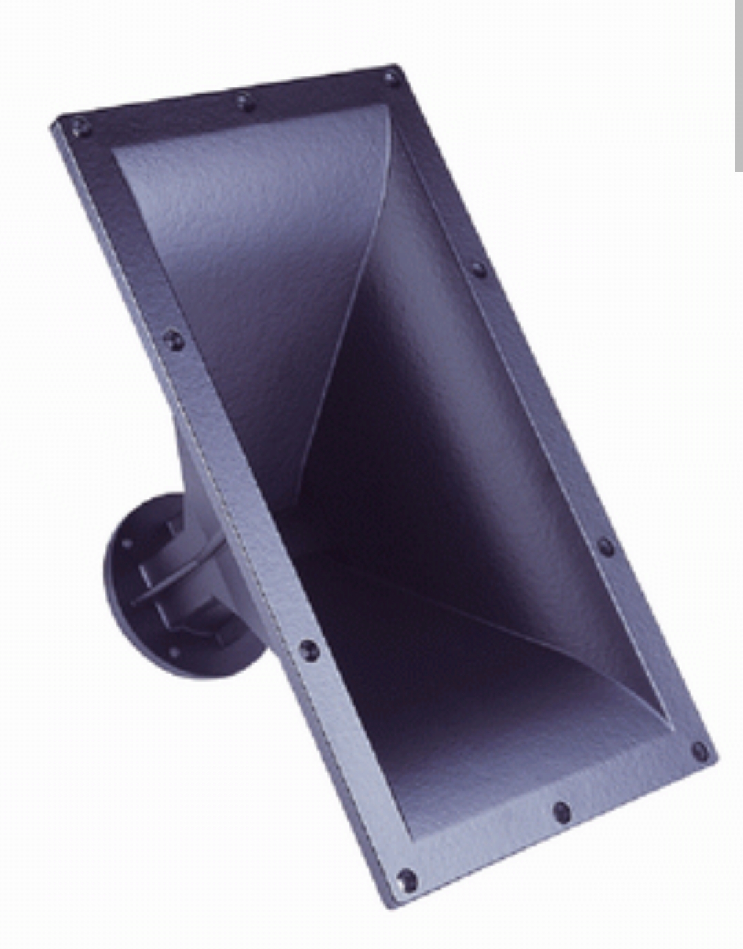

The horn is a P.audio 4525 90 x 40, 2" throat...AKA the Goldwood PB450 on your side of the pond. This was chosen as it is the only horn that performs like a CD horn but has the "dual" throat, a combination of slot and circular entrance.

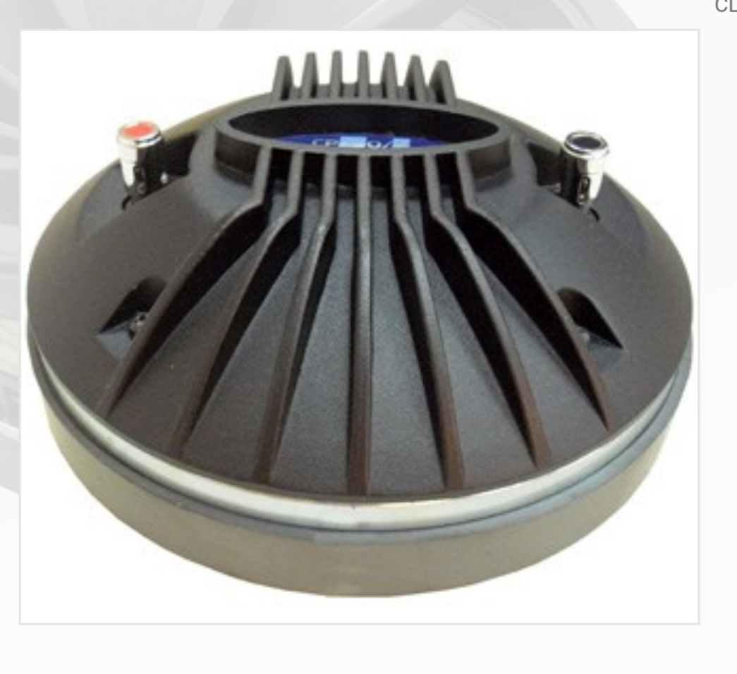

The driver comes from a company I hold in very high regard having worked with many of their superb drivers..Beyma from Spain. The CP750ti is a well built 2" throat 75mm titanium diaphragm device with mylar suspension providing it with extension, damping and a design goal of theirs, an extended HF.

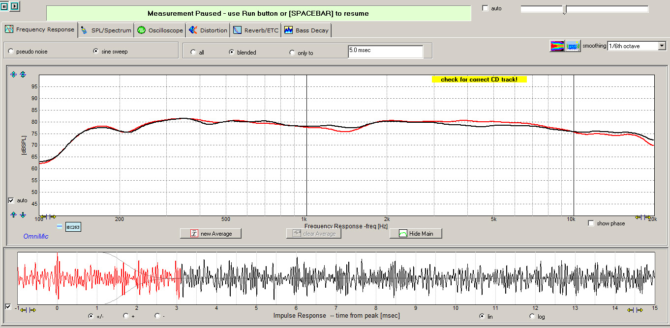

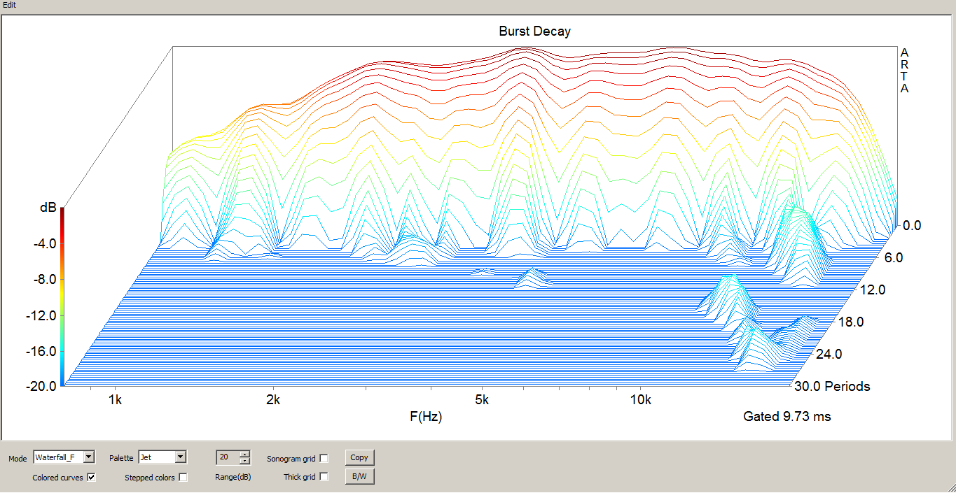

So there you have it, the plots don't lie. Consistent even coverage over a wide angle, low distortion, flat response and lack of resonances. And guess what, they sound great...well, they almost don't sound at all as colourations are reduced to a minimum....

Digital filtering?? You can of course use passive, analogue or digital to crossover . The plots are without eq. But you'll have to trust them because 1) I'm in the UK 2) they're in my home system,
I can supply boards and the component details, but not for free of course. The circuits might become a product but I wanted to test the water. Frankly as it appears most aren't interested, I suspect it will remain a one off for "my listening pleasure" 🙂

Re: distortion. At 100dB at the mouth, the 2nd harmonic is 1.5%. As we know 2nd is only audible as added warmth...and this is total system distortion including valve equipment in circuit.. As is the .08% odd harmonic. At normal listening levels, Inaudible.
Is the Kef horn based...I doubt it. in which case it is scarcely relevant? The point of the horn is even power delivery...look again at the on and off axis plot. No tweeter can manage this and is probably at least 10dB less efficient. Ribbons might get close in horizontal but beam in the vertical axis?
Look again at the impedance and phase plot...no commercially available product can claim these results making a passive network a doddle.
No csd/bd display tells the whole story and are not simple to interpret...all tweeters, including cd drivers break up above a certain frequency...some disturbance above 10kh in this case. ...you can eliminate this problem with a super tweeter (the visaton tl16 is clean to 30kh...but you've added another source and another time alignment problem...I stated "perfection" is an impossible goal in audio and just comparing a speaker that bears no resemblance to a horn design seems irrelevant...interestingly the sealed 10" mid (160-800) when measured "in circuit" revealed results matching the horn in terms of cs/bd....I'll dig it out and post it!

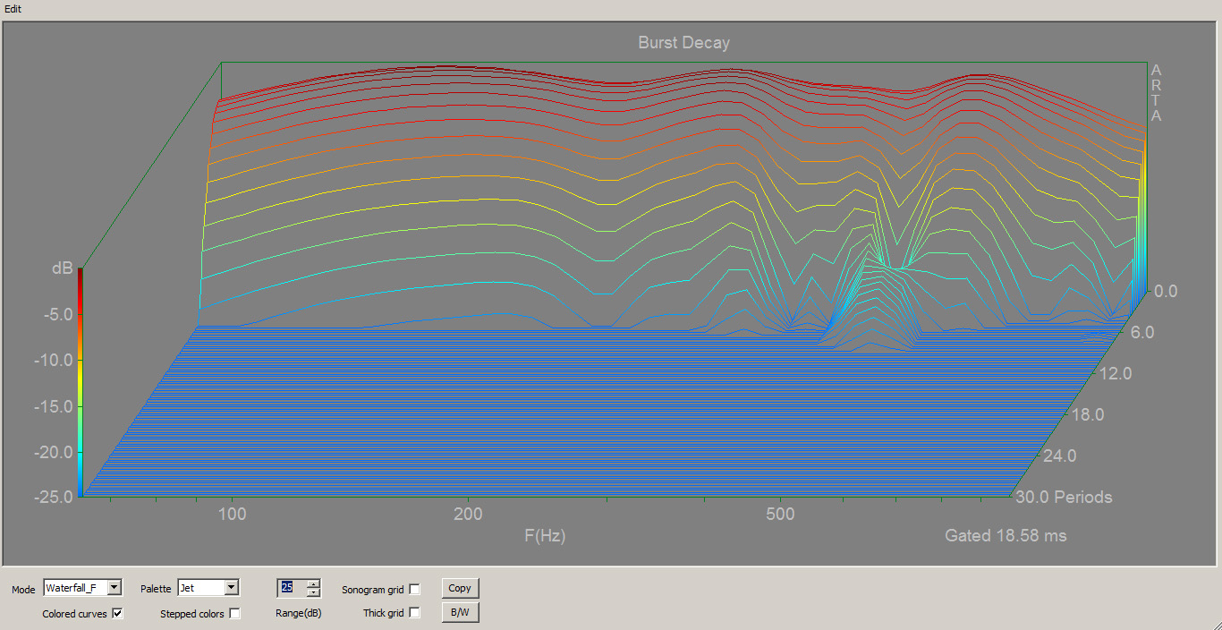

And here they are, Mid + Horn, 0 and 30 deg and Bass and Mid burst decay. As with the horn on its own, the decay is very similar for much of the bandwidth of interest at 6 periods..

Looks pretty good to me. What you are looking for is equal spacing of the lines as the signal decays (why having periods as an axis instead of time makes that view possible).
The Z axis of this chart is only 20dB — it would be interesting to know what is happening "under the water”. A bit of ringing at about 4kHz, a little island (mountain peak) about 500Hz higher, i believe the ridges at 10, 15kHz, and the series of islands between 15-20kHz are diffraction effects given they angle off.
We see few proper CSD with periods (ie Burst Decay), but few of those i have seen are as good as this.

Planet10, Thanks for comments and observations. Not going to get embroiled in the bass/mid plots...but these are Beyma drivers...15" & 10". Both sealed..bit of Linkwitz Transform on the bass. They are my design, but not here for that!
Amps?!! Absolutely nothing special..could have been either the little Samson 120a...or an Inter M plus. I have loads of them...🙂 Probably more relevant is the rest...cd used as transport into rme dac..which feeds 2 x Klark Teknik "Pultec" clones, (almost). Output to balanced class A pre (YES!! Its Chinese !!)..to TL Audio 5013 parametric to Rane 23 active X-over to amps. EQ flat for horn plots. This whole signal chain is in the distortion plots...
Must admit the 500Hz anomaly interested me as it is in the cone midrange bandwidth. The cabinet is sealed and asymmetric..I suspect the driver itself as there is a peak recorded at this frequency on the manufacturers spec sheet....
