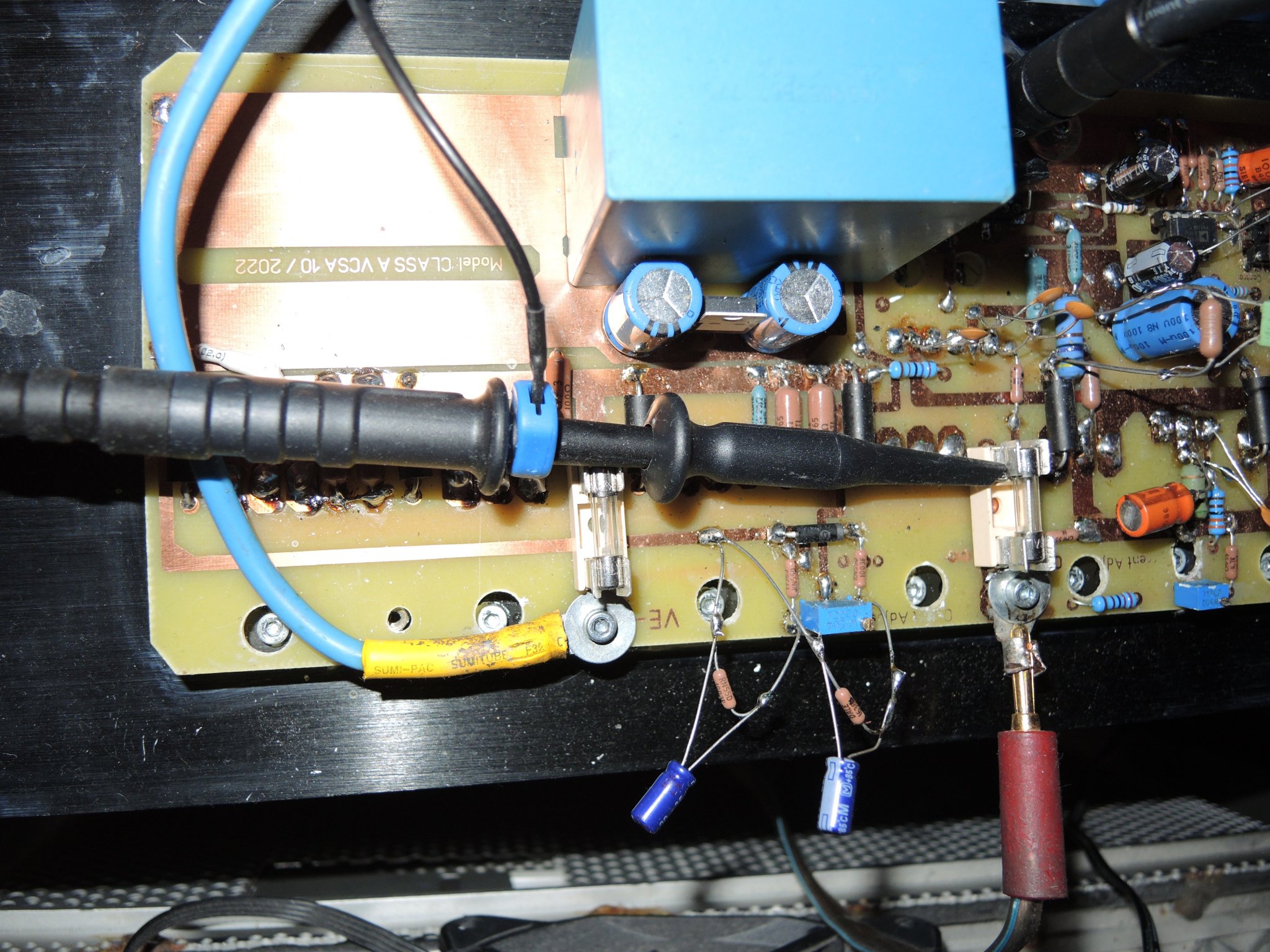

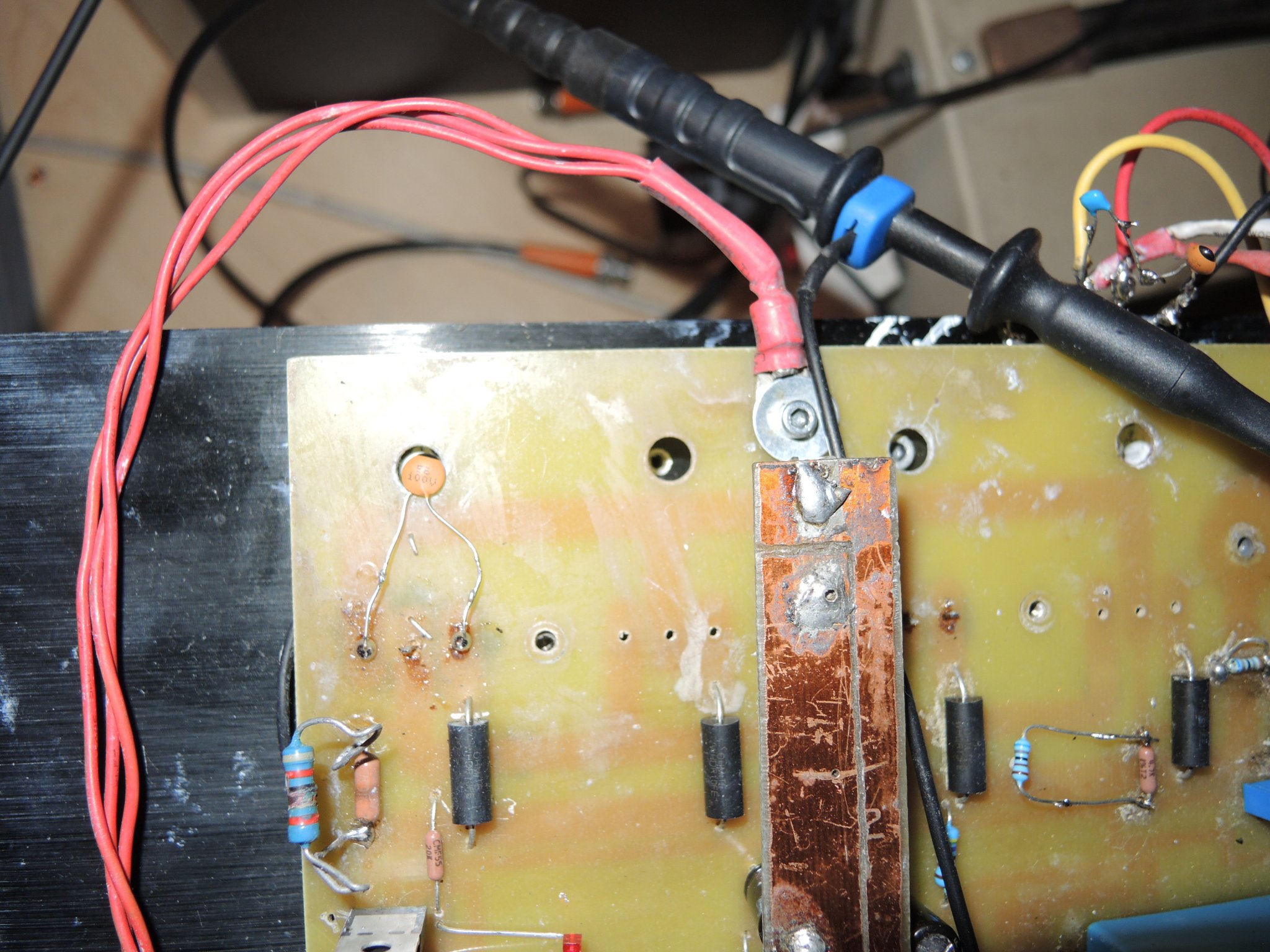

Fuse 2.5 amps Rail + 35 Volts from Power Supply is in Serie instead of the Fuse.
