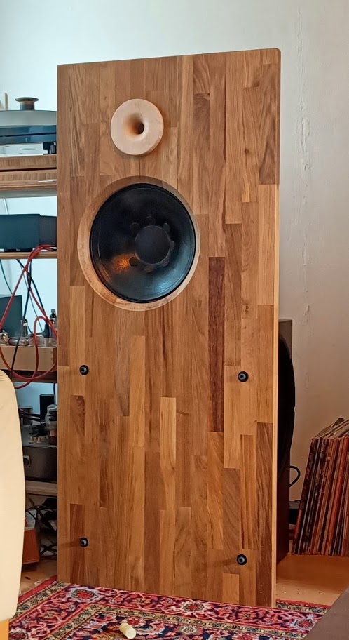

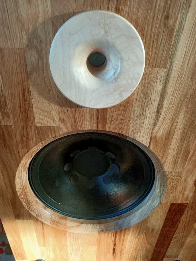

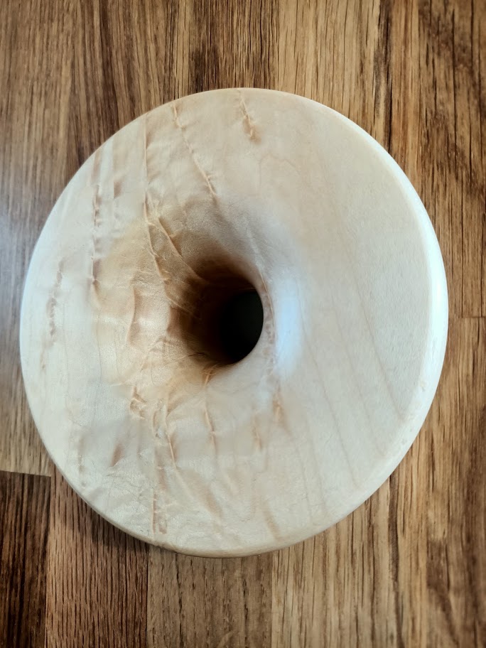

Hi Erik,
They are to augment my open baffle Bastanis. (I have active sub 15" closed box) But I want to add the 18 inch dipole subs as Bastanis offers already. I just don't have the moolah to get the "official" units.
The current subs are set to a low pass 90Hz. So these will be similar.
