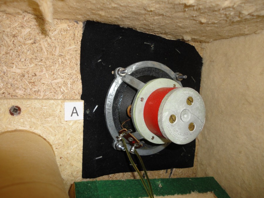

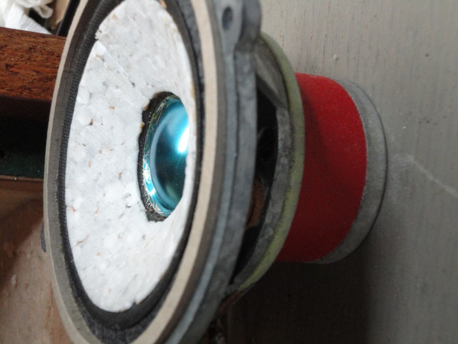

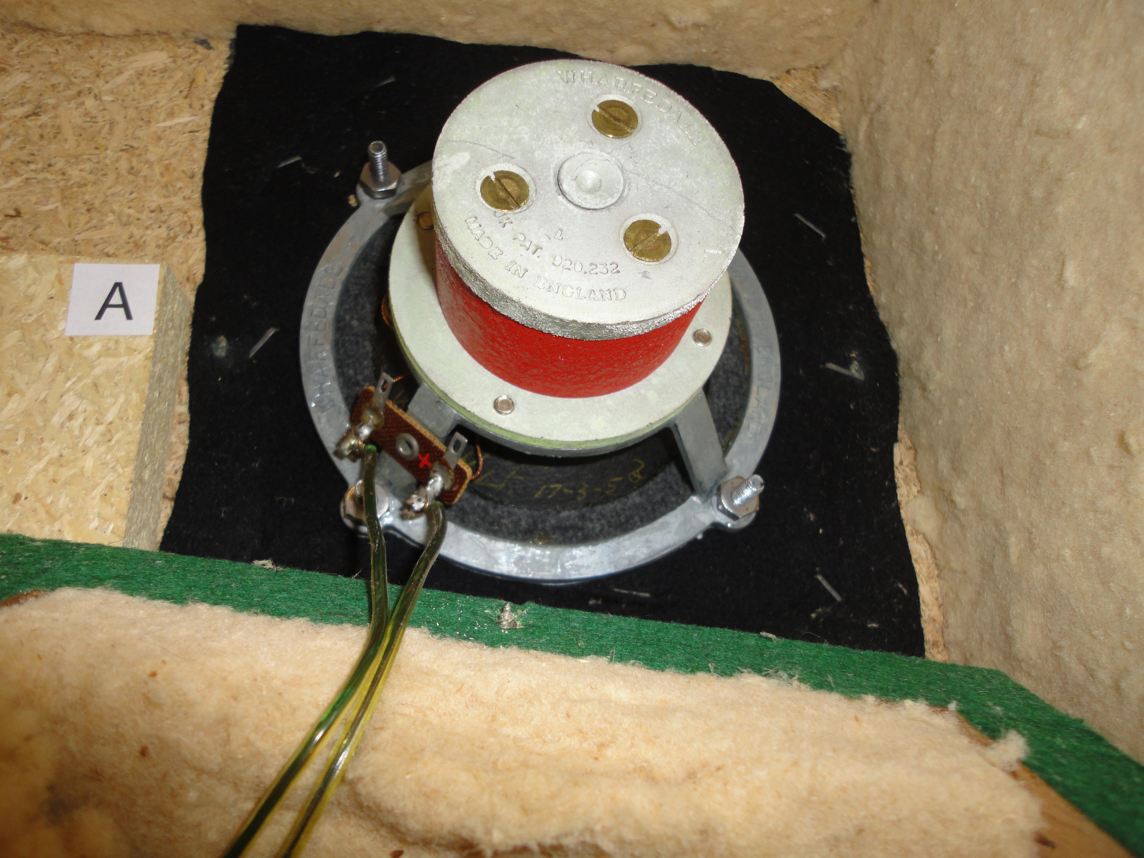

The tweeters in my early W60s look like this picture. They are referred to in the period catalogs as PST4 (a thin layer of polystyrene is glued to the face of the cone), and are approx 4.5 inches dia.
They are not the "Super 3"s posted above. Those were installed in W70s, W90s, and a few earlier UK models.
