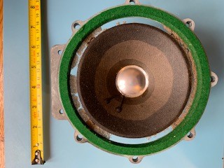

I'm currently looking to repair a pair of 5" drivers from a set of Wharfedale W2 Speakers. The voice coils are both open circuit.
The literature says that they are Super 5 drivrs but the ones I have do not look like the ones listed in the Wharfedale leaflet. I have atteched a picture and I was wondering if anyone has any experience of these unit.
Any information would be appreciated.

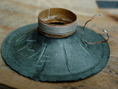

Sounds like you have nothing to lose by carefully removing the cone and voice coil assembly as shown in the image to allow a proper examination.
Here, the aluminium voice coil wire attaches to the flexible braided copper wire at the cone. At that junction may lie the problem.
Note that this shows the voice coil from a Super 3 on a replacement cone.

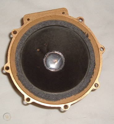

I have something similar on my shelf. Could you take a picture of the front?
dave
This is the front of the speaker showing the rotted surround.
I removed the voice coil and checked properly and there is no continuity in the wire at all, so it looks like they will need to be replaced.

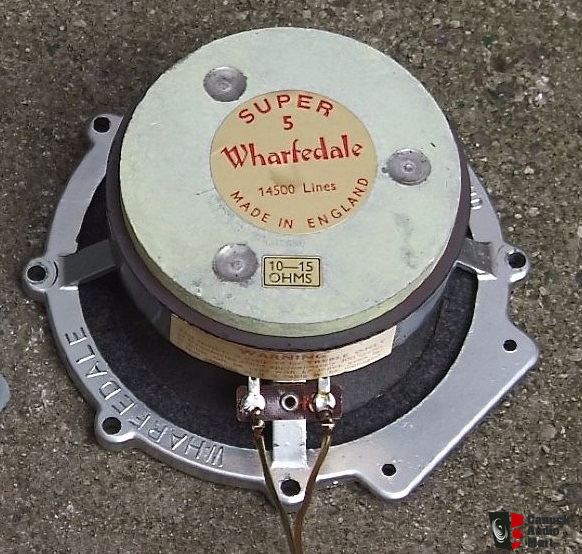

The Super 3 model is regarded as one of the best cone tweeters ever made, and the Super 5 is not far behind. The Super 5 could be comfortably crossed over at 1,000Hz using just a 1st order crossover (as in the W2), while a pair could be crossed over as low as 400Hz (as in the W4).What makes these drivers so special?
Not ever having owned a pair I'd like to know
Both the Super 3 and the Super 5 have an very high flux magnet system (flux density 14,500 oersteds; total flux 60,000 maxwells). I presume this gives clinical control of the movement of their aluminium voice coils. A Super 5 weighs in at 3.25lb (1.5kg).
The flux density is identical to that of the following larger drivers in the Wharfedale range (circa 1963): Super 8/FS, Super 8/RS/DD and Golden 10/RS/DD (FS = Foam Surround, RS = Roll Surround and DD = Double Diaphragm).
However, I suppose there's a lot of nostalgia involved - nostalgia for the days when Wharfedale drivers were over-engineered and before cost-cutting became more the norm.
