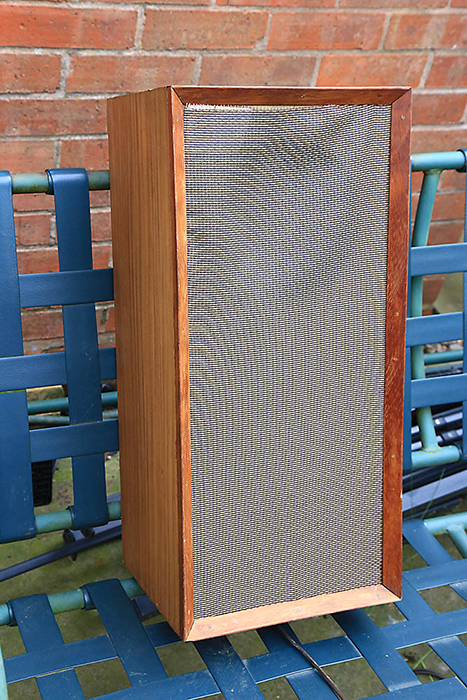

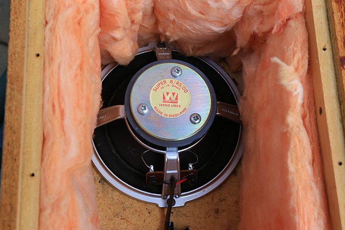

Thanks for the info these are the speakers with the cabinets.
Sorry I have been having problems downloading images via Safari

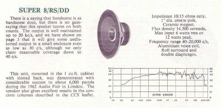

Ahh! That looks like it might be the "1 cu.ft. cabinet with slotted back" mentioned in the referenced catalogue. (here's a snip🙂

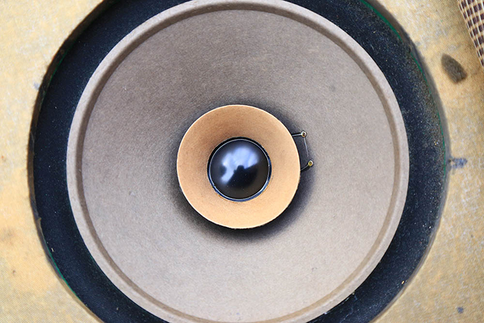

CCS = Cabinet Construction Sheet (available from Wharfedale). Unfortunately, I don't have a copy of that. So, it appears that your cabinets may have been DIY constructed following a Wharfedale published design. That's not to say you couldn't come up with a better-performing cabinet design, but if they sound good, why not just enjoy them as they are for a while? There may be some merit in replacing the foam strip behind the whizzer cone - that's said to help tame some of the higher-frequency response peaks. (It appears from your picture that said foam has disintegrated, as it is prone to do.)

Ok, so - that tiny strip of foam would likely not do much by way of absorption; rather - I think it's function is (primarily) that of damping the free edge of the whizzer cone against breakup vibrations. Hence, I would avoid low-density open-cell foam; instead choosing a medium-density foam that rebounds slowly when compressed and then released. I would try something like "memory foam" or weatherstripping tape. The latter with a pressure-sensitive adhesive backing film might work well, although it might prove difficult to remove without damage to the paper cone in the event you are unhappy with the results. I seem to recall from grade-school art class that rubber cement - if applied to only one surface and left to tack up for a moment - would allow fairly clean removal from paper; perhaps you could experiment with something like that before committing to a more permanent adhesive. (But please DON'T blindly rely on my own failing memory, though! :scratch2: )

For the Wharfedale 8 RS DD and the 10 RS DD model; the foam used for the damping ring on the HF cone is made from a soft 1/4'' thick plastic foam with small pores. It was cut out from a sheet of foam as an annulus ,I.D. = 2.75'';O.D.= 3.5''. A section ,approx. a quarter of the circumference was removed to allow it to be fitted to the edge of the tweeter cone. A latex adhesive should be used to attach it and it must be tensioned in such a way as to to provide a small amount of compression to the cone edge.
