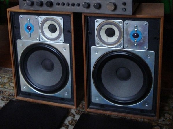

Wharfedale Linton 3XP Recap
See these Glendale xp2 on Google
Another variation that has improved stereo imaging and look squeezed into the box's
Another rare version

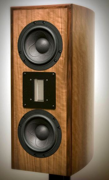

What is great about this sort of thing? Mainly that the dispersion is exactly symettrical. We can help it out by separating out the bass displacement. Because bass extension tends to drive a driver out of its comfort zone into distortion. So apply sub-woofers.

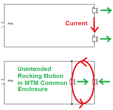

If you are interested in the theory of mutually interacting components, and IMO, only magnetic coils aligned on the same axis qualify at audio frequencies because I have measured this effect, along with twin bass drivers in a common enclosure.
What I find interesting is series wired bass units in an MTM common enclosure (or box) behave entirely differently from parallel wired. I go for series wired. 😎

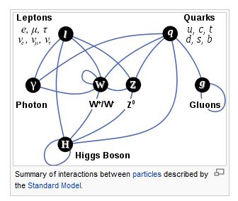

TBH, I find the Higgs Boson way more interesting than loudspeakers. Just me...

I still think this sort of thing has a lot going for it:
532765d1456057805-classic-monitor-designs-mtm-scanspeak-raal-ribbon-selah-audio-jpg
Such magnificent symmetry. 😎
Thanks everyone for the help. Managed to find a 4uf for the tweeters and also discovered the Glendale's also use a 16uf for the mid. Just finished them and very happy with the sound . the bass is much more controlled sounding , vocals clearer and the ribbon tweeters have come back to life!
Thanks again everyone for the help ! Learnt a lot in the process.
