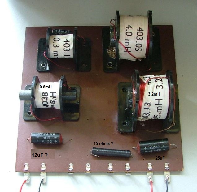

How it works is two 2uF capacitors wired in series amount to 4uF. Two 8uF capacitors wired in parallel amount to 4uF. It's not exactly the same thing with drivers, but that is subtle stuff and depends on separate or common enclosures. I reserve my secrets... 😎

Sorry but that is just wrong. Two 8uF capacitors wired in parallel amount to 16uF, two 2uF capacitors wired in series amount to 1uF.
I know that it was 1st April, but that would confuse some people and could end up inadvertently frying a driver...
Maybe you were thinking of inductors?

TBH, I can't believe I got that so wrong...
As a rather pathetic excuse I can only say I was mixing Impedance with Conductance. Inverses. And the laws of combination flip accordingly. 😱

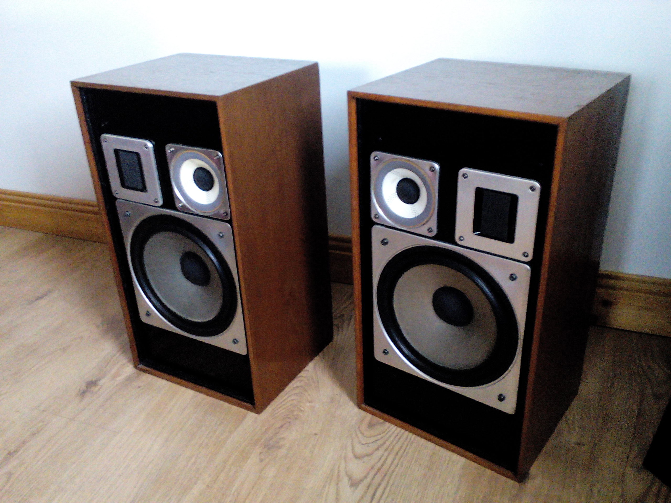

Thanks everyone for the help. Managed to find a 4uf for the tweeters and also discovered the Glendale's also use a 16uf for the mid. Just finished them and very happy with the sound . the bass is much more controlled sounding , vocals clearer and the ribbon tweeters have come back to life!
Thanks again everyone for the help ! Learnt a lot in the process.
Those old inductors with the thin (~8mm diameter) ferrite cores are horrible. I've tested a few from 1980s era speakers and they all have terribly low saturation current. If you rip out the core they can drop to 1/5th the inductance or worse - such a high permeability core is a cost cutting measure to save on copper wire. If you're going to the trouble to recap it might be worth changing those for an air core with beefier wire (to maintain the same DC resistance), or a modern steel laminate with a much beefier core e.g. ERSE I-core.
