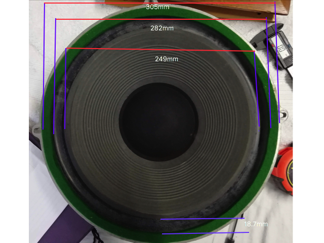

My Dovedale model 3014 bass drivers showed substantial resistance to having their cones depressed by hand. The Flexiprene surrounds, however, were soft and showed no signs of deterioration. I believe a high degree of resistance is normal for these drivers. As confimation, my drivers reproduced deep bass effortlessly.
Galu i gave them a good check and i can confirm my surrounds are similar to yours. They haven't deteriorated and they still feel soft, one does feel slightly harder but it also looks like its been in cold/humid conditions.
I just connected them both and they still sing and the bass had no issues, i didn't see any cone restrictions or shearing forces that may cause it to crease.
Infact they remind me of car subwoofers, how stiff and built they are.
I could always treat the surrounds with a chemical? Im sure ive read about a substance which treats rubber type surrounds?
I dont mind replacing the surrounds, it seems a ball ache as those drivers are built well.
Perhaps i may be lucky and my surrounds are actually ok?
Treatments for natural rubber (like those used for automobile door seals) are not effective for a synthetic rubber like Flexiprene.I could always treat the surrounds with a chemical? Im sure ive read about a substance which treats rubber type surrounds?
Importantly, I would caution against employing any of the aggressive potions frequently touted on the interweb as they could damage synthetic rubber.
If the speakers are performing well, I would leave well enough alone.
At the most, the mearest wipe with a silicone oil moistened cloth will restore the colour and shine of the surrounds. Do not overdo this or the oil will soak into the paper cone. AG Silicone Oil - Professional Lubricant for Protection and Conservation - 100ml 5901764329459 | eBay
The small cone excursion of the Dovedale woofers is normal and, as long as the Flexiprene surrounds have not gone hard and brittle they will operate as intended.
