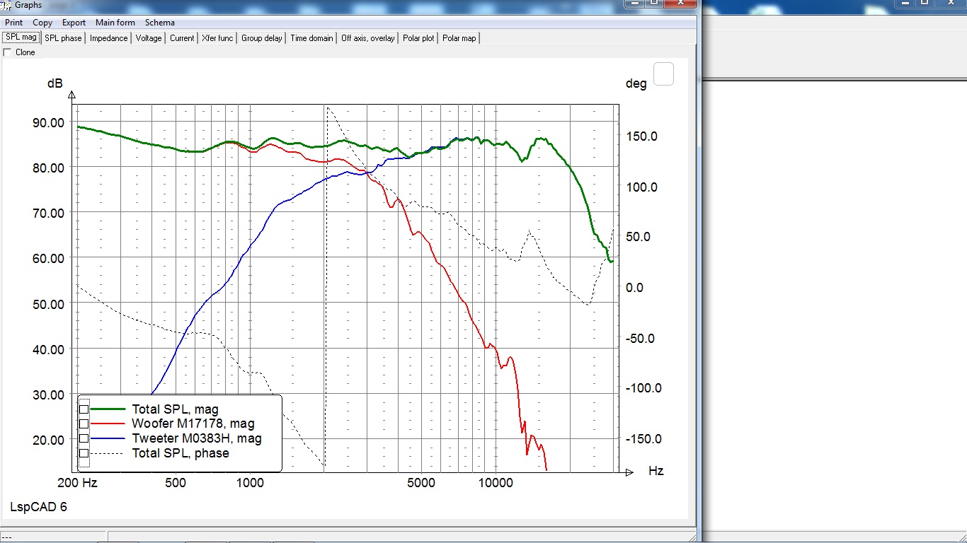

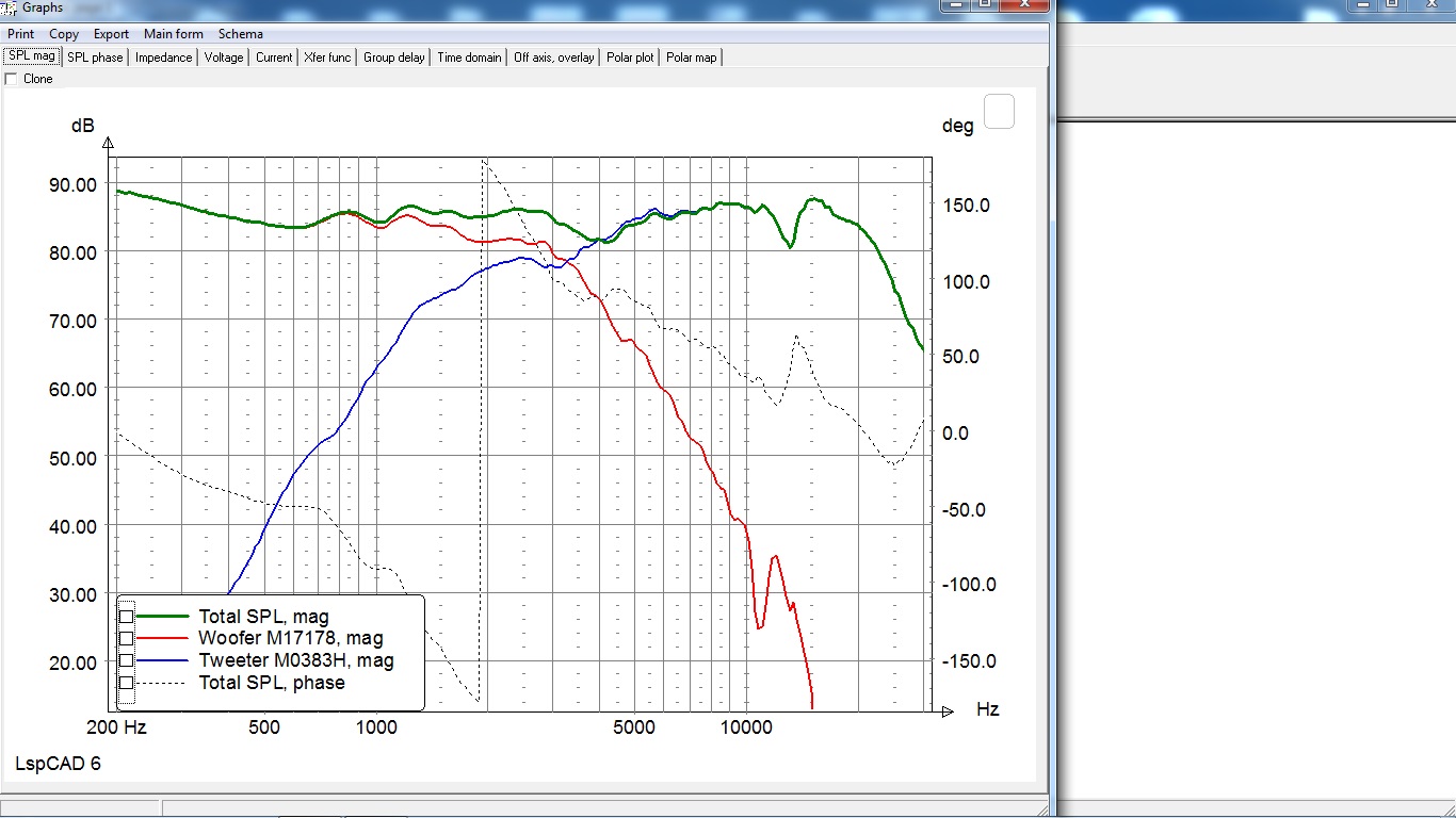

Your measurement doesn’t look that different from mine, but you said you made the measurement at 1m on-axis at tweeter height?
You have truncated the measurement to about 550Hz, but you should be able to truncate it down to somewhere 250-300Hz in that setup, depending on the nearby reflecting surfaces e.g. ceiling, floor and sidewalls.
In your measurement picture everything below 550Hz can be ignored and the scale doesn’t make it so easy to see the frequency plot.
Next time in a similar measurement setup, truncate down to at least 300Hz and change the frequency scale to show 200-30000kHz.
I’ve attached some pictures to show how different scales change the look of the frequency response:
Pic1 - Original x-over on-axis @ 1m with your frequency scale.
Pic2 - Original x-over on-axis @ 1m with my frequency scale
As you can see, the Pic1 looks rather like your measurement besides the truncation, which is 275Hz in my case.
The original x-over design isn’t better than this. The mid-woofer x-over section is fine and it has a smooth roll-off following with an estimated LR4 topology with a target x-over point at about 3kHz. The tweeter on the other hand has a resistor to adjust the tweeter level and an electrical second order filter section that poorly integrates with the mid-woofer and mostly only helps the tweeter not to break when listening to the speaker.
At 1m distance at tweeter height the mid-woofer and tweeter doesn’t sum up well and at the x-over point it’s almost out of phase. The drivers relative acoustical offset is rather large to be compensated for in the x-over, but as you can see in Pic 3 it looks better at a 3m distance and at 15deg off-axis where the frequency response is smoother.
Still it doesn’t have an optimal phase behavior around the x-over frequency. What they should have done was to use a stepped or slanted baffle to adjust the drivers relative acoustical off-set in combination with a steeper tweeter filter.
This would of course make the speaker a lot more expensive to manufacture, hence why it’s not done in this budget speaker.
I think you can try to put the speaker upside down and have the mid-woofer at ear height. This would possibly smooth out the 15deg off-axis response even further. It’s worth a try….

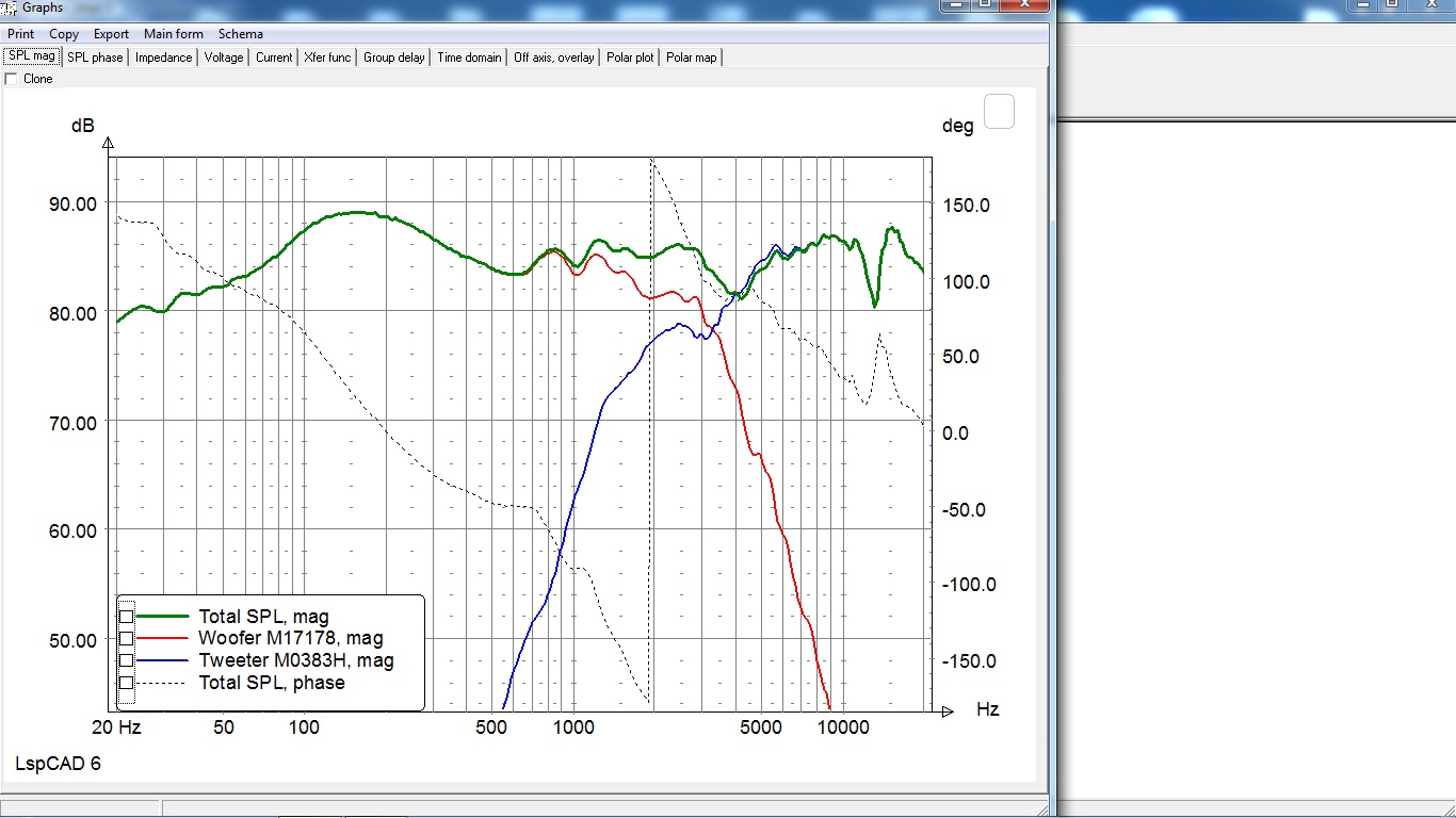

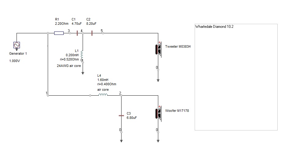

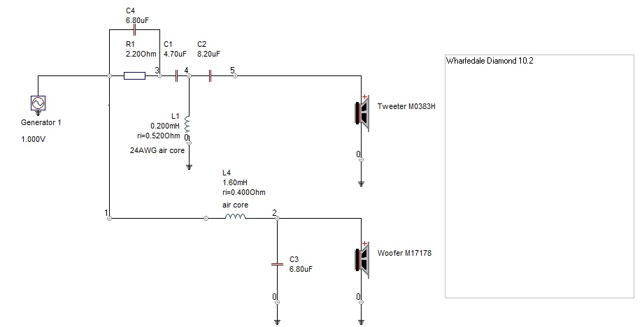

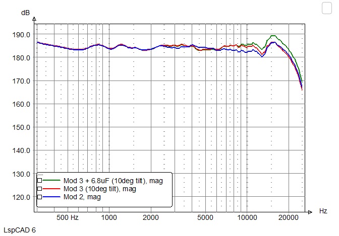

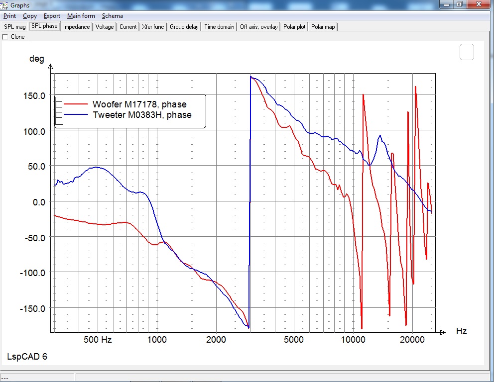

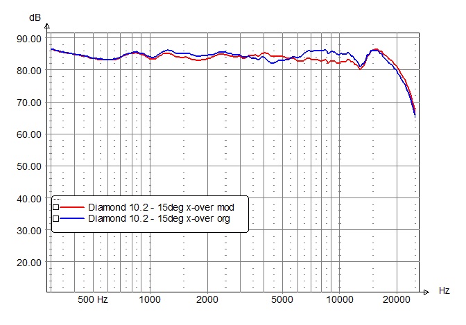

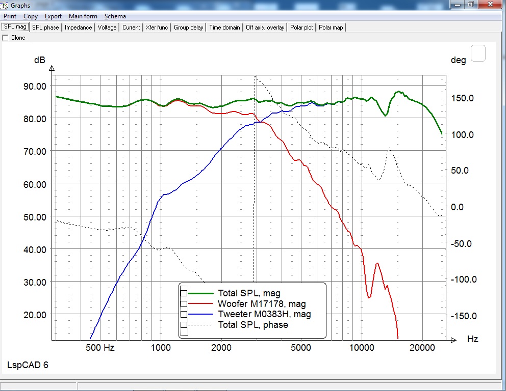

Hi Benbo,
I’m not surprised that you think that the Mod 2 has less top-end sparkle compared to the original cross-over when you do an A/B comparison. The question is which one is the more natural and has the best balance of the two?
This is a matter of taste and personal preferences and what kind of electronics you use together with the loudspeaker. If you use a “dark” sounding electronics it might be too little top-end sparkle for your taste. It can also be that you need to get used to the new sound character for a while in order to like it.
If you look at the picture 1 you can see that the original cross-over has a higher output between 6-12kHz, which will give you more top-end sparkle. As I mention above it's a matter of taste, if this is preferred.
The goal with the Mod 2 was to improve the phase behavior at the cross-over frequency as well as below and above it in order to improve the soundstage without the need to alter the enclosure. As a bonus the tweeter power handling is improved. However, this also meant that the tweeter response was flattened out at higher frequencies.
The good thing is that you can do something about it by trying my Mod 3 level. I haven’t tried it myself, but feel free to test it and if you like it, please let me know what you think. If it’s good I add it as a Mod level 3 option.
Mod level 3:
First of all you need to tilt the enclosure backwards about 9-10 degrees in order to get the mid-woofer axis about 22mm closer. When you have done this you remove the time delay circuit from the Mod level 2 and you get the frequency response as the red frequency plot in picture 2. If you still need more top-end sparkle, take one of the 6.8uF caps from the time delay circuit in Mod level 2 and connect it in parallel with the resistor R1 (see picture 6 and picture 7).
Picture 1: Original (blue) and Mod 2 cross-over (red)
Picture 2: Mod 2 (blue), Mod 3 (red) and Mod 3 + 6.8uF (green)
Picture 3: Mod 3 15deg off-axis
Picture 4: Mod 3 15deg off-axis, reverse polarity
Picture 5: Mod 3 15deg off-axis, individual driver unit phase response
Picture 6: Mod 3 cross-over
Picture 7: Mod 3 cross-over + 6.8uF

Hi again Goran,
Thanks for taking the time for the in-depth reply. I tried your suggestions, here's what I found:
What yesterday sounded like too little treble with the modded crossover now sounds more natural and balanced (the power of suggestion is strong!) To be honest, my ears aren't sophisticated enough to tell which is "better", maybe I'm just more used to the brighter treble of the original crossover.
Tilting the speaker back 9 degrees (with the original crossover) made a surprising improvement in the sound stage, not as good as the Mod-2 improvements but for $0 it can't be beat. Maybe that should be "Mod-0" 🙂
I tried placing a 6.8uF cap in parallel with R1 to increase the tweeter output, to be honest I couldn't hear any difference. I even shorted across R1 with a jumper and couldn't hear a difference.
The bottom line is that the Mod-2 crossover sounds so superior overall to the original crossover that I'm sticking with it. Thanks again for all your help!
Ben
Hi again Goran,
Ben
Hi Ben,
I'm glad it worked out for you!
Did you test the suggested Mod 3 without the extra 6.8uF and compared it with the Mod 2?
I'm curious how you think it sounds compared to the Mod 2.
The reason for not to publish the Mod 3 was that most people don't like tilting their loudspeaker backwards as needed in this option.
Regards
/Göran
Hi Goran,
I tried Mod 3 (tilting back the speakers) with the original crossovers. It increased the soundstage (but decreased the WAF 🙂). If I had to quantify it, I'd say it was maybe 1/3 the improvement of the Mod-II upgrade. Mod-II not only increased the soundstage, it also made everything sound "better", not sure how to describe it....
Ben
