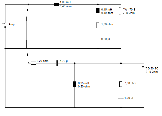

I just "crunched some numbers" on the Wharfedale Laser 90B speaker in the thoroughly modern Visaton ..... Pretty awful filter

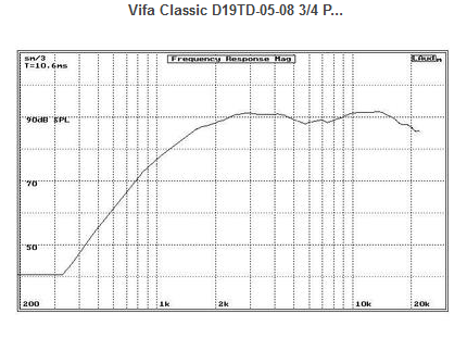

As for tweeters being tweeters, I can justify that. Look at these three basically identical 19mm models, the only difference being dome material and efficiency:
Vifa D19TD-05 3/4" Poly Dome Tweeter 264-500
H0737-08 19TFF 1
H0532-08 19TAFD/G
Not hard to adjust the input resistor to the filter to compensate. This would do with a 6" paper bass. If you make the bass bafflestep coil bigger, you just make the shunt components smaller but preserve the product. If attenuation becomes severe, the tweeter coil gets a bit smaller, say 0.25mH becomes 0.2mH. But not hard. 😀

As for tweeters being tweeters, I can justify that. .... Not hard to adjust ... loadsa stuff ..

My simple-minded approach relies on well-behaved standard sorts of drivers with published data and frequency response plots. Cabinet solutions are based on simple optimal stuff that works. It is not simple-minded at all, of course. More clear-minded. I leave it to the forum windbags to debate 0.618:1:1.618 or 0.8:1:1.25 cabinet ratios. 😀
To solve a problem, the best approach is to simplify it. That is what I suggest. Treble filters are really not hard. I use Zobels and an input resistor because they just work with most stuff and it's not hard to look up tweeter inductance.
Bass filters vary a little and I assume you're working with the usual 0.6-0.9mH units. Plastic is a slow material which responds to simple filters. A simple coil and capacitor circuit will work passably well with little need for a notch as with the Wharfedale Laser 90B design. With paper bass, it helps to notch the AAL3 Resonance to reduce the annoying bass cone-breakup sound which is around 5kHz for 6" paper units.
