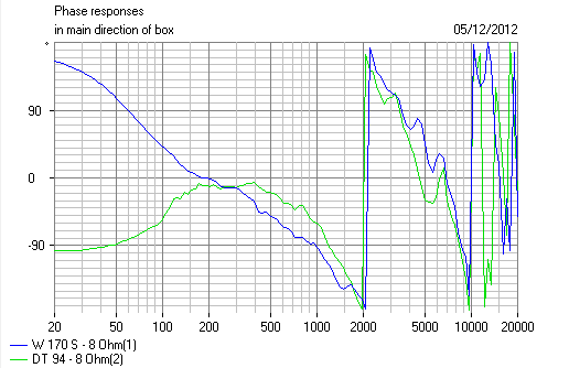

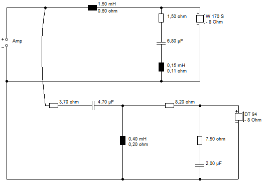

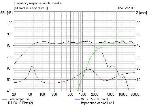

Thanks for your simulations, System.I just "crunched some numbers" on the Wharfedale Laser 90B speaker in the thoroughly modern Visaton ..... Pretty awful filter
Unfortunately, what is missing is the pretty awful frequency response and pretty awful impedance curve of the Wharfedale treble unit.
I'm not sure if the Visaton software can accept such information but if it doesn't, it is little more than a toy. (BTW, are you actually making a speaker with the Visaton & DT94? If so, there is a small mod that will probably improve the sound a lot.)
Can I urge you to get a copy of Schuck's AES paper which explains loadsa stuff.
Also to buy or make a cheap measurement mike and try something like ARTA or REW.
If you are playing with these, all my comments will make sense.
What happens is ... if you combine the awful response of the Laser 90Bs treble unit in the box, its awful impedance curve and the awful xover response, (which BTW, will be differently awful from the awful one you sim, the end result is surprise, surprise, not so awful after all.

Mike, have you found the 0.2mH inductor in the treble xover circuit. If its gone, you MUST replace it.
"Mike, have you found the 0.2mH inductor in the treble xover circuit. If its gone, you MUST replace it"
kgrlee, yes, I found it... even for an electronic 1st grader like me it wasn't hard to find, measurement awfully difficult until I purchased a multimeter which would measure inductance, which I've done and the reading I get is 1.8hH.

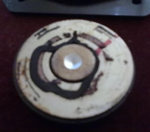

As for tweeters being tweeters, I can justify that. Look at these three basically identical 19mm models, the only difference being dome material and efficiency:
Vifa D19TD-05 3/4" Poly Dome Tweeter 264-500
H0737-08 19TFF 1
H0532-08 19TAFD/G
Not hard to adjust the input resistor to the filter to compensate. This would do with a 6" paper bass. If you make the bass bafflestep coil bigger, you just make the shunt components smaller but preserve the product. If attenuation becomes severe, the tweeter coil gets a bit smaller, say 0.25mH becomes 0.2mH. But not hard. 😀

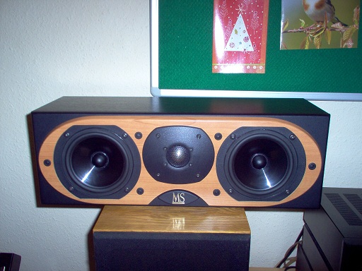

Mike, can you take a picture of your xover? Can you trace the circuit and post a pic of this too?
The 1.8mH you measured is almost certainly the bass unit inductor. Did you unsolder one end of the inductor to measure it?
