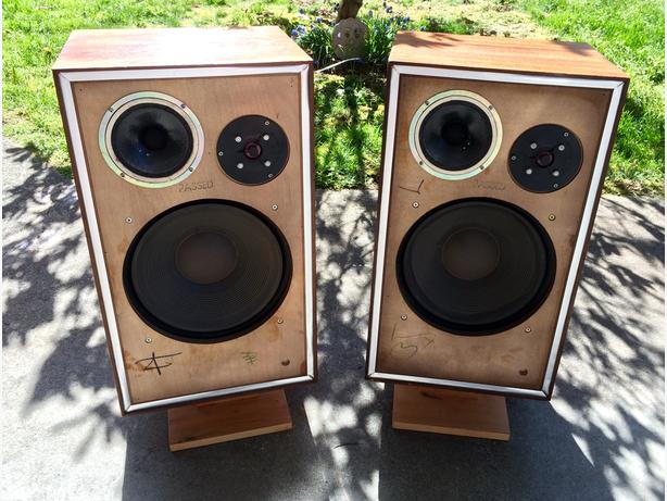

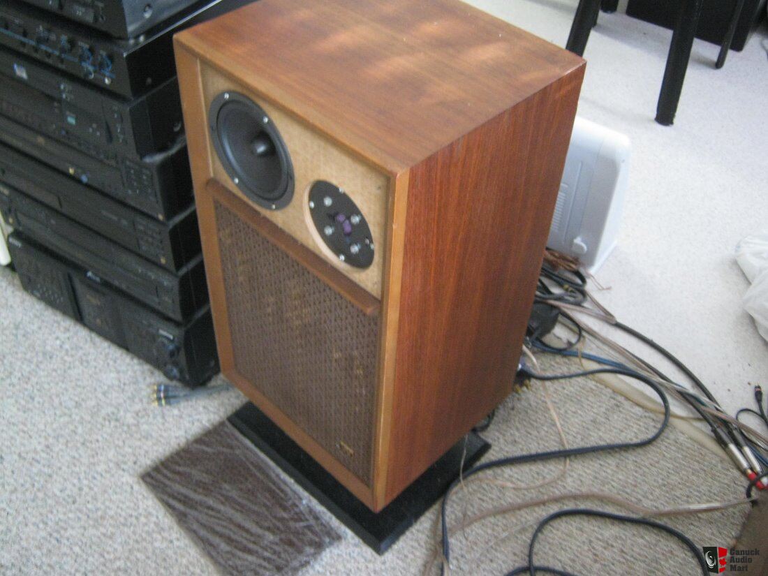

I'm not familiar with the "A" variant of the Dovedale III.
Does your Dovedale IIIA look like the one in the first attachment?
They do indeed look like that! though the midrange in the pictured specimen appears to have been changed out to a non-wharfedale model, my ones had midranges like more like the second picture.

It would appear that the driver compliment is the same in both the IIIA and the III, but the former has a more vintage style enclosure.

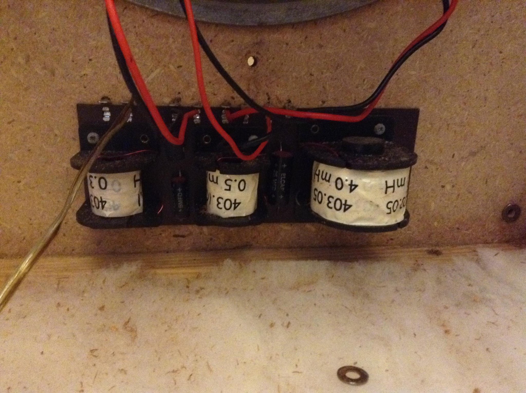

I was considering upgrading to the more complex and later dovedale 3 style crossover, minus the adjustable level switching. There must have been a good enough performance improvement to justify the extra expense of an extra inductor and 2 extra caps.
In case you don't have the full details of the later Dovedale 3 crossover (the one which connected to remotely mounted level switches):
High pass filter: Series capacitor 4.7uF & parallel inductor 0.5mH.
Low pass filter: Series inductor 4.0mH & parallel capacitor 32uF.
Band pass filter: This comprises of two stages, a high pass filter (25uF & 1.0mH) followed by a low pass filter (1.25mH & 4.0uF).
