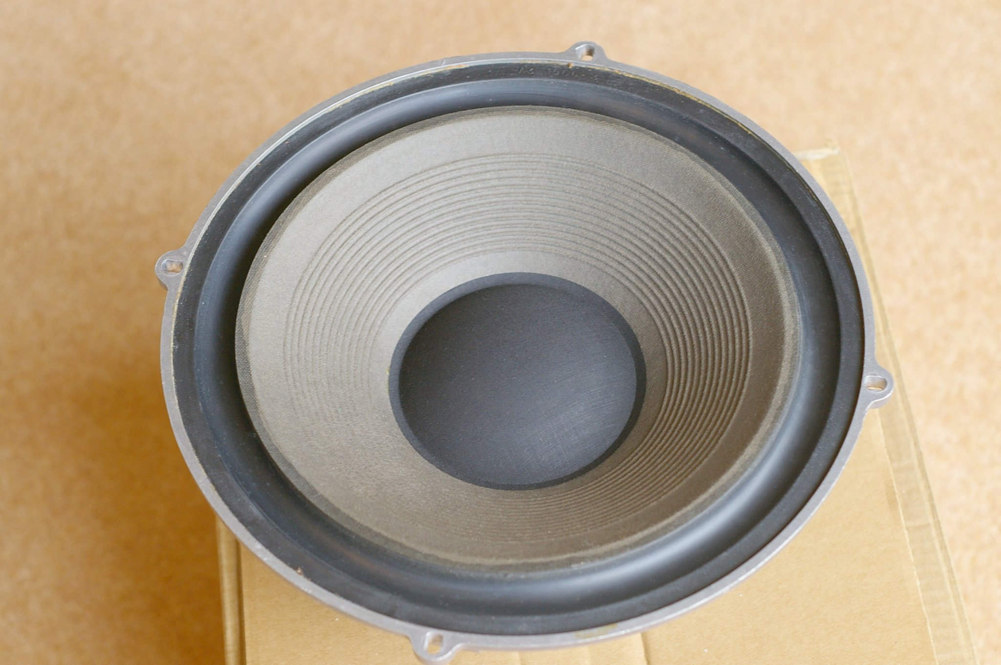

I have a couple of wharfedale 12" drivers that needs refoam/rubbering. What should be a straightforward job is complicated by the presence of an aluminum ring glued (very securely) at the top of the voice coil former preventing the application of shims to center the voice coil once the surrounds are removed.
These aluminum rings are not coming out. I tried heating to 200 degrees with a SMD rework hot air gun, freezing to -50 with freezer spray and cellulose thinners and nothing loosens the adhesive enough to remove the rings without ripping the entire voice coil out of the cone.
Does anyone have any tips on how to deal with this situation?

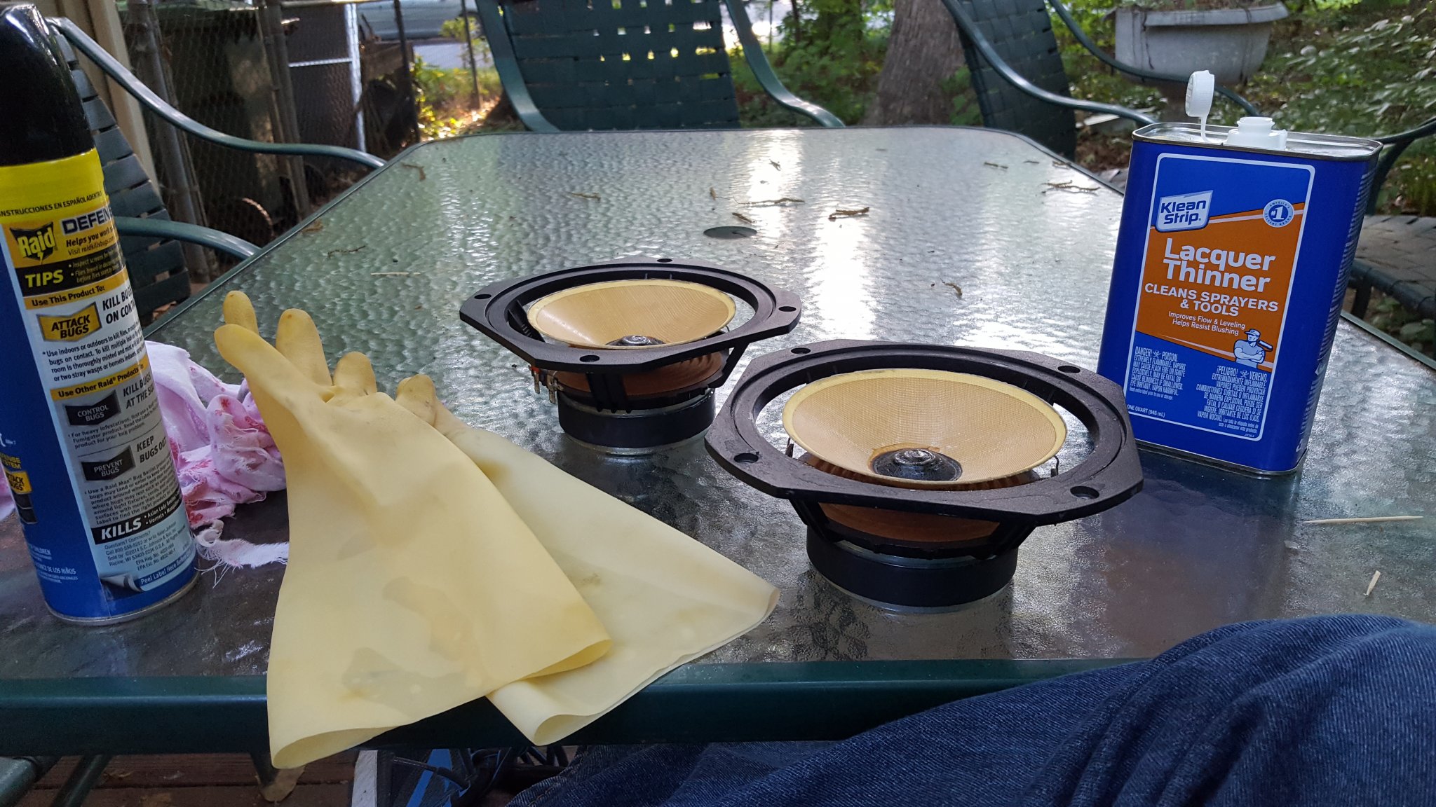

I had the same issue when replacing surrounds on a Focal 7K011DBL - the dust cap is part of the highs and and if it is damaged or replace the driver will not sound the same. Here's what I did:
Heat for the surround-to-cone, savagely tear off surround-to-frame, clean frame with lacquer thinner.

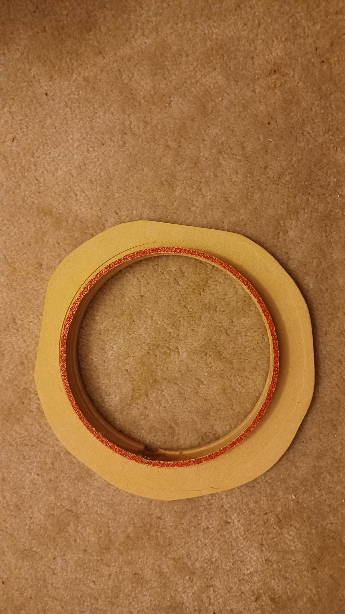

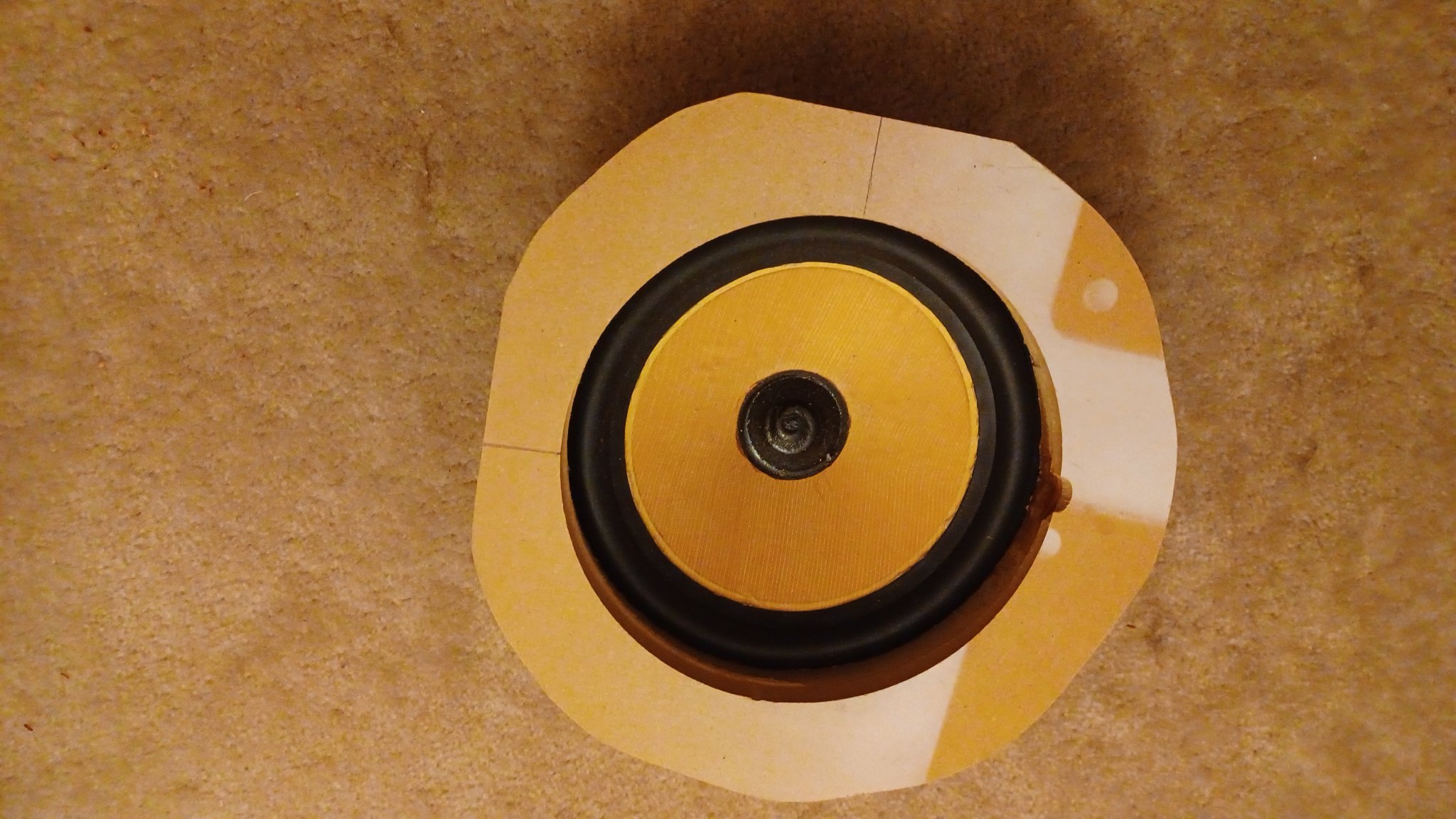

With a router, make a ring that will press on the replacement surround-to-frame. Course sandpaper is glued and trimmed to the bottom in order to grab the rubber.

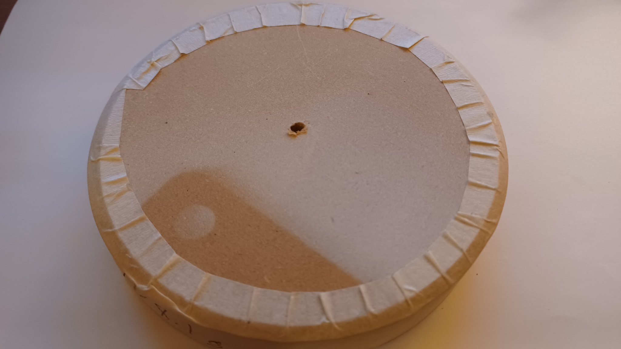

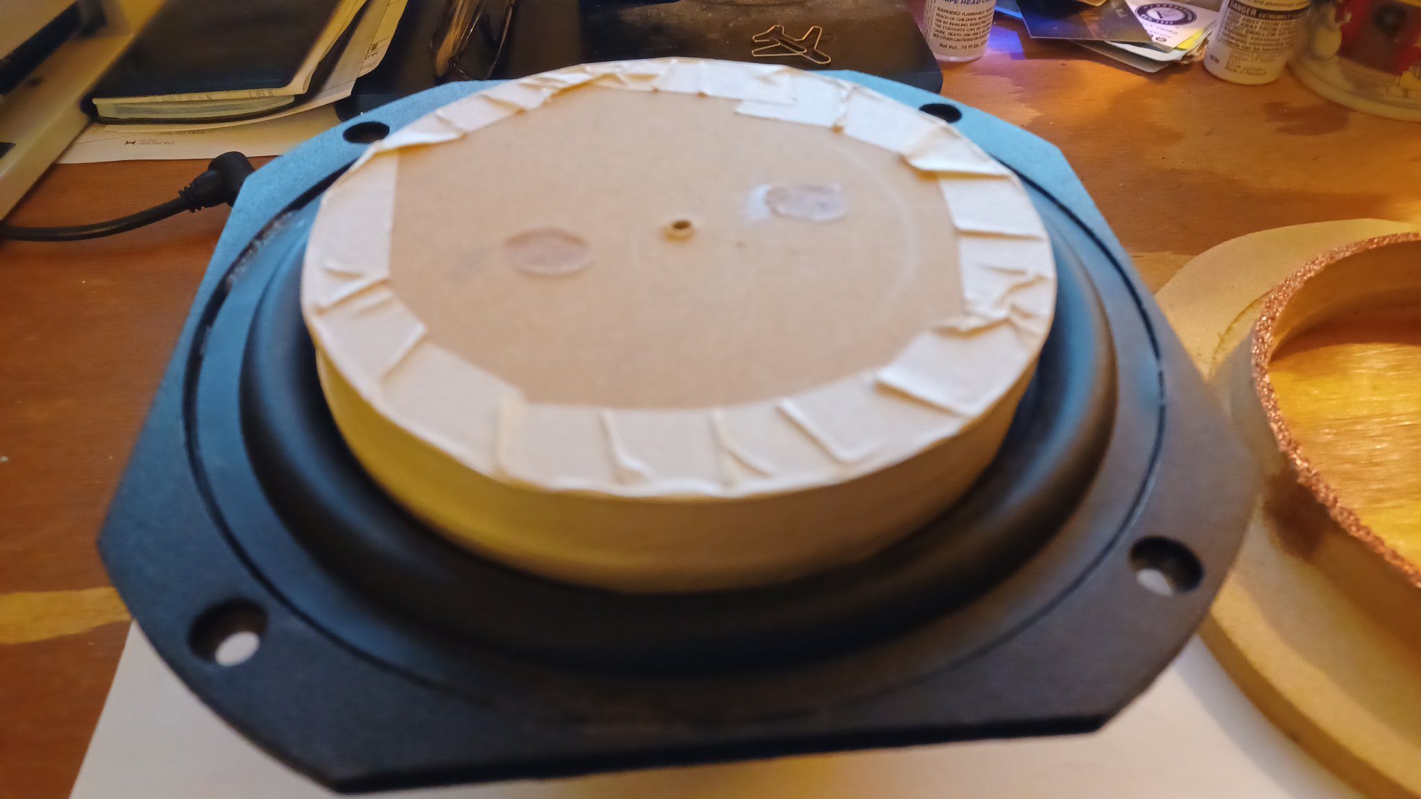

Make a disk that will press on the surround-to-cone. Bevel the circumference close the angle and width of the cone stick surface. Apply non-stick masking tape so adhesive won't stick.
Bear with me if you've already attached the surround-to-cone, for the other guys this is a great way to avoid fluted, wavy surrounds, especially with foam. Let it cure overnight.

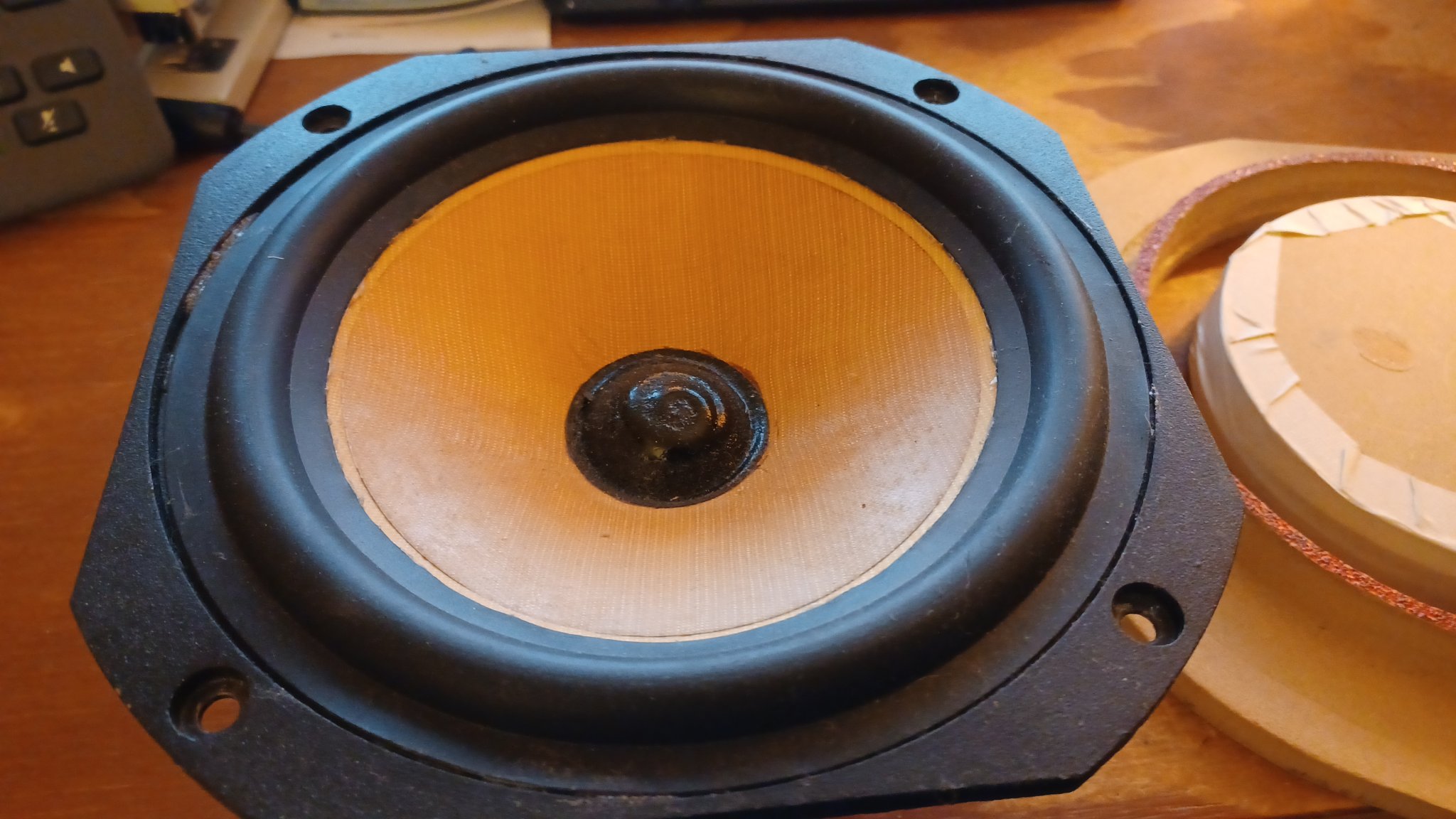

After pulling off the disk, the ring can be placed with grit side against surround-to-frame and move the cone X and Y. I made lines and a flat for each axis.

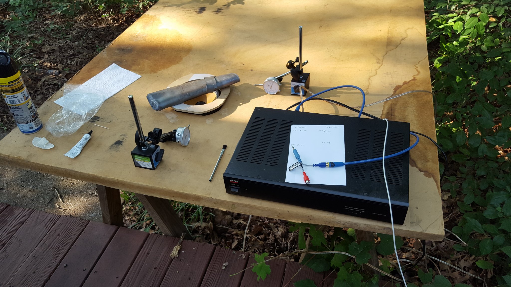

Out to the weather-beaten test table. Frequency generator app on smart phone, 1-centimeter range dial indicators (cheaper than 1 inch), power amp, brick or roll of sheet lead for weight. I placed the indicator points about mid-range on the ring flats and fed the driver 150 Hz, IIRC. Pushed left until distortion, wrote down the distance, pushed right until the same amount of distortion, wrote that down, then /2. Did the same thing up and down! THEN, I used the toothpick next to the adhesive, not the brush, to tack-adhere surround-to-frame at 4 points.
I used both toothpick and brush to slip glue under the rest of the surround-to-frame. It is precisely centered.

I tried Acetone. it does indeed soften the adhesive more than cellulose thinners did, but this ring is still not budging. i think the paper of the voice coil form if somehow impervious to solvents so the glue between the ring and form is unaffected.
Anyway the simplest solution turned out to be best. I found some super flexible bits of plastic and with he aid of some non-magnetic stainless tweezers worked them through the hole in the ring and round the corner to shim the thing in the conventional manner. It worked out fine!

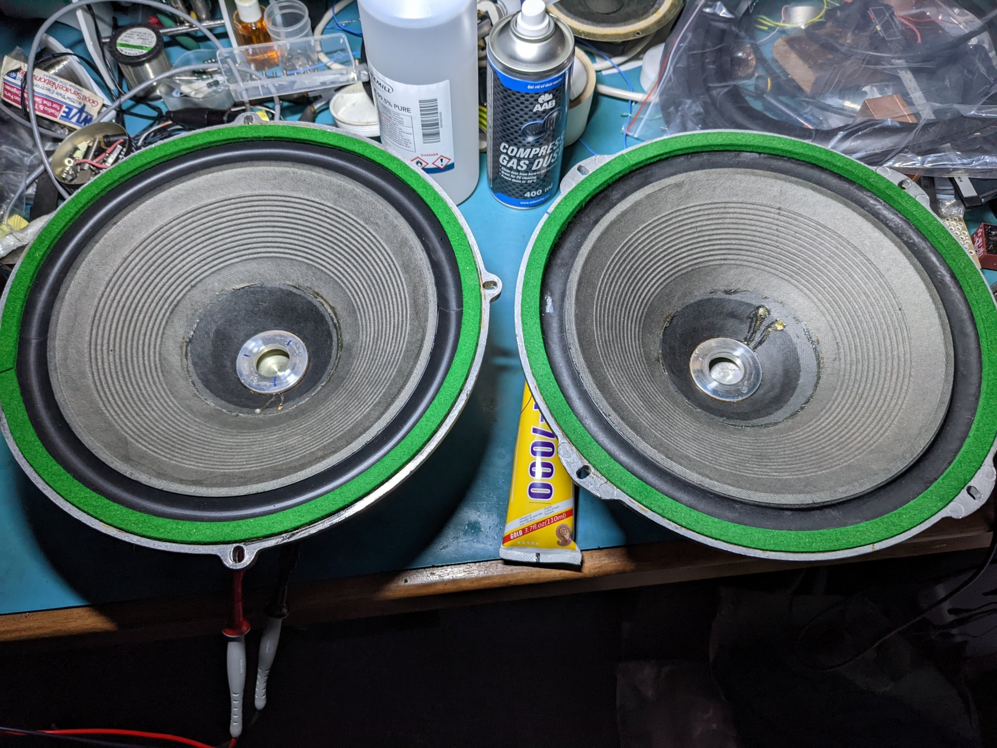

Photo of new vs old attached, looking pretty good apart from the messy desk! my one has 2 little lines where i had to splice together 2 surrounds to make one the right size. I also had to trim the outer and inner edge to make them fit properly. Hopefully the superglue on the splices holds and the T7000 keeps the new rubber sufficiently bonded to the cone. It’s shaking my desk at 30Hz quite happily right now though!

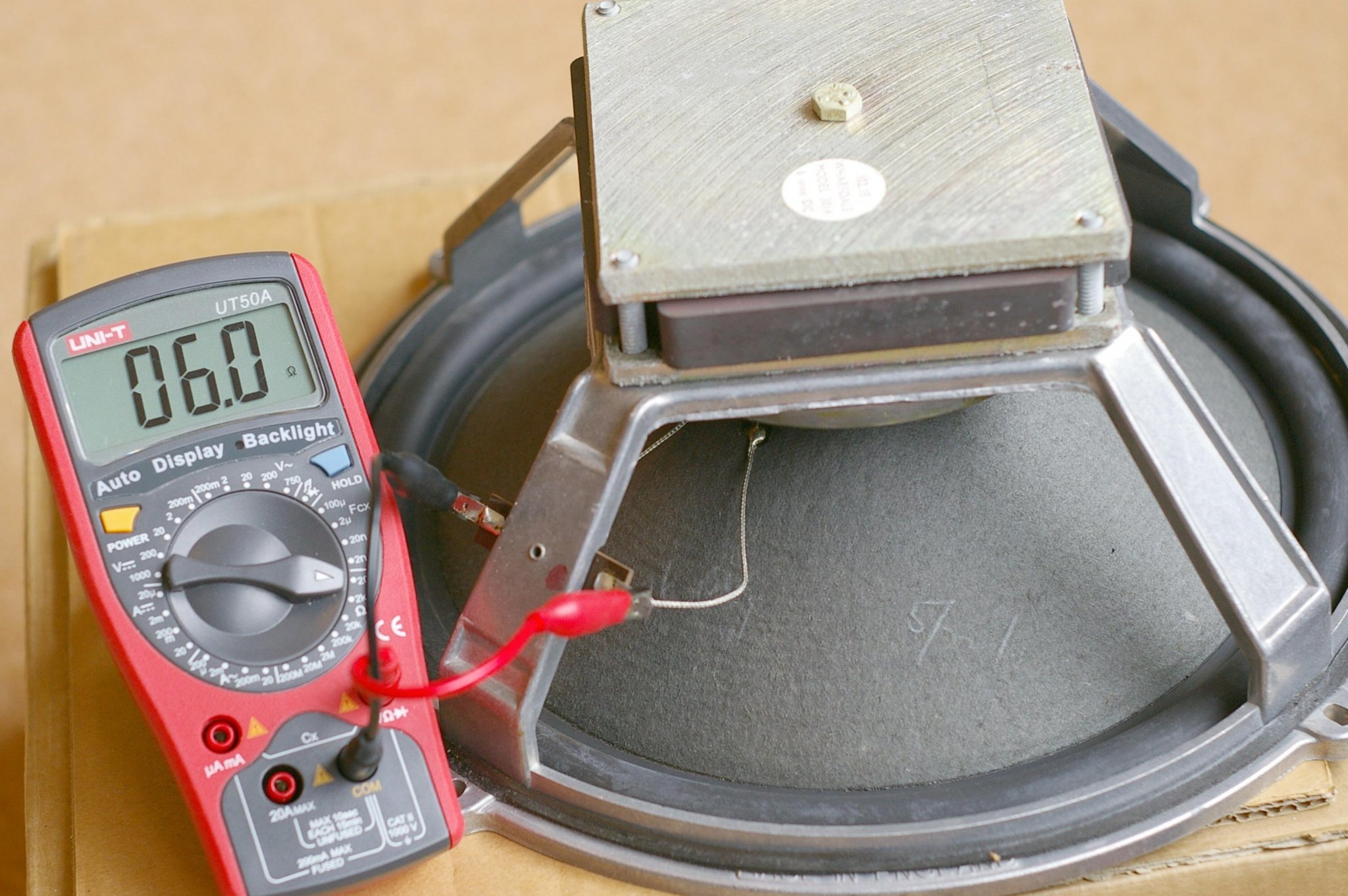

The Wharfedale 3014 specs below mention a 'high stability rear suspension' which may hold the voice coil securely in alignment.
Heavy duty paper cone with rubber roll surround
High stability rear suspension
Outer chassis diameter 315mm
Inner cone + surround diameter 305mm
Mounting hole circle diameter 320mm
Nominal impedance 6Ω
Large ceramic magnet, flux density 135,000 maxwell
System power handling 50W DIN
Driver free air resonance 25Hz
Response only 3dB down at 45Hz in a 45 litre sealed cabinet
Upper crossover frequency 600 - 1,500Hz
I've added photos of one of the 3014s I sold - just because I can! :cool:
