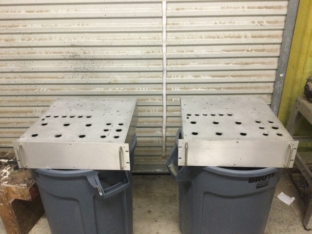

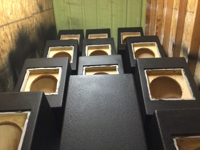

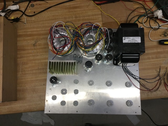

Trafos are all here, the prep is all finished on my speaker project (shooting Duartex on 20 PA cabs now), so fixing to ramp this thing back up again. Here’s what I’m proposing for the new layout. 19” form factor, with a 3U height because I have 4 nice front panels. Trafos, tubes, heatsink and caps stick out the top. The idea was to keep the signal routing for the amplifier section pretty much identical to the original prototype, and compact the power supply. Probably do the voltage regulators on a little perf board (like the bias pot board) because it will be easy to handle strings of zeners that way instead of point to point. All 3 hexfets on the common heat sink. First pic shows where everything on top side will go. 2nd shows what’re the other 2 transformers go, but mounted from underneath. 3rd is the original reference design. Anyone see anything that just isn’t a good idea? Drilling soon.....

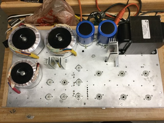

Finally finished the time consuming part of this..... I now have two complete chassis ready and now I get to resume actual electronics! So what was taking so long? Painting all these speaker cabs before winter makes it impossible. Now I’ve also got a shop floor covered in aluminum shards.
Finally progress - real progress

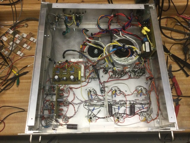

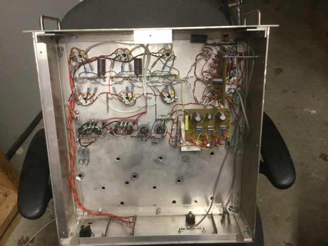

The first one of the final monoblock pair is almost done. It was working properly with the front end section plugged in directly and the power stage running thru a 300 watt bulb limiter this afternoon. Full power music test some time tomorrow. The second unit is to the point where I need to scavenge transformers off the prototype to finish it.
A couple minor updates. An extra RC in the feedback path for low frequency compensation (suppresses the volt or so of sub-1-Hz ringing when recovering from full power) and added transformer input coupling. I was using an LTP tube stage to add balanced XLR in, and but there was an incredible amount of HISS that I couldn’t figure out where it was coming from. Just did the balanced input the easy way after battling it for a week.

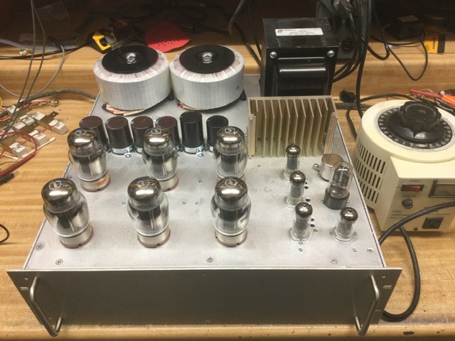

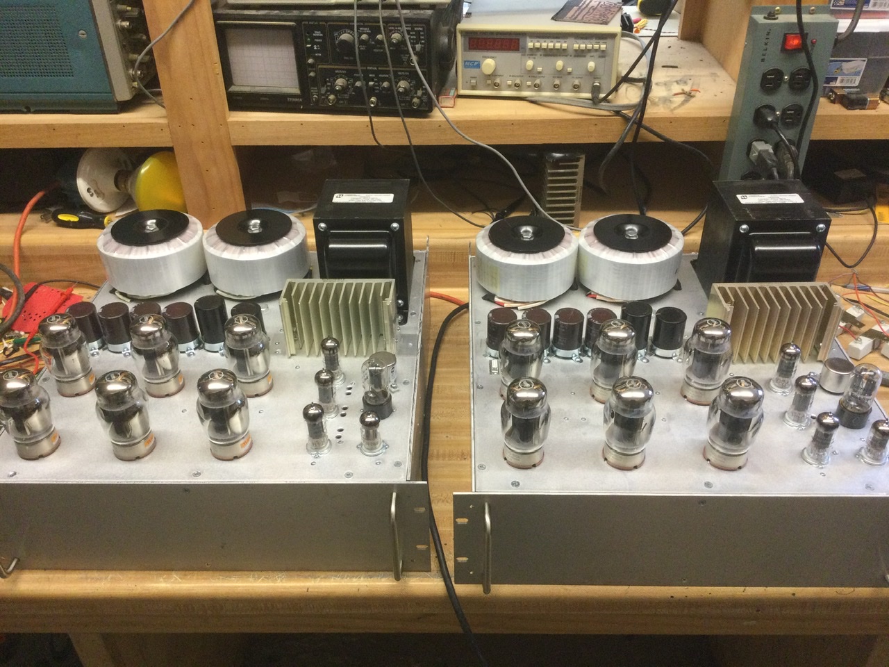

Well here they are!
Both amps completed, except for installing the bottoms on the cases. That will happen when they get racked.
Final schematics to be posted when I get to my other machine later. There were a couple minor mods. I did try the 475 volt power trafos in one of them, but ultimately just used the original 430 volt. Power only increased from 210 to 248 watts, despite going to a full 700 volts. 200 watts per channel into a pair of 2x15’s was playing as loud as I’d ever want anything to.

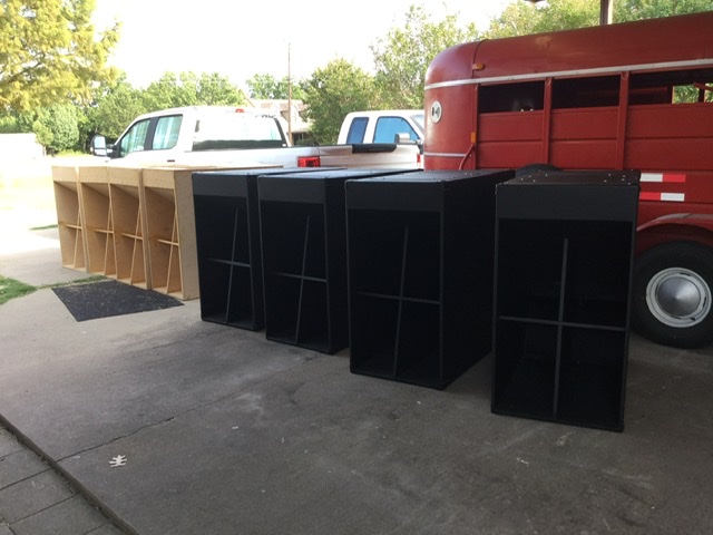

Congratulations! That's one hefty project by all measures. What kind of speakers will they be used with?

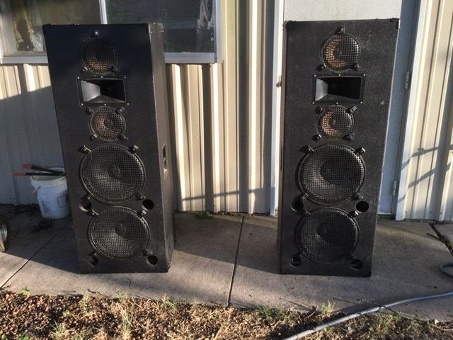

Right now I was using a pair of 2x15 + 2x8 +1” PA speakers. Custom build for small parties, just the best speakers I have for testing - fairly bulletproof. I have 12 Audax HM130Z0’s and a pair of AC G1 ribbons, to make a more “hi-fi” oriented version of them. The only thing to be decided is whether to use the Kappa15LFs or hold out for something “better” on the bottom.

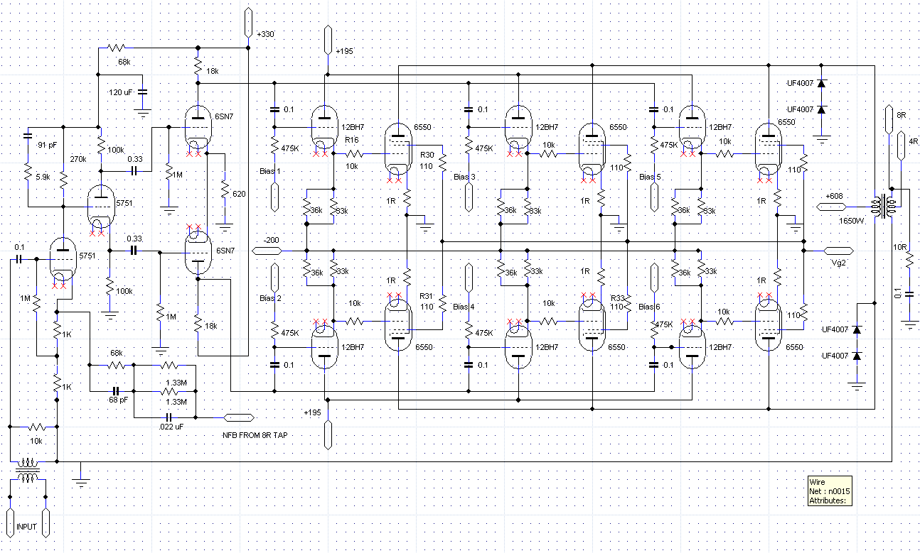

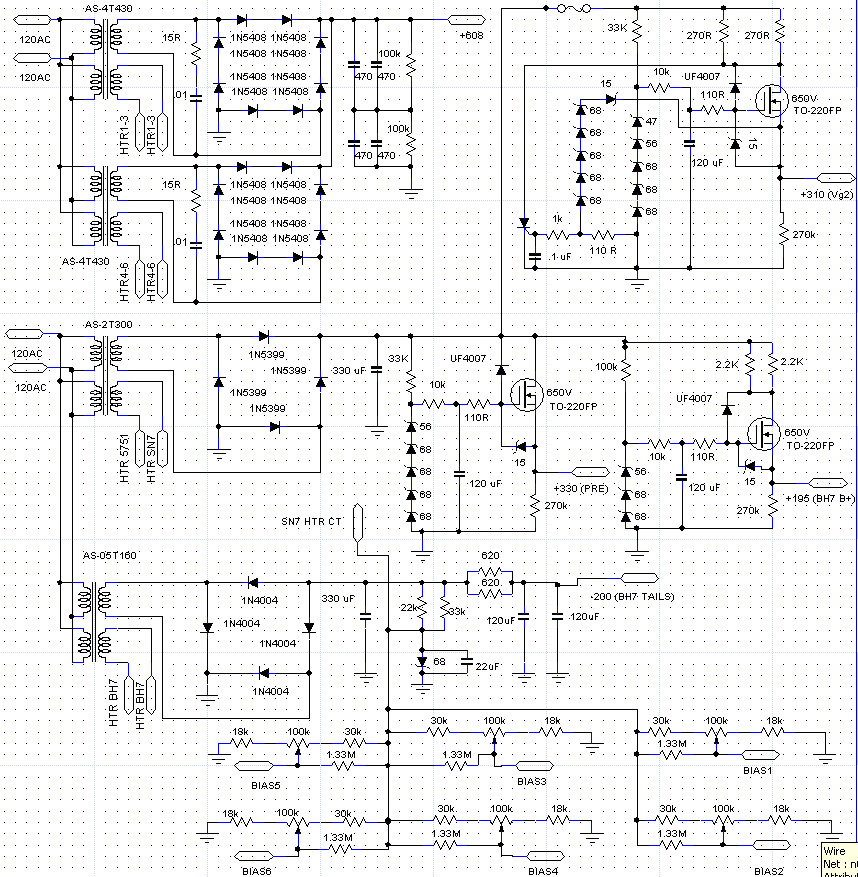

Final schematic set
A few updates from the original design:
Screen supply now taken from the 300V transformer. This experiment succeeded, unlike the 475V mian HT trafo experiment.
Main HT filter caps now 4x 470 uF, because I had a bunch of these.
One 68V zener in each stack dropped to 56. The latest batch of 68's were measuring 70, so it was needed to trim the voltages,
Added 1.33 meg resistor from bias pot wipers to -68V bias supply In case the pots get intermittent.
Increased coupling caps on concertina to 0.33 uF
Added additional low frequency feedback pole to reduce amount of feedback below band. Completely kills the ~2V p-p oscillation that still occurred with no load.
Used a 10k:10k transformer to couple the input and break any potential ground loops. Tried a 12AX7 differential input LTP, highly degenerated to a gain of 2, but it still had too much noise. Decided enough was enough and did it the easy way.

What is the use of the UF4007 series diodes at the OPT? What do they protect?
Regards, Gerrit
Regards, Gerrit
For no-load protection. Saves the output transformer from dangerous flyback voltages. If the voltage at a plate tries to go above 2X B+, the other side of the transformer goes below ground and the diodes clamp it. Without them the plates can reach for the sky when a tube cuts off with no load except the primary inductance. And I have already tested it - the other day I accidentally ran one of them without the dummy load for about 20 minutes, with music and visible clipping on the scope. The music still sounded clean - I was monitoring through a speaker and 1k ohm series resistor to keep the volume reasonable in the shop during extended testing.
