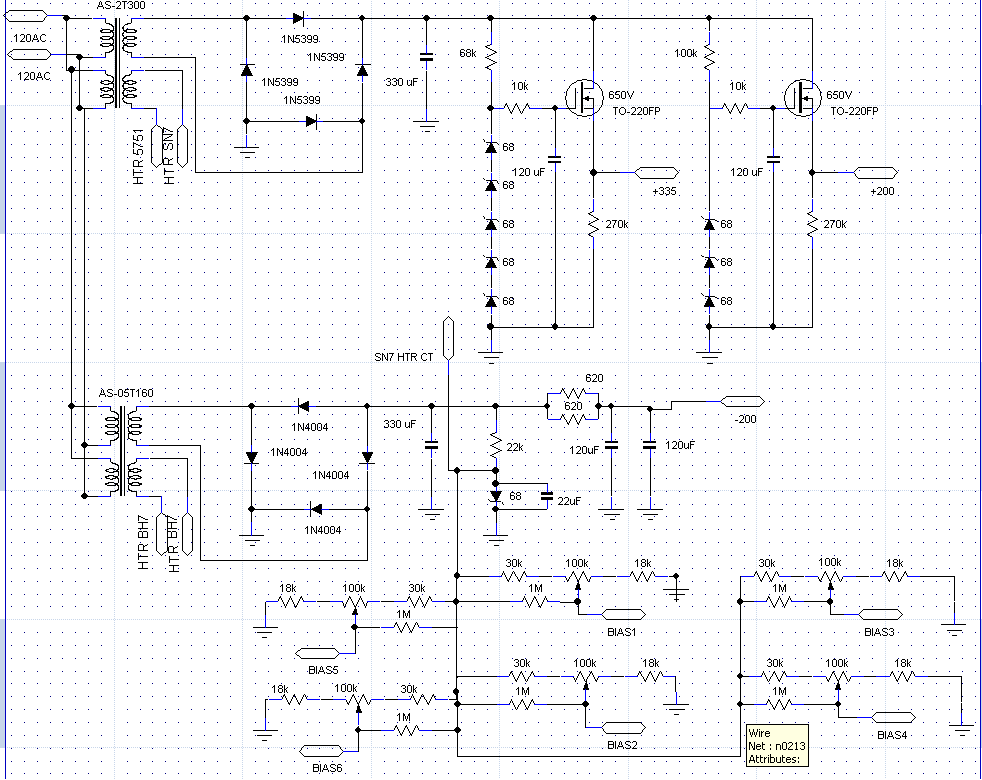

I had this hairbrained idea to get some Tubelab kind of power.
I have been quietly working on a big one to move the definition of "Tubelab kind of power" a bit higher.

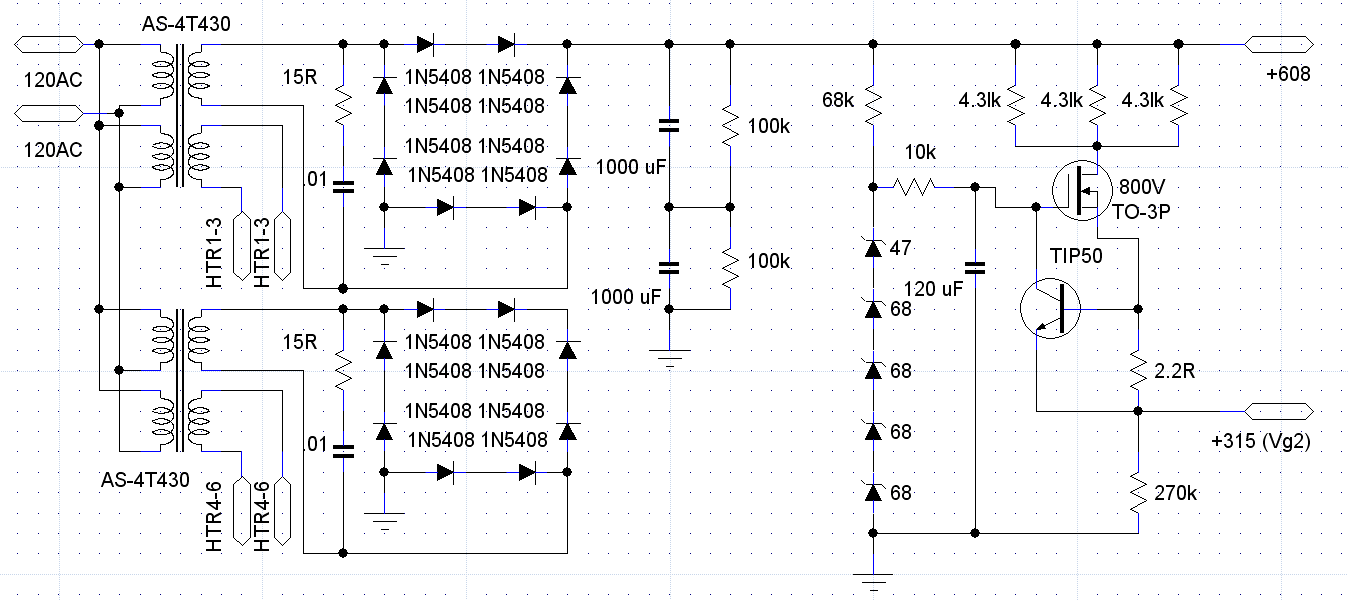

My amp uses TV sweep tubes, and aims for 400 to 600 WPC. My OPT's are rated for "400W @ 20 Hz". I have a screen regulator similar to yours and it has been the source of most of my blown parts. The big difference is that I am running my screens between 150 and 175 volts, so there is more drop in the mosfet. After blasting a few fets and a couple tubes I realized that most mosfets are designed for switching use, and not for linear regulator operation. Many do not even have a SOA spec for DC operation, and some of those that do, LIE!
There are some linear mode fets, and so far a big IXYS "L2" fet is holding up, but I added a few parts to make life easier on the tubes when a fet blows. Fets, and most silicon devices fail to a short which could put full B+ on the screen grids. I added the resistors in series with the drain, which you already have.
I have also added a pair of series connected 5 watt Zeners from the regulator output to ground. They are sized so that they never conduct in normal operation (2 X 100 volt in my case), but will eat an over voltage and fail to a short if a fet blows, possibly blowing the resistors....This happened once already, and saved a pair of tubes.
In the complete amp there will be an Arduino compatible (Teensy) board to shut things down in the event of any misbehaving circuit.

Before any sine wave testing I need to get some 800 volt SCRs for an OVP crowbar on the g2 regulator. Goes above 380 volts (one more 47V zener), crowbar the drain resistor to ground and blow a 250mA fuse. I forgot the SCRs on my last Mouser order. I have some 400’s, but I don’t trust them with the HT at 600. Last thing I want is nuisance tripping while testing the ruggedness of the mosfet. I forget the part # at the moment, but it was selected for relatively high on resistance (1.4 ohms) and only an 8 amp Id rating. Mosfets are like Bipolars wrt second breakdown. The smaller dies tend to have a higher SOA at elevated voltages. May be a couple weeks - I’m getting an order together, which is already filling up fast. Usually it’s months between bulk orders. Not ready to buy the other 1650W yet.
I already have 4 more BH7’s, so they are going to stay. I’m getting over 100 V p-p out of the driver cleanly, and there is enough loop gain to need degeneration in the input stage (hence the high-ish feedback resistor values). One of the design constraints was to use common tubes - before I go off and do something really stupid with sweeps, But there will be other experiments before going higher power. I picked up a nice quad of 6CB5 that I can probably get 150 watts out of without spending too much on iron. That will become the bass amp. I only have a smattering of 36/26LW6’s that are all mix and match. Only one pair identical.

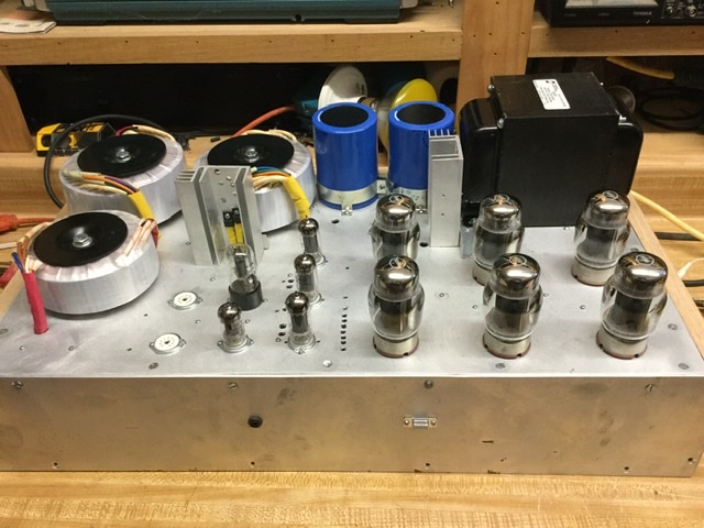

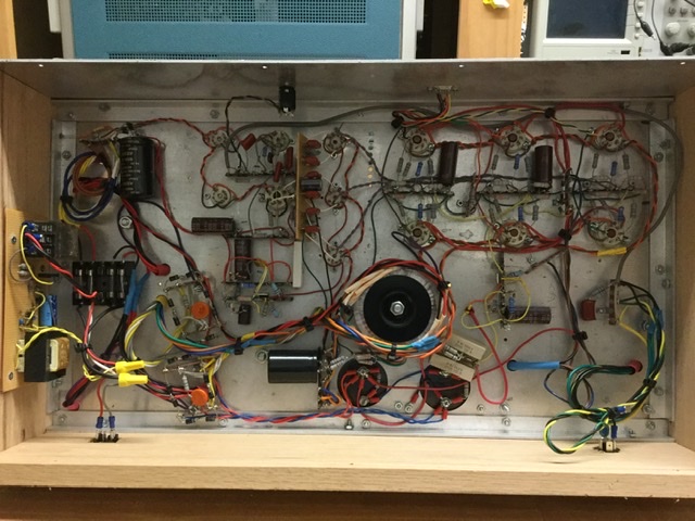

I like it! I would like to see the wiring / component side as well. And hopefully some measurements later? What class do you run? How hot do your MOSFET PSU parts get? I see you’re using quite big heatsinks. Good luck with building the 2nd channel!
Regards, Gerrit
It’s pretty low bias right now, 20mA per tube. I may go higher, but I’m not hearing any overt crossover distortion. The mosfet heat sinks are something I have in quantity - the front end regulator just gets warm to the touch and stays there. The g2 stays stone cold till the music gets pretty loud. I will probably re-do the front end power supply with an Antek 1T175. That will give me 225/450 and let me use 400V caps which I have a lot of. And cool the regulators off because of less dissipation on the one feeding the followers. When I do the 2nd one I’ll try to fit it in a 17x17 form factor, so I can make use of some really nice 3U front panels I picked up at Skycraft. Then duplicate it using parts from this one. I figured there will be some lessons learned. I’ve never built a really big solid state amp that I didn’t figure out how to re-do better. This thing sounds good enough that it’s worth pursuing building a pair of nice monoblocks. And will get me off my butt to build the 2x15” 4-way speaker design I’ve been threatening to for the last 10 years.

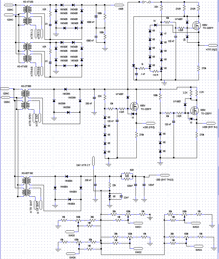

Updated power supply - and some POWER results
I got me a batch of 26LW6's for my NEXT power amp, and was thinking long and hard about the power supply. How to get a 175 V regulated screen supply, and 900 volts on the plate. Then it occurred to me - stack two power supplies. One at 200V, and the other at 700. This has real possibilities and I can actually cobble that together. Then I thought about revamping the power supply in this amplifier. I off-loaded the screen supply from the main 600V HT to the lower 400V B+. The 200VA toroid used for that is more than big enough. This allows much higher peak screen currents safely - so much that I now blew the 250mA crowbar fuse in normal operation with music at clipping - and had to bump it up to 500mA. No issue at all blowing the Mosfet. I dd have to add protection diodes to prevent the ripple filters from blowing the gate protect zeners when the supply does rapidly collapse - something I should have done earlier. It now operates completely safely with music or sine waves.
Music waveforms hit just over 70V peak with lightly compressed music (good recordings that aren't digitally clipped). That is around 300 watts music power (50V RMS equivalent). The screen voltage is obviously high enough. Unclipped sine waves hit over 58V peak, or 41V RMS, which is 210 watts. This is with a 8 ohm dummy load on the 8 ohm tap. The HT supply collapses to 538V under those conditions, so assuming the plate can be brought down to 60V the math works out perfect. That will pull 100+ mA peak screen currents in each tube and the regulator is having no problems with it. If I had left the screen supply on the main HT, the supply droop would be worse and I'd be maddeningly below 200 watts. And then always wonder about the regulator.
I have started laying out a more compact rack mount chassis which I will build two of. The $64k question is which power transformers to order for the HT - more of the 430V which I have now or bump it up to 475 in hopes of 250 watts. Only an additional $114 in total. It does hit 200 watts now, and does so safely. Should I be scared of just over 650 volt HT, with these tubes and Hammond OPT? Or call the design done and get stooooopid with the sweep tubes?

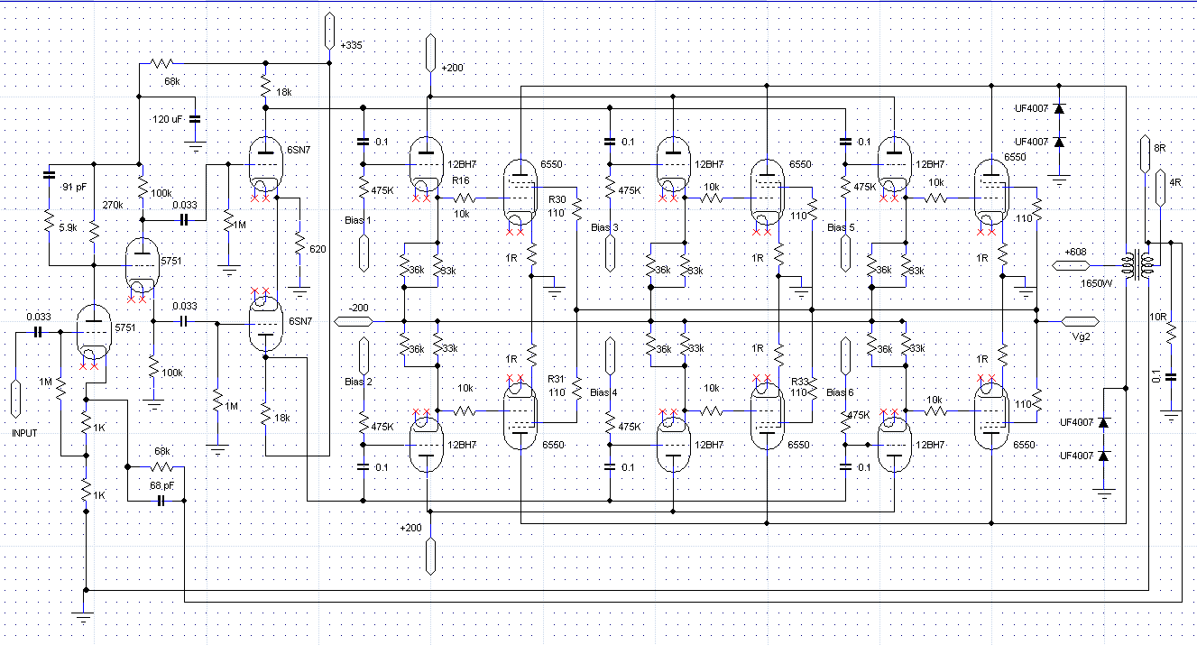

The schematic in post # 1 solves the grid return resistance problem nicely.
Individual cathode followers, extra parts, but great implementation.
Otherwise for most designers, the following applies:
1. Fixed Bias:
6550 tubes need 50K DC return resistance to ground.
If you have a 10k grid stopper, then they need 40k DC return resistance to ground.
If you have three 6550 I parallel, and each one has a 10k grid stopper, then
you need 40k/3 = 13.3k DC return resistance to ground.
The driver will probably have problems driving 13.3k.
2. Self bias:
6550 tubes need 100K DC return resistance to ground.
If you have a 10k grid stopper, then they need 90k DC return resistance to ground.
you need 90k/3 = 30k DC return resistance to ground.
Now, the driver has to drive 30k.
KT88 Fixed bias 100k DC return.
KT88 Self bias 220k DC return.
Self Bias anybody?
Stronger Driver anybody?
"More expensive" KT88 anybody?
Which is more expensive, better tubes, or a complete re-design?
Extra Power plus Reliability at the same time do not come easily or cheaply.
Happy designing!

Very good - LF stability OK? Mr Zintolo may be interested in this with GU50s as it may work for his 450W bass amp.
I didn’t have a bit of problems with motor boating with this thing. Having a completely separate power supply for the front end probably helped. I’ve got another amp in progress that does have severe LF stability issues, and I put it aside to finish this. Right after a full power sine wave transient that’s abruptly cut off, I do see some low level ringing that dies in a second or two. It takes a second or two for the scope trace to settle out on zero. Amplitude level is really low, under a volt peak. If that’s all it does I’m not going to sweat it.
I’ll probably use the same general topology on the next big sweep tube amp, except that the driver stage will be hexfets. Probably need more aggressive lag compensation, as the OPTs frequency high response will be a bit less than this one (understatement of the year) and there will definitely be more parasitic capacitance.
