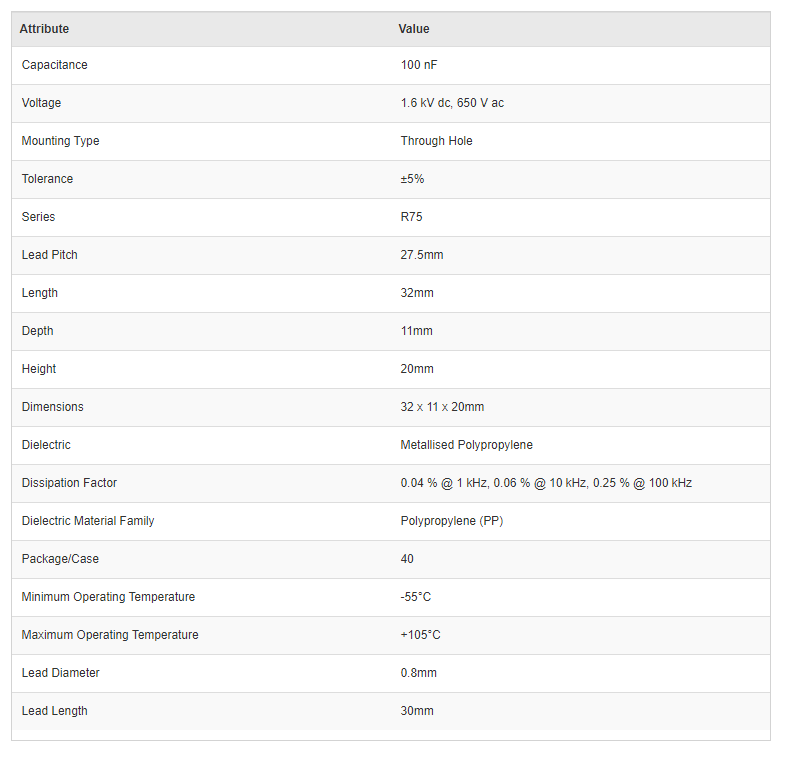

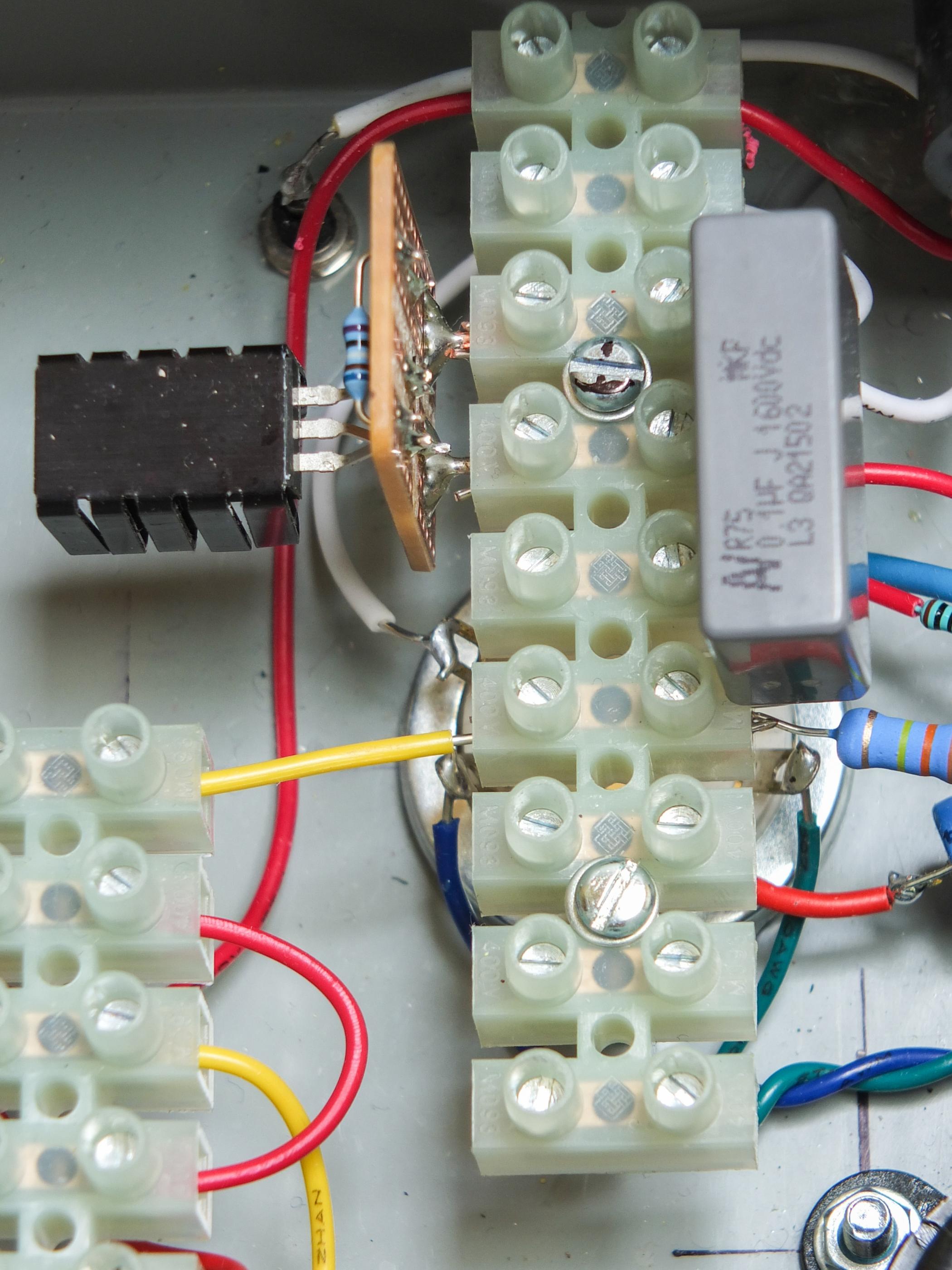

The 100nF coupling cap is overrated, so it has either a 600V or 630V rating, and is a modern material cap; Not a paper cap, etc.
I think this is OK, wouldn't you agree?

goddlediddles,
It is OK.
Keep up the good posts.
Keep designing, keep building, and keep enjoying listening.
Just my hopes.
