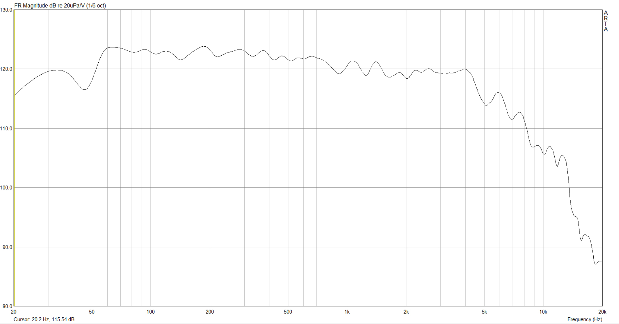

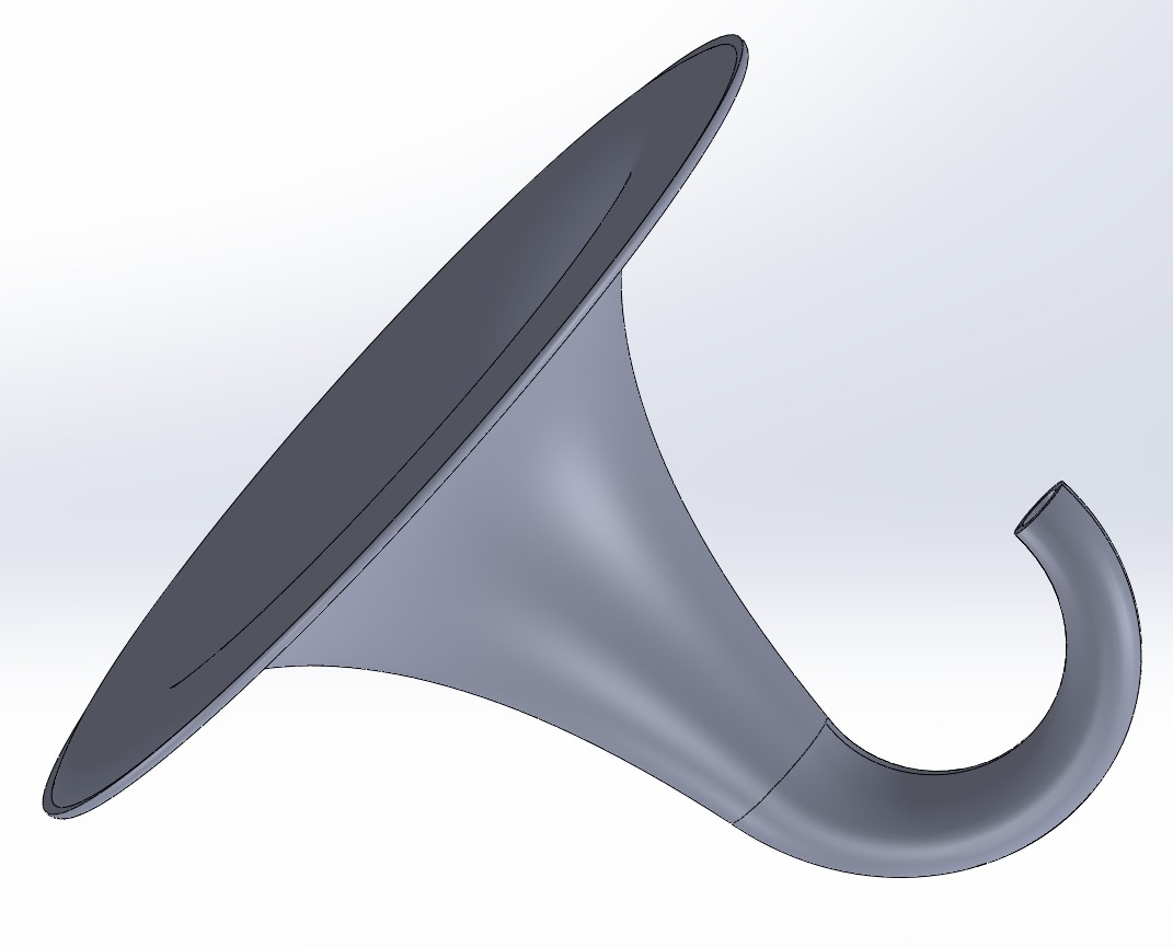

I'd like to see small neo driver with similar membrane geometry rather than replica. Currently I'm making JMLC 42Hz horn bent like Sato horn. It is similar to WE15A. I can make WE15A but I don't have drawings. Anyone have?

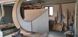

Horns with well rounded bends have much wider range than do horns with flat reflectors which in fact act to filter the response above the bass range. Bass horns don't need any deflectors in the bends.
So this one should perform better than squarish WE15A?
I can build WE15A if someone would like to test.
