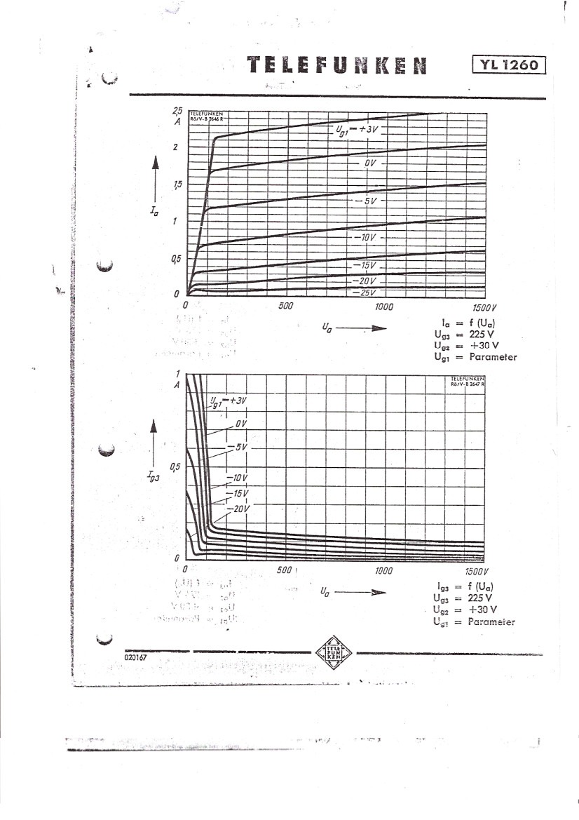

Sexy... Where's the triode curves though 😛
Also, they're using the supressor as the screen? G3 at 225V but G2 only 30V?

My guess is a typo. I don’t see how one could get an amp and a half of cathode current with g2 at 30 volts, even if the heater drew 20 amps.Sexy... Where's the triode curves though 😛
With that much current at Vg2=225, I seriously doubt that it would like triode mode very much. At least not anywhere near full dissipation rating. It would be a shame to have to dial the b+ down to only 400 or 500 volts. I bet they cost a pretty penny.
There is an extra grid called the "shadow grid" which is in front of the usual screen grid. It is wire aligned with the screen grid and "repels" the electrons away from the screen grid wires to keep screen current low. ( +30V on the "shadow grid" ) The 4th grid is the usual beam forming one. The tube is called a Hexode.
From the equal spacing of the pentode curves at high current, I would guess it is linear in triode mode too. But I haven't seen any triode curves. The tubes are collector items, less than a 1000 were made. A dream tube that has vanished.
