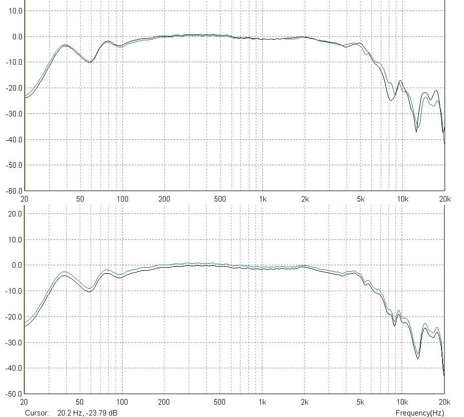

here's a frequency measurement of Line Magnetic 555 replicas, post 9!
Thanks!
I am reposting the curves. These were done on plane-wave tubes. The bottom curves compare 7V and 9V through the field coil.
The low-end wiggles may indicate that the PWT was under-damped at those frequencies.
I wish there was an impedance sweep, too...
expecting anything less from that substantial chunk of metal(s) is ..... not logical
