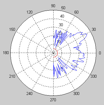

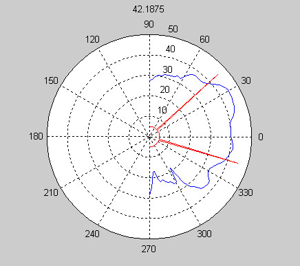

At worst case, you can hear that extra source discreetly, at best, it only draws attention to the speaker. Earl Geddes horn flares are the mathematically least perturbing curved shape (which has superior driver loading).
Consider that for a one inch exit compression driver, that the exit is already large enough to limit the maximum horn angle at 20KHz to 60-90 degrees .
A 2 inch driver is about half that angle. Also, at high frequencies, the wavefront shape emerging from the driver may or may not be a plane wave depending on how the driver is made. For a conical horn like I use at work, a driver with an expanding wavefront like a bms 4550 is a good choice for a tweeter where it is greatly rolled off for CD compensation.
There are three working zones for a horn too, if your well above the low corner, you have the acoustic transformation region which extends form the driver radiator forward to a point in the horn where the area is about 1Wl in circumference (which is also the ideal thumb rule size for a mouth at the low cutoff).
At a higher F, this working region only extends a little way from the driver though. Past that point is where the horn is still bounding the wave edges and can ‘steer” where the sound goes. At some point beyond you reach a dimension where Don Keele’s pattern loss thumb rule applies, the wave front is acoustically large enough to proceed at that angle without horn walls. This may still be well inside the horn up high too, it is why an exponential or tractrix horn has a narrowing dispersion angle as the frequency climbs. At 20KHz, that acoustic transformation zone is well inside the compression driver itself and the exit is already large enough to be partly controlling the directivity at 20KHz.
