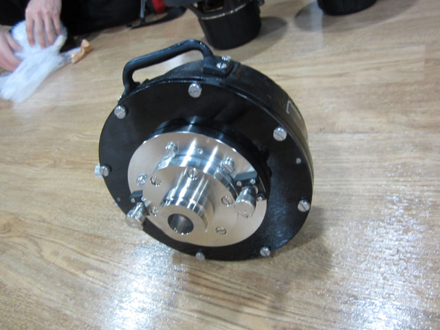

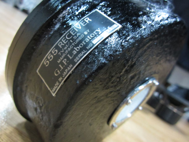

Here's some pics of the GIP 555...
wow they even duplicated the not so wonderful sand cast rear tub! Ha! You can see the mottle on the outside just like the original. Now THAT is attention to detail.

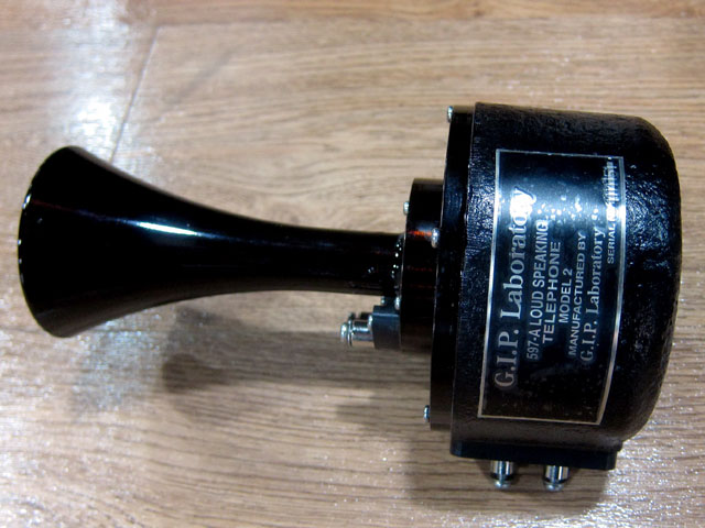

Pic of GIP 597A tweeter. Putting it out there for inspection.
This is probably their most famous and popular unit, thanks in part to the insane pricing and scarcity of working original 597As.
They did a lot of metallurgical analysis to get the materials as close as possible to the original. All mechanical specs are precisely 1:1 with the originals.
The main visual difference between originals and GIP is that GIP's "chrome" is shinier and their glossy black is smoother. I'm sure they mean it as a tribute.
Anyhow...this is what a 597A Loud Speaking Telephone looks like, folks.
