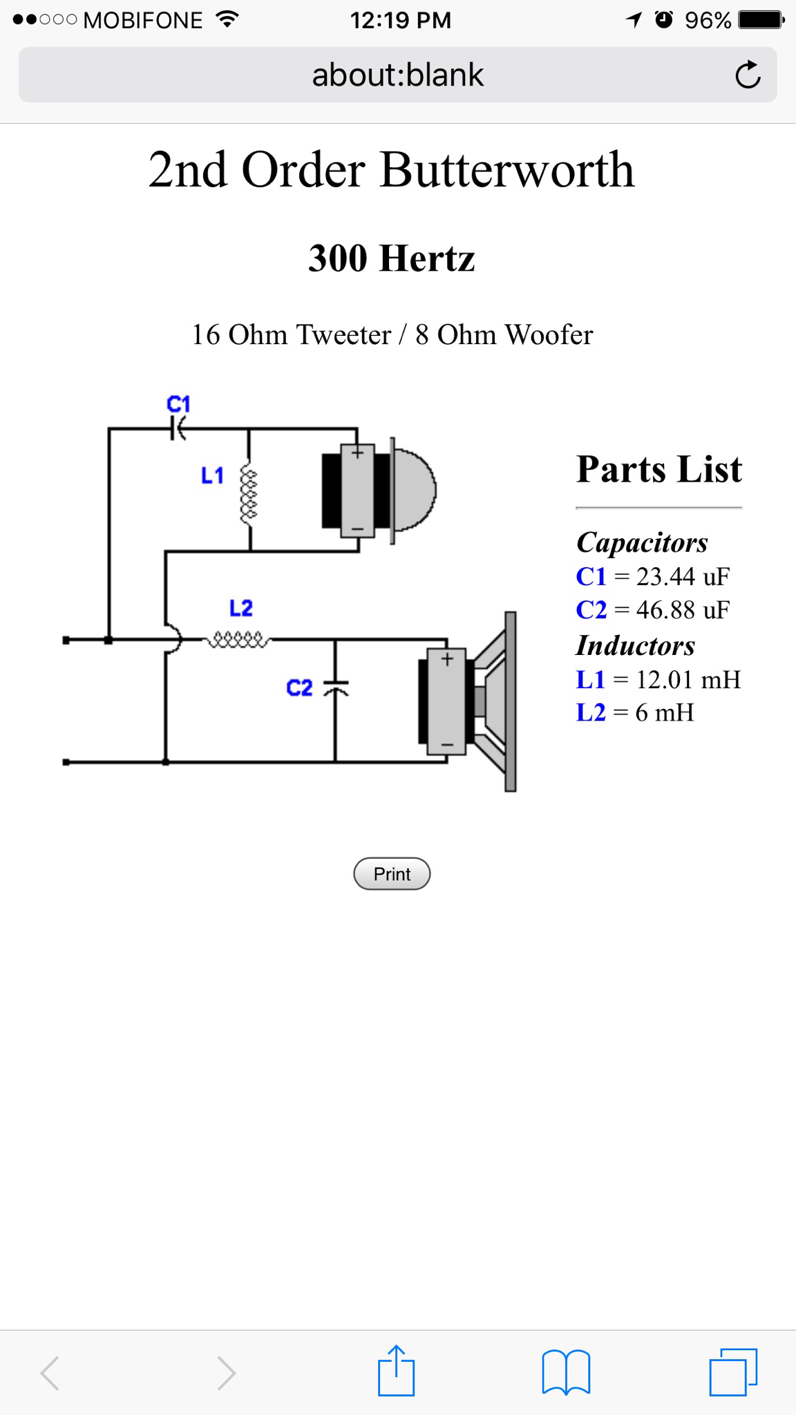

A friend also preparing the coil for the two way 300 hz crossover (JBL 2482 (16 ohms) and Altec 416 8B (8 ohms)
Such textbook-standard crossover values NEVER work very well with real drivers.
It would be a shame to impair the performance of this potentially very fine system by limiting yourself to such bog-standard formulas.
I advise measuring the unfiltered response first, and then designing a proper passive crossover aiming for the actual acoustic transfer functions.
Marco

Norelco, we've discussed this before and I also agree 100% with Marco - that is not even a good starting place. Unless you just want the most basic, not adapted, thing you can get. There is no need to waste money on such a crossover.
You'll need to measure, measure, measure and then use software to figure out your crossover. There is plenty of good measurement software available for free, and a decent measurement rig isn't expensive. You owe it to yourself and to the horns.
thanks Marco & Pano for the information and suggestion, i will do some research on how to do it, any suggestion regarding the software?
REW is the software to get, but it can be a little tough to learn. There are plenty of people to help with it, tho. REW (room EQ Wizard) runs on Windows, MAC and Linux. HOLMImpulse is also good by no longer supported. It's easier to learn than REW and has some nice features. Windows only. ARTA is very nice, but not free except in demo mode.
For the crossover work you can get XSim which was written by Bill Waslo, a forum member, or Jeff Bagby's PCD which runs in Excel. There are others, but those are the ones I use.

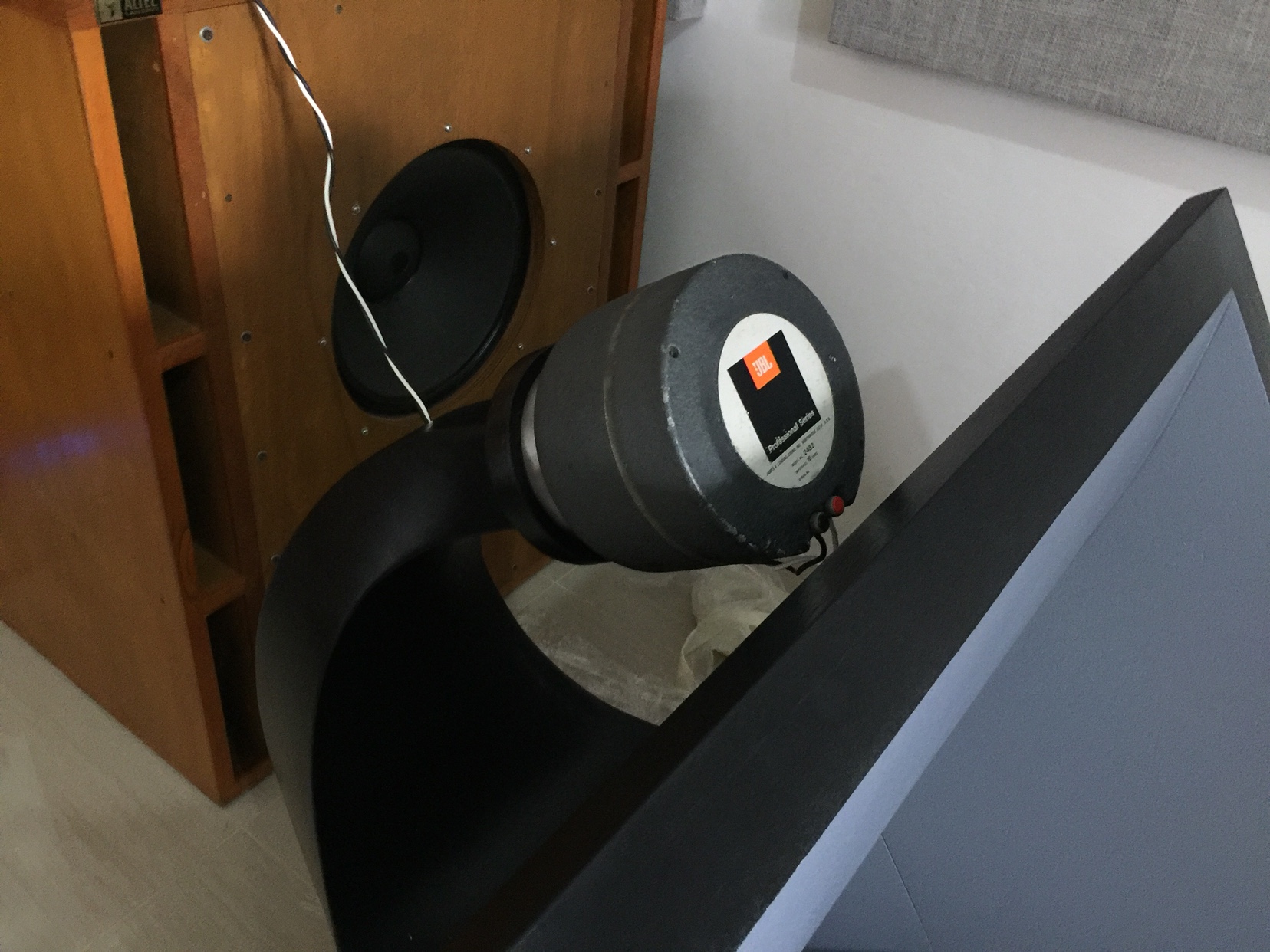

Hi Norelco.
Nice to see your Sato with your JBL 2" throat.
One question; how did you tech-solved the (smooth) transition between Sato-throat-(square)-2" with the JBL-(round)-2" ?
Karel
Karel

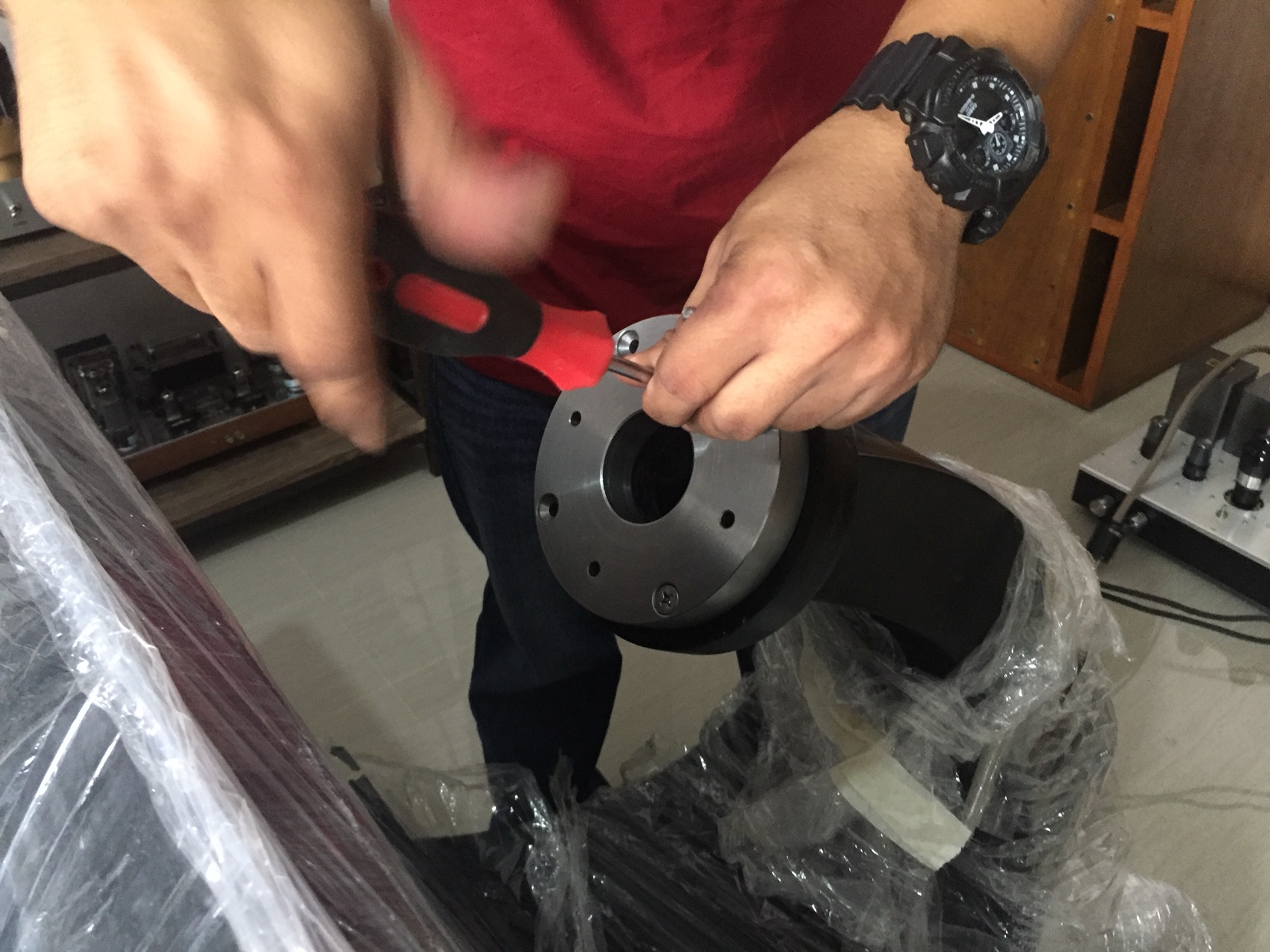

Hi
This photo will explain your questions regarding the translation between the throat and the driver.
Thanks,
But that's no gradual transition, it's just a plain extension ring.
There will still be an abrupt round>square change of cross-section at the horn throat, with a concomitant disruption of the expansion law... not good...
Acoustically Abrupt
The transition is acoustically transparent only until signal wave length becomes comparable to horn throat (and transition) dimensions; then diffraction will become acoustically apparent in system response at these and higher frequencies. This is also true for passage thickness in the horn neck bend as well. WHG
