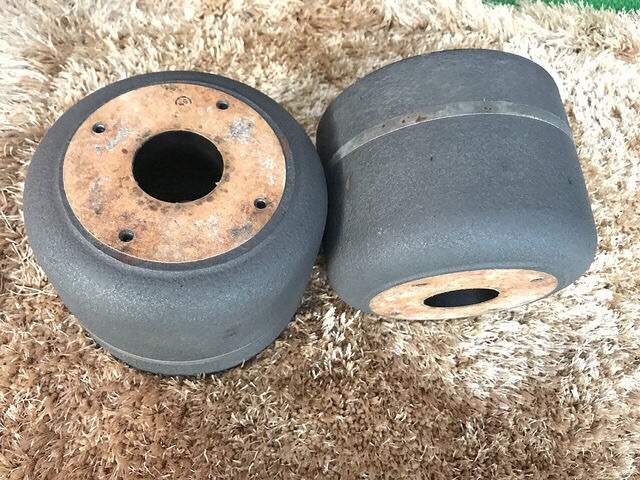

Thanks, that adapter belongs to the guy who make the horn, but he will lend me that adapter to copy, still undecided what material to use, aluminum, stainless steel or bronze. The horn throat are 2" so i can use JBL large format directly.. planning to buy and use it with JBL 2482 or 2441 later. But i will try it first with Altec 808 8b.

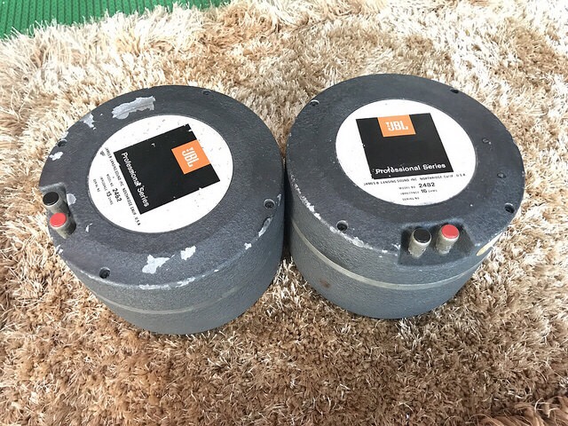

2482 versus 2441 (!) ....... The 2482 (& phenolic diaphragm) is one of the best choice(-s) with JBL.

Yeah, but still looking for a good deal with that driver.. [emoji106][emoji106]

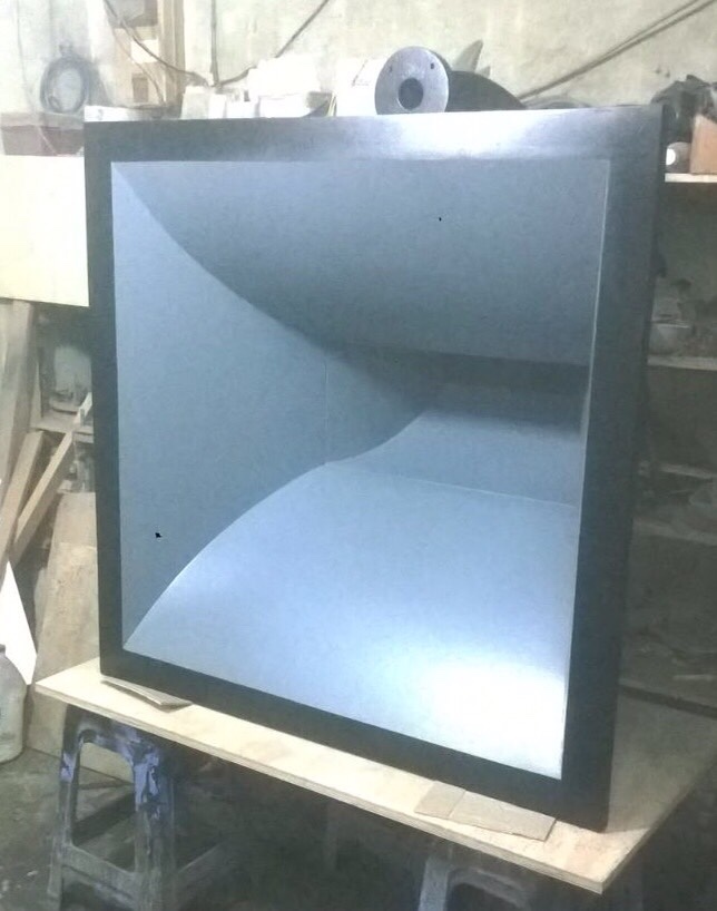

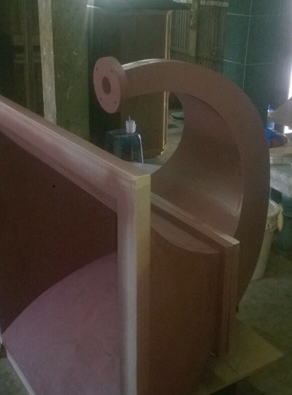

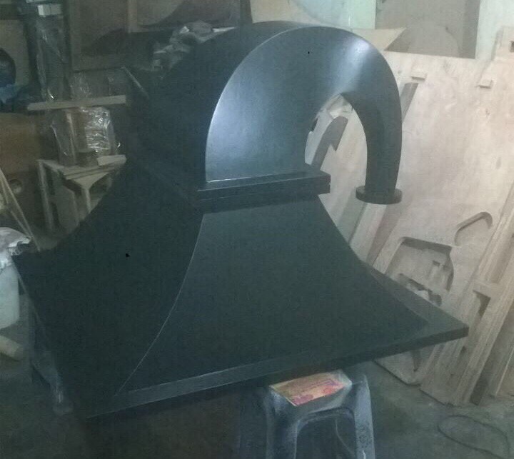

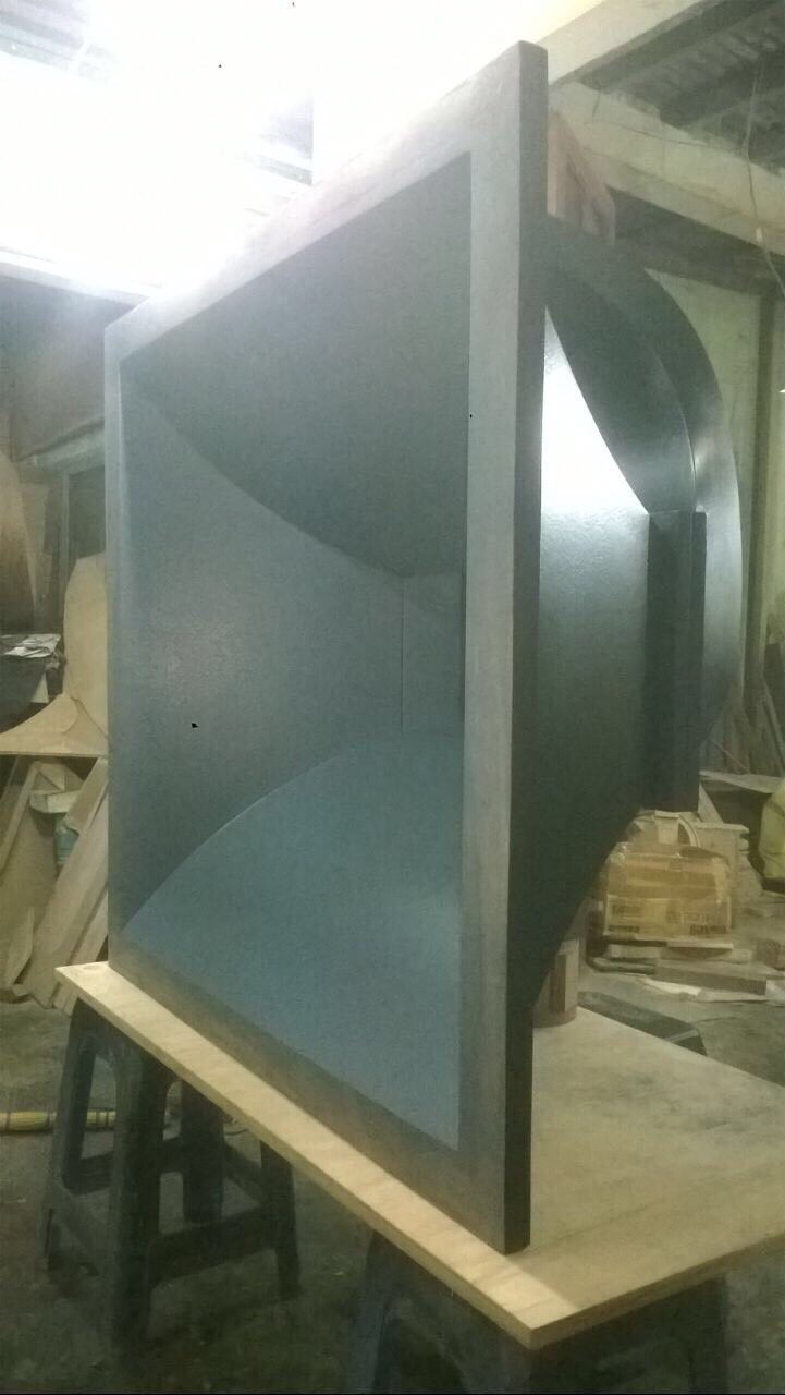

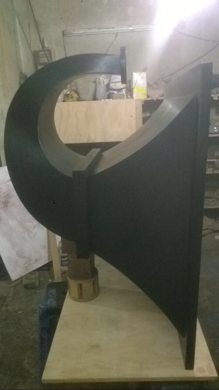

Yes, sealer for the 1st coat, then flat black (outside) and altec grey (inside). The builder suggested to use veneer for the finishing, but i decided to use paint.
...but i decided to use paint.

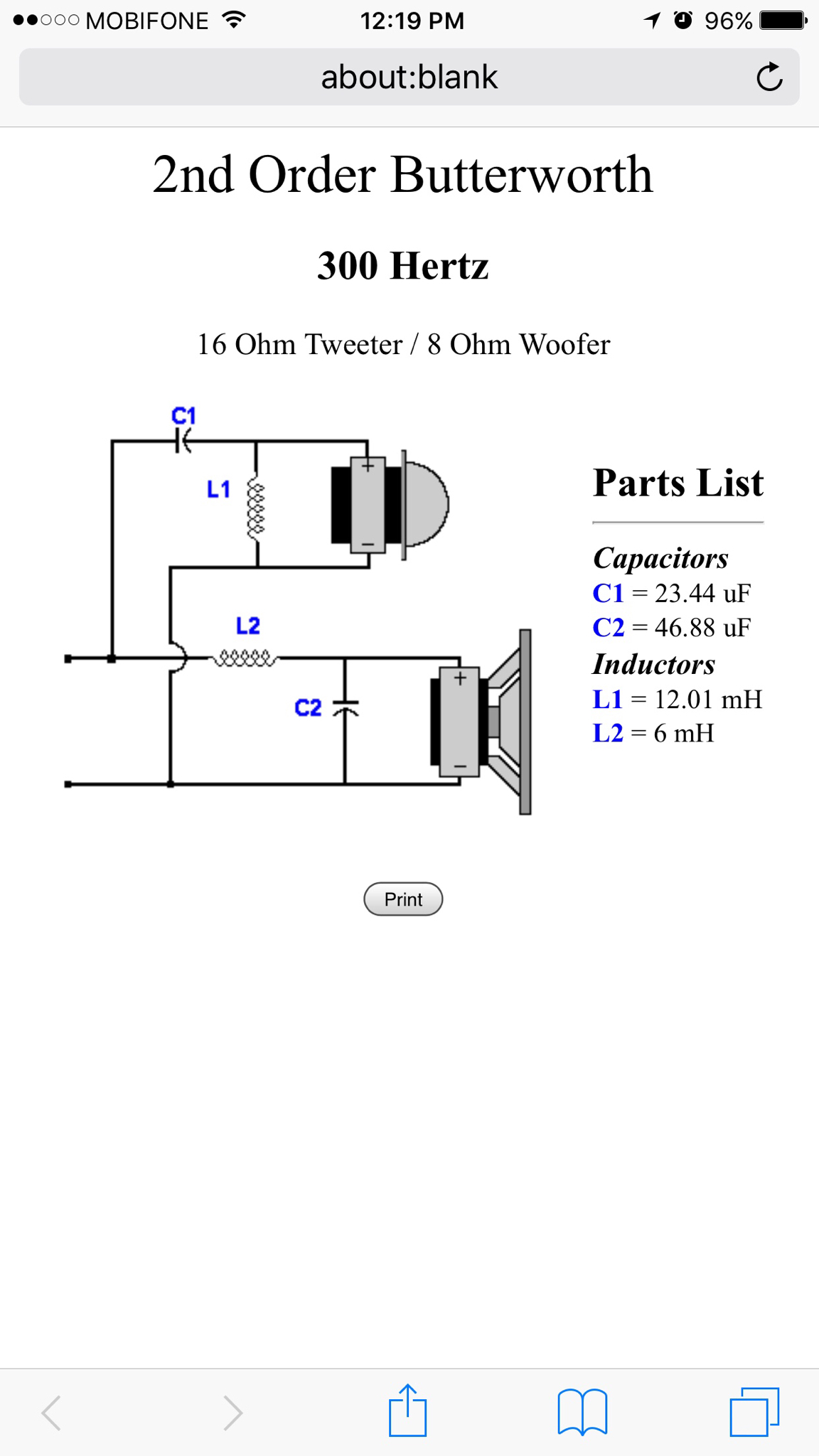

A friend also preparing the coil for the two way 300 hz crossover (JBL 2482 (16 ohms) and Altec 416 8B (8 ohms)

Some perso considerations:
* If good tuning ..... the Sato horn (& 2482) is inaudible .
A perfect acoustical tuning is a must (in symbiose with the low 416) ....
* It's opportune to provide a "Sato/WE66A cradle (on wheels)" for easy acoustical fine tuning. See; GM post nr 94, time alignment, polar energy distribution, depth/rotation, etc ....
* X-over, provide a good "constant impedance attenuator" for 2482 & 416
* Selfs X-over, if in home made, best is provide multiple outputs around your set value 12mH & 6mH (easy tuning !) ...
* probably you shall need a ... (good powerful) 3° way tweeter ....
* By (X-over) tuning, start with Fr response measurements "on" the (drivers-) connections ......
It's perso, tuning a passif concept "X-over / horn system" .... is a never ending musical story .

Thanks for the information, BTW I’m also using JBL 2405 to support the high frequency.

"I’m also using JBL 2405 to support the high frequency. "
2482 drops like a rock at 5Khz, 2405 will not work well that low (2404 will).
