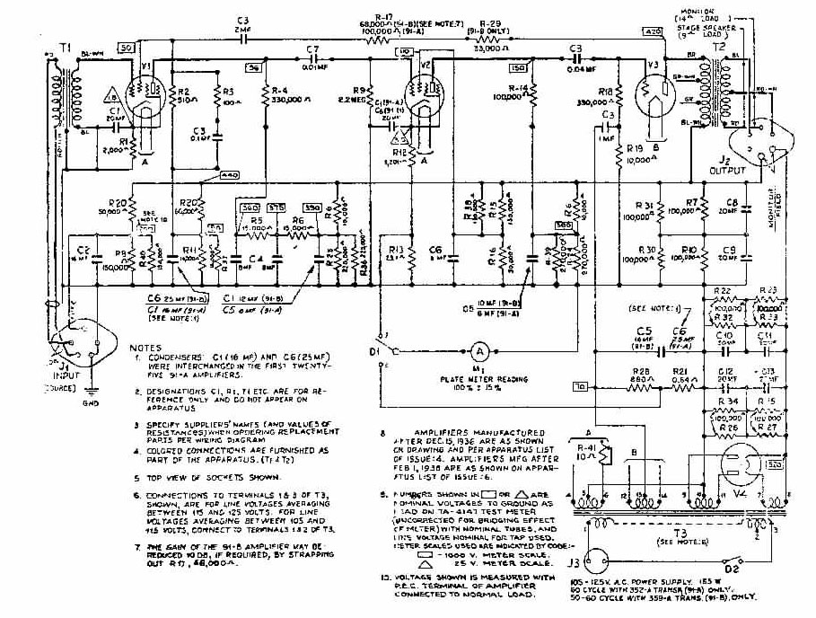

Hi- I thought I should post what Jack said about this question and about the circuit in general :
We indicated a 100ma primary when we thought you were talking about a SE 300B type transformer which is a 100ma primary, later you told us it was a
p-p. P-P's have two primaries, designated as a 100/100ma primary. No problem on these.
The primary/s current peaks are just that, peaks, the wire size is usually decided on as 70% of peak current. So since you did not, or do not know,
the real peak current, we assume that the 100/100ma should work fine."
"We never seen this one, but typical Western Electric engineering. We do know it’s capable of about 30 watts or less and was for a small theater maybe and is made for the standard limited bandwidth. It is a good circuit for its original use, it is not full bandwidth.
As for the NFB, there are three NFB positions, R3, is unbypassed, C9/R15 and C8/R14 are NFB loops. This is to control natural distortion of beam power tubes. Also, Yes!! You are right, they do not start loop from output secondary so output trans is not affected so all is fine with this transformer.
This is a very tight circuit so pay attention to voltages and resistor values on this. The parts controlling the highs are C7, C11, C12. R12 is an intermodulation distortion null adjustment, (IMD) and will need special equipment to adjust. You will need, at least, a Distortion analyzer (THD) to get all values correct as well as null. These were not production types like the other major brands in those days, each was most likely tuned to work with the combined chassis parts used. Your removal of some caps for increasing bandwidth on the highs, my alter other things. This is a serious project and test equipment will be needed to see if all works right."
I hope I am not in over my head. I will build it and have an expert help me tune R12 and pray that it sounds good. I don't like what he says about the circuit not being "full bandwidth" I assume he is speaking not only about the limited frequencies of the 171C output trans. but about the circuit in general. Does anyone have any comments on this?

From Naval Research Laboratory's paper "Laboratory Tests of Some of The Popular Audio Amplifiers":
"The Western Electric Type 124 Amplifier
This circuit (Figure 31) using the Western Electric Type 171-C output transformer has been used to some extent by "audio fans." The data (Figure 17) shows it to be a fair amplifier but is no comparison, for instance, to the Stancor transformer in the Williamson circuit at a much lower price."
Full bandwidth does not automatically mean "better sound"... can you improve a classic Ferrari, sure you can, but why would you? To make a "better WE" is missing the point IMO, I'm probably in the minority on this one...😀
Thanks for this vote of confidence. I have always been interested in Western Electric and I just want to do a fun project. I am not necessarily looking for the best amp (whatever that means) and I thought the 124 would be a good experiment with a classic good sound. I have a number of amplifiers already- Krohn Hite, quicksilver, dynaco, bogen, a few homemade single ended ones......but I have never even hear any W.E. gear and I figured this would be a good way to learn about it first hand. There are so many opinions out there and I have to be strong in order to feel like i am not making the wrong decision.

Can anyone tell me the function of the RC network across the OPT primary (C7 and C11---.004uf and R12---30K pot)? See Post #6 for schematic. There is no mention of this adjustment in the manual so presumably the pot was set at the factory.
Hi - Jack from electra print mentions what this part of the circuit does in his email to me. :
You might want to talk to Jack Elliano at Electra-Print, he can make a set of output transformers with 10K PP primary impedance and a single or multiple secondaries as you prefer. I have used his output transformers in a couple of my projects and am very pleased with their performance.
He is not too expensive, and you could spend much more and end up with something not appreciably better.
Other possible options on the vintage front would be UTC, Chicago, Acrosound, etc..

Kevin- I have decided to go with one of Jack's outputs . But I am having trouble deciding what secondary impedance configuration I should choose . I currently have large 4 ohm speakers and I would like the amp to be able to run 8 ohm as well. but Jack says a single primary is better.....recommending 6 ohm as a compromise . I would like it to be like the 171 with a 10k primary. I am nervous to commit to one secondary because I don't know that much about this stuff. Here is what he said:
" As for the secondary impedance/s, if you got a 4 ohm only, you could use it on 8 ohms, little loss in power. But if was 8 ohms to a 4 ohm speaker, it will load down output tubes and distort. Tubes do not like lower impedances on them, higher is OK.
The 6 ohm secondary is made with a slightly higher primary so the 4 ohm will not load down, so the 6 ohm design is a 4 and 8 ohm compromise.
Your word “strain” can describe the lower loading and distortion of the output tubes.
The single secondary is the best bandwidth due to not having unused wire in the coil when used at 4 ohms."
Do you or anyone else have any advice for me. He says it is up to me.
You are right about this . He thought i wanted a single ended one. He says he can make a push pull that will handle the potential currents no prob. because there are two sides to the primary winding. It is a non issue.It doesn't sound to me like you told him it was a push pull transformer or he didn't look it up. He refers only to his SE line, and if that is all he makes now then I understand the confusion..
A 10K push pull transformer handling several hundred mA of plate current should be a none issue, and you do not need all of the secondaries anyway.
I was able to glance at the innards of my friend's pair of 124E and noticed that those parts don't exist in that version. His amps do not appear to have been modified. So I take it they are not essential to the circuit. Parts R18 and R19 are also not there. In a DIY project, I guess they're not necessary, given one will use different output transformer. It is then a pretty straight forward design.
My only question to members here is that is C10/.05μf value high enough to negate the function of the feedback since it's connected to input 6J7's screen-grid and ground? What does it do, really? In one of my friend's amps, it does not even exist!
Hi - Thanks for this info. I was worried about how I was going to adjust R12 potentiometer. Here is what Jack Elliano from electra print said about those parts:
"This is a very tight circuit so pay attention to voltages and resistor values on this. The parts controlling the highs are C7, C11, C12.
These were not production types like the other major brands in those days, each was most likely tuned to work with the combined chassis parts used." I posted this before.
