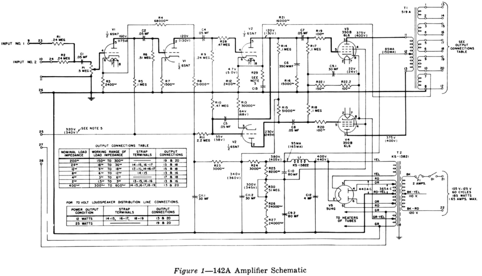

Western Electric 124 amplifier
Presumably to damp the primary windings. (Stability and to improve square wave response?)
I agree. The leakage inductance of the OPT windings will raise the impedance seen by the tubes, increasing their gain and thus reducing the stability margin of the feedback loop. The RC functions as a sort of Zobel to cancel the OPT reflected load resistance plus leakage inductance. Since the transformer is not perfectly symmetrical, the pot allows optimization of high frequency performance.
My story would sound better if I had any idea what performance was being optimized! Probably a service manual would give a clue, if one still exists.
The dual feedback loops to the cathode and screen grid(!) of the input tube are very unusual.

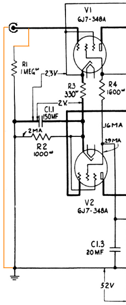

Re Post 6 screenie
I'm not an valve expert, or any other :D but shouldn't R1 go to the V1 input & the input ground connection go to the circuit ground ?

FWIW, IMHO the 124 is a much more interesting circuit than the apparently later 142...
shouldn't R1 go to the V1 input & the input ground connection go to the circuit ground?
You are, of course, correct! Sorry, innocent mistake. Here's the repost of schematic:
The other circuit that's similar to the 124 is the earlier model 118A that is 6L6 parallel push pull and it uses two 6J7's as driver circuit but it uses the 618C input transformer as phase splitter. It's a lot more symmetrical and to me more appealing. Never heard its sound so I can't compare. What's curious is that one pair of 6L6's don't have grid stoppers. :scratch2:
Another interesting WE amp is the 133 which also uses a pair of 6J7/348A drivers but with 349A outputs. It has similar feedback from the plates of the output tubes back to the cathodes and screens of the the input/drivers, but in the 133 the feedback loops are symmetrical. The 133 uses the input transformer for phase splitting instead of the 124's floating paraphase.
