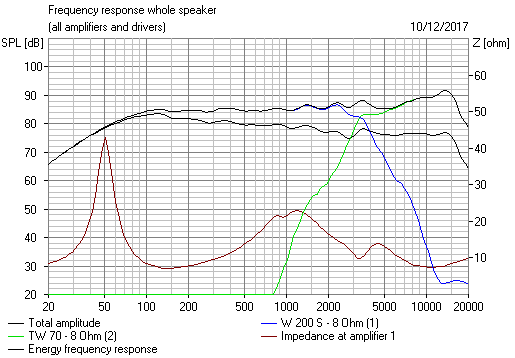

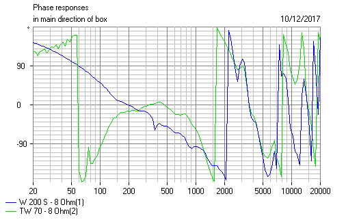

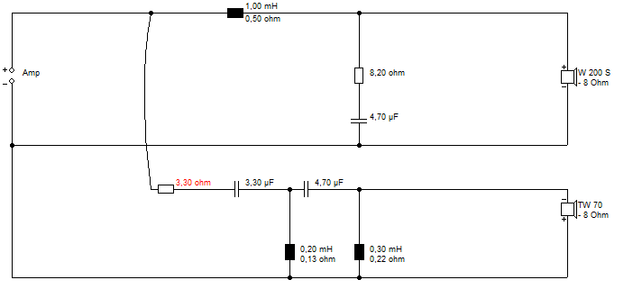

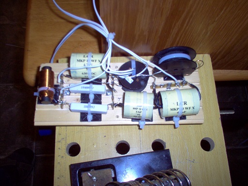

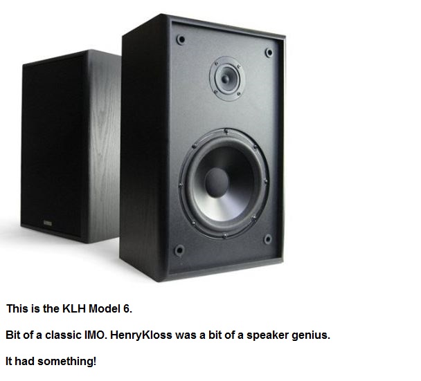

I think the first thing is to have a good idea. This is a much loved design by Henry Kloss, one of the audio greats:
How hard can it be to do this sort of thing?
I just took a good and successful idea and applied my filter knowledge. Shallow filters are lively enough, but they distort. So, unlike Henry, I used a fourth order tweeter filter here with not too much bass boost. There is a fantastic trick applicable to 8" bass which solves a lot of problems. Flip the polarity.
TBH, this was my best effort with the narrow-dispersion Monacor HT-22/8 tweeter, which has a flatter response than the Visaton TW-70 which I used for modelling purposes. Very clean sound at the top with a serious filter. Very LR4. Well-behaved 8" woofers are much of a muchness IMO.
Trust me on this, 4th order sounds very lively and detailed. I regard minor level adjustments as easy enough. Just trust your ears.

I guess you proved BYRTT's point, more data sheet crossovers...
