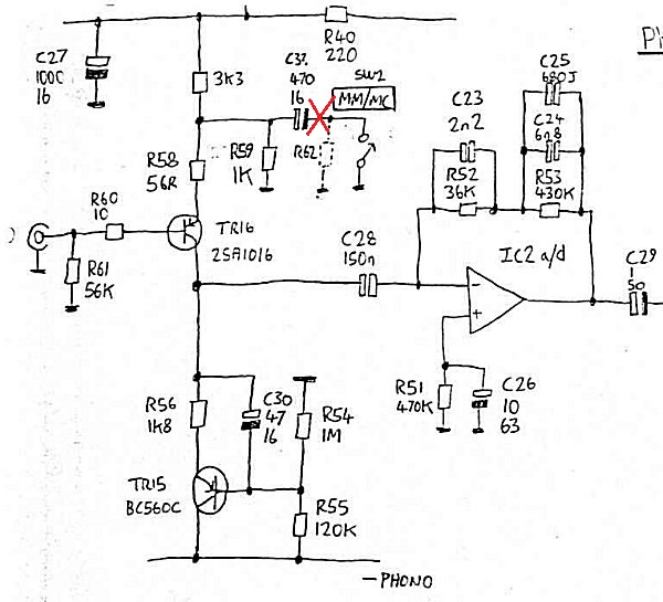

OP, is this the correct circuit? https://www.markhennessy.co.uk/showpic.htm?mf_a1/a1_phono.jpg
Yes, the circuit is that one, AFAIK.

At least in the A1X, the dotted R62 was not there, I think. Not bypassing the cut would also mean MC not being supported anymore, I think.
I think this is artificially increasing the "inductance", but after consulting all the information on MF A1, the PCB only cut one of the channels, so it is obvious that my idea is not valid.
I still remember that after cutting the green wires, an additional resistor was soldered to one end of the green wire to increase the voltage gain (only for MC operation for cartridges with unusual output voltages). However, the other end of the resistor had to be soldered not directly to GND, but via an Elcap in order not to change the DC conditions.Hi,

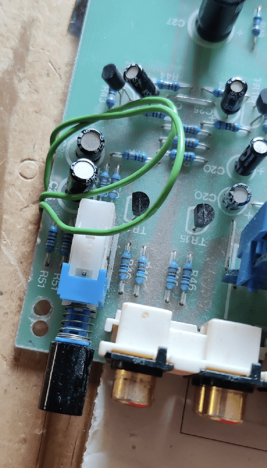

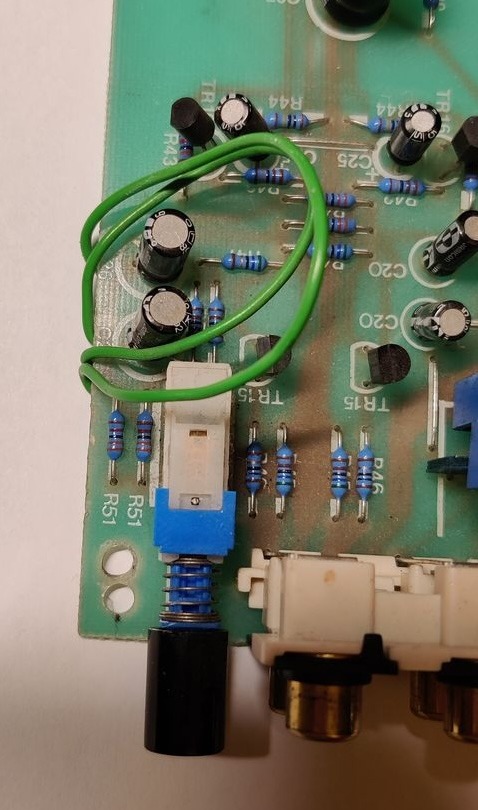

does anyone know what the two wires in the Musical Fidelity A1, B200, and other amps from that period are supposed to be for?

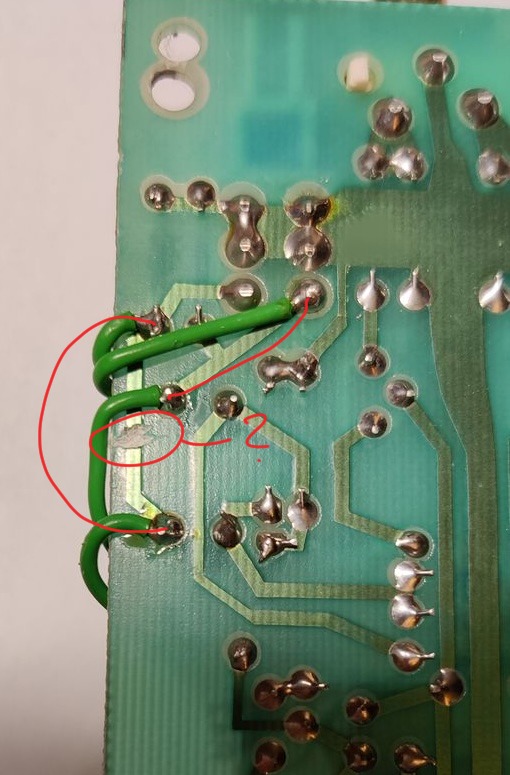

If I am not completely mistaken, the cut track is just reconnected with one of them, and the other wire is just in parallel to another (uncut) track.
This is the 2nd amp I see this "in person" on now and searching the net for pics of open A1s etc. shows this is "normal".
The tracks are both coming from the MM/MC switch.
Any reasonable explanation?

Without the Elcap in series, it was possible to optimize the DC condition by changing the gain-determining resistor, but then the gain had to be brought to the same value on both channels with another RC series element (i.e. an additional resistor and Elcap).
The reason, why on one channel the cut track is present, and on the other channel wire is an uncut track, isn't to understand for me.
The question is, what channel show the mistake.
Uncut track means, the gain-determining resistor cannot be became a higher value after perform the above mentioned steps.
P.S.: part No R and C in the schematic in post #22 and on the image of showed PCB are different - for the voltage gain stage for moving coil cartridge the parts in the schematic are C32 (470uF) and R59 (1K) and on the PCB from image are C26 (not able to read value) and R51 (1K1).

Someone at Musical Fidelity must have thought these were useful. This is a B200X I have on the bench right now 😝 . One PCB track cut and replaced by one of the wires, the other wire in just in parallel.
Exactly the same as on the A1 above.
