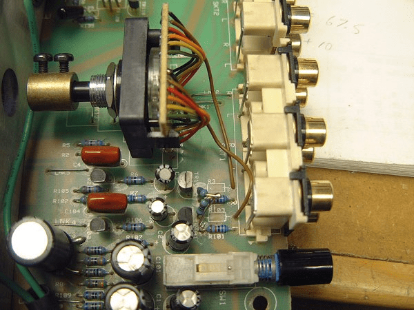

does anyone know what the two wires in the Musical Fidelity A1, B200, and other amps from that perdiod are supposed to be for?
If I am not completely mistaken, the cut track is just reconnected with one of them, and the other wire is just in parallel to another (uncut) track.
This is the 2nd amp I see this "in person" on now and searching the net for pics of open A1s etc. shows this is "normal".
The tracks are both coming from the MM/MC switch.
Any reasonable explanation?

Can you show us on a schematic where these are?
With current info: Could it be some weird-*** attempt at "humbucking"? How close is the power transformer? But I doubt it does even that, I think this does nothing at all.
And you say you've seen this seemingly pointless mod in multiple units? That's a head scratcher.

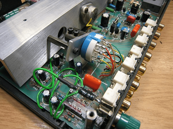

Maybe, but if you look at the picture, you will see that one of his mods uses EXACTLY the same green wire as you show in your picture. Kind of difficult to accept as coincidence. And I doubt that MF was so sketchy a company that all they had was 1 spool of green wire.

Weird indeed. How sure are we that all those online pics that show this are not from just one amp?

It definitely are lots of different amps. The first one I had this myself was an A1X (see https://www.diyaudio.com/community/threads/repairing-a-musical-fidelity-a1x.404761/post-7490057), wires were red in that one. I thought this was strange, fixed the track and removed the wires. Of course the phono amp worked after that.
This time, I have it on an MF B200X currently on the bench.
And the pics you can find on the net are from all over the word of diff devices.
