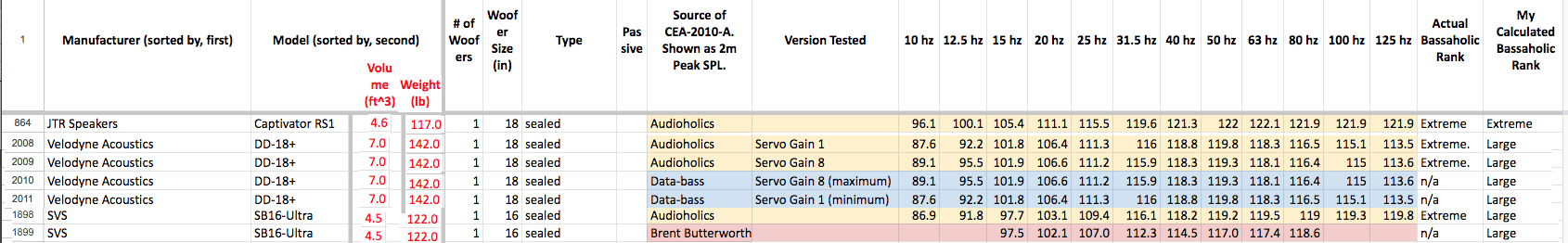

Sweetchaos has compiled a list of various subwoofers and their output.
https://www.audiosciencereview.com/forum/index.php?threads/subwoofer-comparison.20494/
"How do you judge a subwoofer's performance?
Read the 'flowery' words on the manufacturer's website?
Listen to the personal opinion of owners who sing you songs of their subwoofer's performance, regardless of their actual performance?
Watch some random YouTuber talk about how "good" a subwoofer is, not realizing that he probably got the subwoofer for free, in order to do the review?
Read some ad-copy on some random website you found, that just lists the specifications and shows an affiliate link at the end?
None of the above! 😉
Instead, we need a consistent way to compare two subwoofers to each other.
That's why international standards like CEA-2010 exist."
What is CEA-2010?
CEA-2010 is an industry standard first published in 2006 (updated as CEA-2010-A in 2012) that specifies a method for measuring subwoofer's maximum SPL (before subwoofer distorts) at various frequencies.
https://docs.google.com/spreadsheet...fyBjaxK69dkXte6ZL6anVTW2_M/edit#gid=834598950
Velodyne Acoustics uses a specially developed accelerometer to "perfectly control diaphragm movement".
After 35 years in business they may be near the top of the servo-feedback field- certainly a bit farther along than most "DIY" examples.
The Velodyne Acoustics DD-18+ subwoofer at 7 cubic feet and 142 lb has a bit more low end potential but less upper potential than the lighter, smaller (4.5 CF, 142 lb) SVS SB16-Ultra.
The JTR Speakers Captivator RS1 (4.6 CF, 117 lb) has 7dB more level at 10Hz, and 8+dB at 125Hz- it would take two DD-18 occupying 3 times the space to equal one JTR RS1.
Considering the the JTR RS1 is going for about $3300 compared to $4775 for the DD-18, quite a bargain.

Something I've definitely seen as a reoccurring theme in that list, and frankly during a lot of this research into low end:
1) higher end typically does have some sort of DSP or at least much more granular control
2) the smaller you go, the more laws of physics you need to account for, and the more you need to compensate for them
