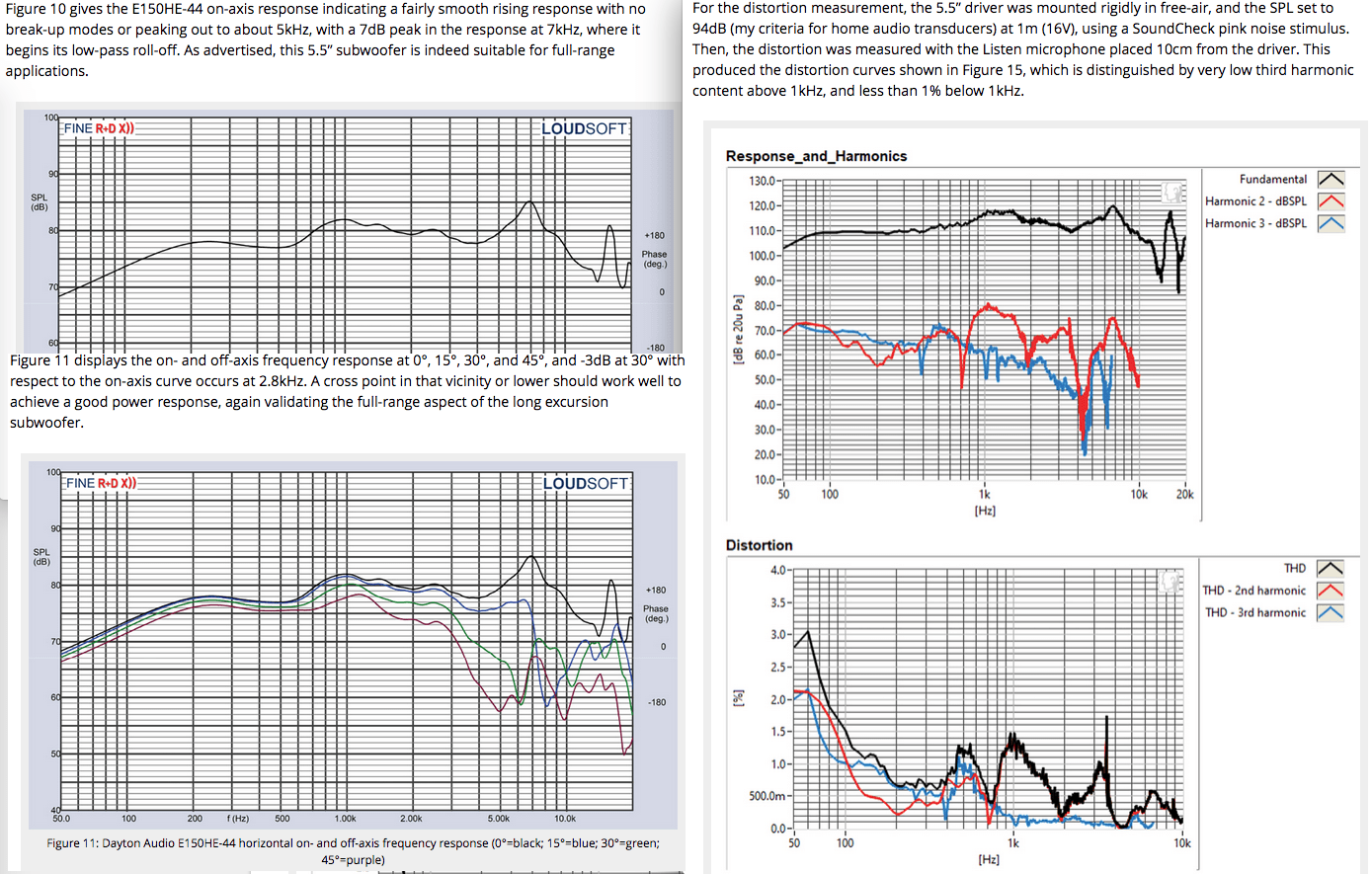

Probably not feasible for the Epique E150HE-44, as the primary magnetic drive is provided by the rear ring magnet, directly providing flux to the second rear 7mm gap. The secondary magnet system does not add flux to the upper 7mm gap, but rather acts as magnetic “diodes” (aka gap balancing magnets) pulling the flux from the main magnet into the top 7mm gap.I wanted to try using one coil to cancel out the nonlinearities of the other. To do this, I would use a transformer to act as a comparator, then reverse the polarity to the second coil, thereby acting as an error signal. Is this a feasible way to use a dual coil subwoofer?

The driver has good BL (magnetic) and KMS (suspension) symmetry. If you wanted to increase symmetry further, using an external differential pressure sensing device like the Powersoft/B&C IPAL (Integrated Powered Adaptive Loudspeaker) system uses would be a better approach than using half the drive circuit as a comparator/corrector, which would probably generate more nonlinearities than it could correct.
That said, with as linear as the E150HE-44 is when used within it's design limitations, any sonic improvements gained by cancelling nonlinearities are going to be pretty small compared to the expense required to achieve them.
What specific nonlinearities are you finding need correction in the E150HE-44?

Not a specific one per se, but during my time researching for this little DIY of mine, I came across some literature about bending wave speakers. Between different reading, it reiterated that the speaker cone is always the weakest link in terms of adding any kind of harmonic distortion. I figured if I could smooth out its top end a bit (specifically from about 300hz up where it starts to break up), I could turn my design into a 2 way instead of a 3, cutting down on parts and maybe even making room for something else.What specific nonlinearities are you finding need correction in the E1E150HE-44?

https://audioxpress.com/article/tes...e-subwoofer-from-the-dayton-audio-epique-lineBetween different reading, it reiterated that the speaker cone is always the weakest link in terms of adding any kind of harmonic distortion. I figured if I could smooth out its top end a bit (specifically from about 300hz up where it starts to break up), I could turn my design into a 2 way instead of a 3, cutting down on parts and maybe even making room for something else.
There is no breakup until around 5kHz. The frequency response can easily be corrected with DSP, and the polar response is good to a crossover in the 2500Hz range, easily in two-way territory.
At 94dB at one meter, free-air THD between 100-3kHz is under 1.5%.
You will be using a lot of parts to try to reduce that by any audible amount .

The audibility threshold for most people that took the test was above the amount of distortion the E150HE-44 has at 94 dB at one meter.
