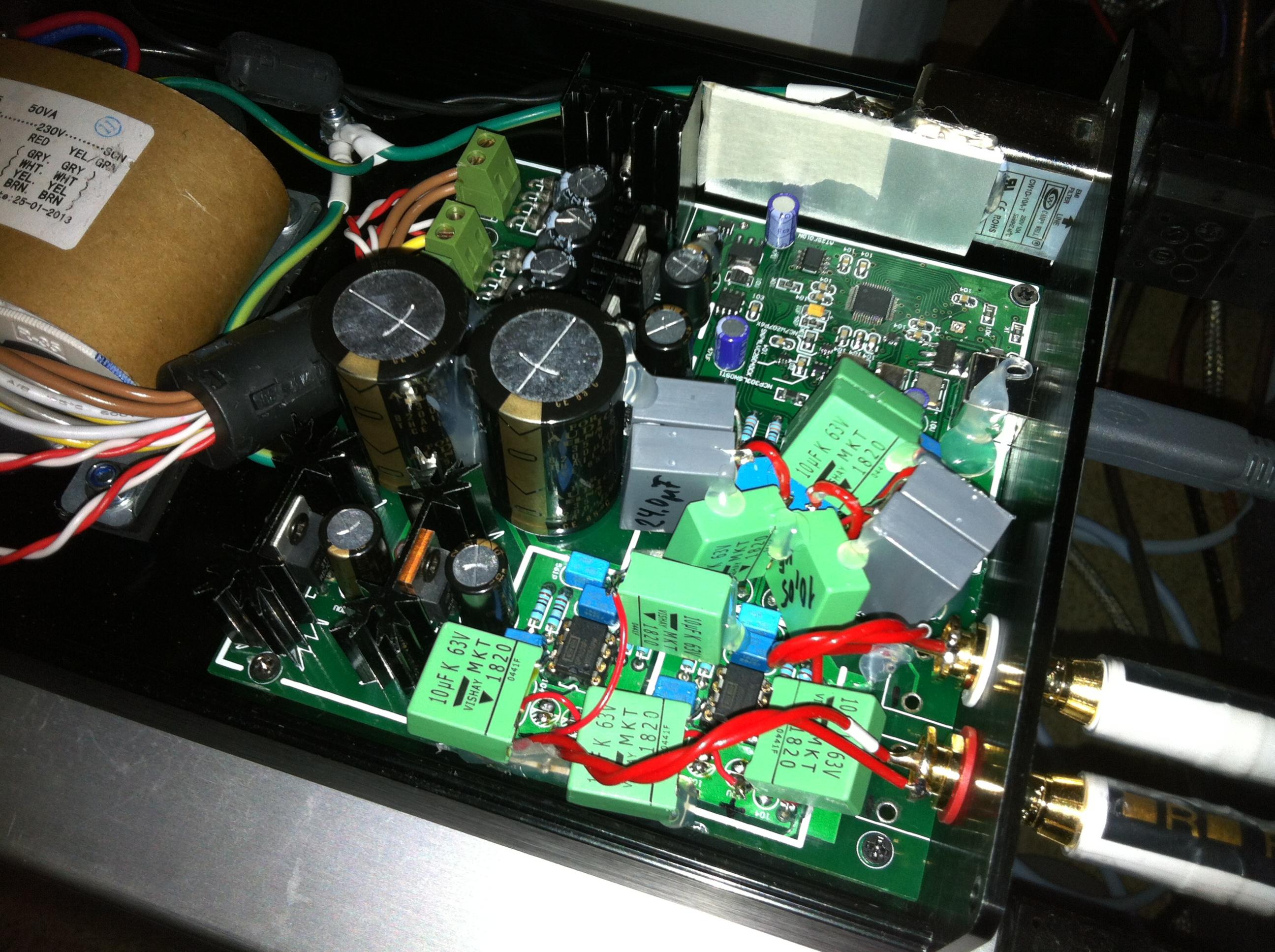

I replaced all analogue/digital decoupling caps from cerafine/silmic (opamp n dac) to ero mkt 1820/63vdc -small enough to put close and soldered them directly to pins bypassed with ero kp1830 0,1uf and ....... Wow... Never again a electrolytic. Sounds so "real and analogue" this is by far the best mod i've been doing on this card (ak4399+is2 xmos)
Yeah! Thx. I consider Ero caps one of the best. All caps around opamps is ero kp1830 too. (220/680pf) little more open then wimas fkps that was original caps.
Also all cerafines that were red i replaced to newest black cerafine= better low and more low freq. Im also gonna try to replace all 220uf/100uf after LT1085 reg for ak4399 psu with arcotronics r60/r75. It tronics in germany is the one to get cheap film caps from. Check ebay.,
Maybe a pic?
Looks a bit messy but works really great. Very musical and engaging sound now with lots of depths. Electrolytics sounds grainy and stiff, doesn't matter the brand or quality!
Not included in this pic is the 4x 10nF bypasses (Ero kp1830) for opamps that I added. Tony Gee's tip also is included for caps decoupling i can hear clearly. They are staying.
Max, are you aware that those film caps are so big that the added inductance of leads impair their decoupling effectiveness?
If you want to follow the film caps path maybe you should try Wima MKS2XL (5mm lead spacing)
Yes, i'm aware that is not "perfect" but anyhow it sounds that much better i can live with it. I did the best of the situation and these caps cost me almost nothing.
Original the caps are also located to "far away" to be effective.
Thx for your maybe one day i'll try those wimas.
This could have some merit for the opamps, you should try a 100nF 5mm LS decoupling cap between opamp's rails (direct on pins) and remove elcos at all... it could work pretty well with stable opamps.
But for the AK4399 you need real decoupling, those big, chunky film caps there are useless, worse, detrimental... put back the original caps, they're pretty good for the job.

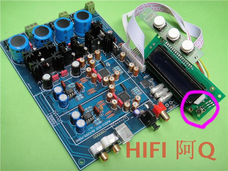

Dual Mono AK4399 kit with LCD Display
Is there anyone interested with this dual mono AK4399 dac kit? Sellers say it has volume control feature via 3 buttons panel. I also see a IR remote control receiver near the LCD display. That thing leads me to think that kit a has remote control feature, but I'm not sure. I asked one seller but he said no. A bit confusing. I have to to ask actual designers.
worst case, you can wire up a separate ir receiver and controller (I prefer arduinos, lol) and have that trigger the 3 push buttons. its a bit indirect but then again, you'd have access to the source code and can have the IR system do other things, to other boxes in your stereo.
you'll never get source code from ebayers in china. it seems counter-cultural for them to share. I hate saying it, but its true. they don't even want to give schematics away, its like pulling teeth, asking them for one after you bought their gear. I really hate that ;(
