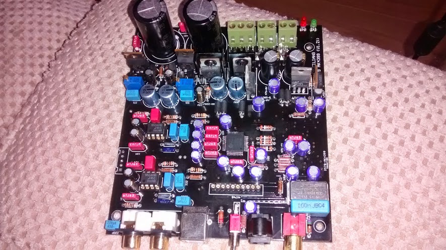

The LME49710 is a direct replacement, no mods to support it.
The first things to replace are the PFRs (blu boxes) and the green EROs, along with the Samwha smoothing caps (unless the vendor changed brand)

Hey guys, what are you using for a power supply? I might pick this up with case and do upgrades on it later.
I ve got board now.
It is version 1.2 , with evox pfr caps.

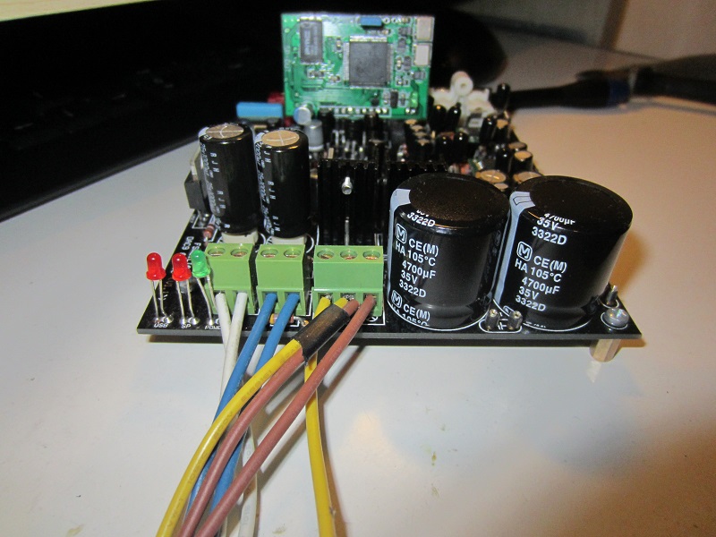

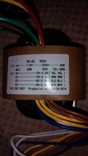

How to wire transformer:
Mains, 4 wires : 0 (blk) 115 (grn) 230v (red) SGN (yel/grn)
And secondary: 2 white (0v 9v) 2 yellow (0v 15v) 2 blue (0v 9v) 2 brown (0v 15v)
I ve seen wiring pic, from left to right: 2 white, 2 blue, 2 brown , 2 yellow
Question- with each pair there is no difference, which goes left or right ?
Thank you
Each pair (same color) is a secondary.
For 15-0-15 input you should use brown, brown/yellow tied together, yellow.
Just for sake of security measure AC voltage between the brown/yellow and brown and yellow, you should read 15Vac each time.
Looks like black is neutral, green to be wired together with red to get 230 and sgn is ground?
No, for 230V operation green must be isolated, black neutral, red phase.
Yellow/Green is transformer's screen and should be grounded.

You should measure 30V AC end to end. If not, one of rail is out of phase. To make them in-phase, just switch one of legs (brown OR yellow) for making 0V. Then you should measure 30V rail to rail.

Question:
I have enclosure ready for another dac, and all cut outs already in place, except usb.
Can I use existing receptacles (rca's not a problem, I know)?
I mean, if I use toslink receptacle from twisted pear: TOSLINK Optical Input Module instead of existing, or I can lift existing and wire remotely (it might fit existing cut).
As well, I d need to do do the same with usb (for instance PX0447 - BULGIN - MINI USB TYPE B, RECEPTACLE, PANEL | Farnell UK )
And on top of the things I would like to place spdif switch on front panel, for easier access, but wires will be long. Will it affect sound, or interference risk ?

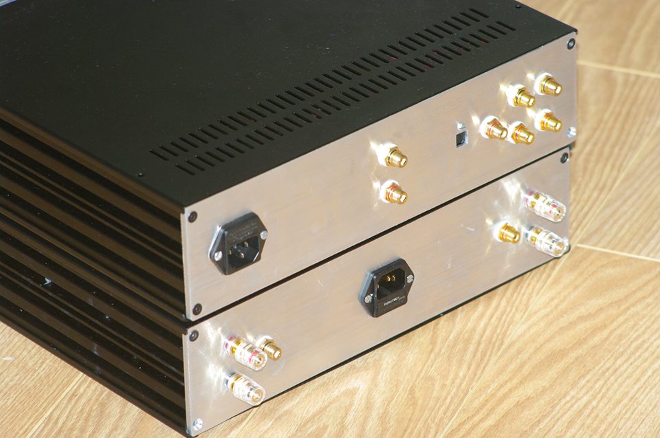

It is 330x280, galaxy enclosure from modu shop, italy. It is partially vented. Another device in there is small pre board.
I ll keep usb in place, just use panel mount receptacle and short usb cable to it for now.

Re front panel switch: you can see there is a hole, I can use for switch, but it means running wires back to front (in current setup it will have to cross mains wire 90' once, so I ll possibly redo back and move iec to the other side).
Possible solution is to use relays to switch signal?

I wonder if the relays that would be good for replacing that switch would fit in it's place?
Would seem to be better than running coax all over, maybe.
Can you manage the room to ba able and partition the transformer in a separate chamber?
Possibly yes. But I think I ll just ask my friend to do new back panel. This way iec and transformers will be far from signal wires
