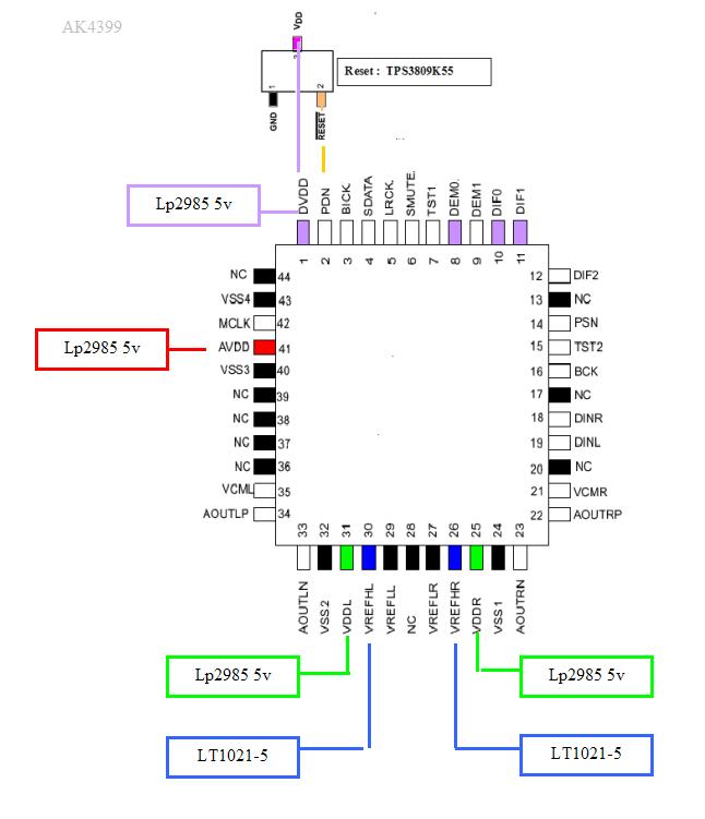

about a AK4399 with local regulators .
A regulator for the Digital DVDD
A regulator for AVDD
A regulator for each channel VDDL and VDDR
.....for the VREF !!!!
A four layers PCB .....
Cms components ......

I was going to build the red baron dac had the salas shunts laying round thought i should use them on dac 9 i took out two regulators that supply 5v analogue and digital supplies directly to dac chip totaly bipassing the onboard power supply and use my own i2s mod also instead of the one that is meant to slot into this pcb. Also i dont use the opamp section i am using direct output from dac chip, these are my preferences so these choices may not suit you.
