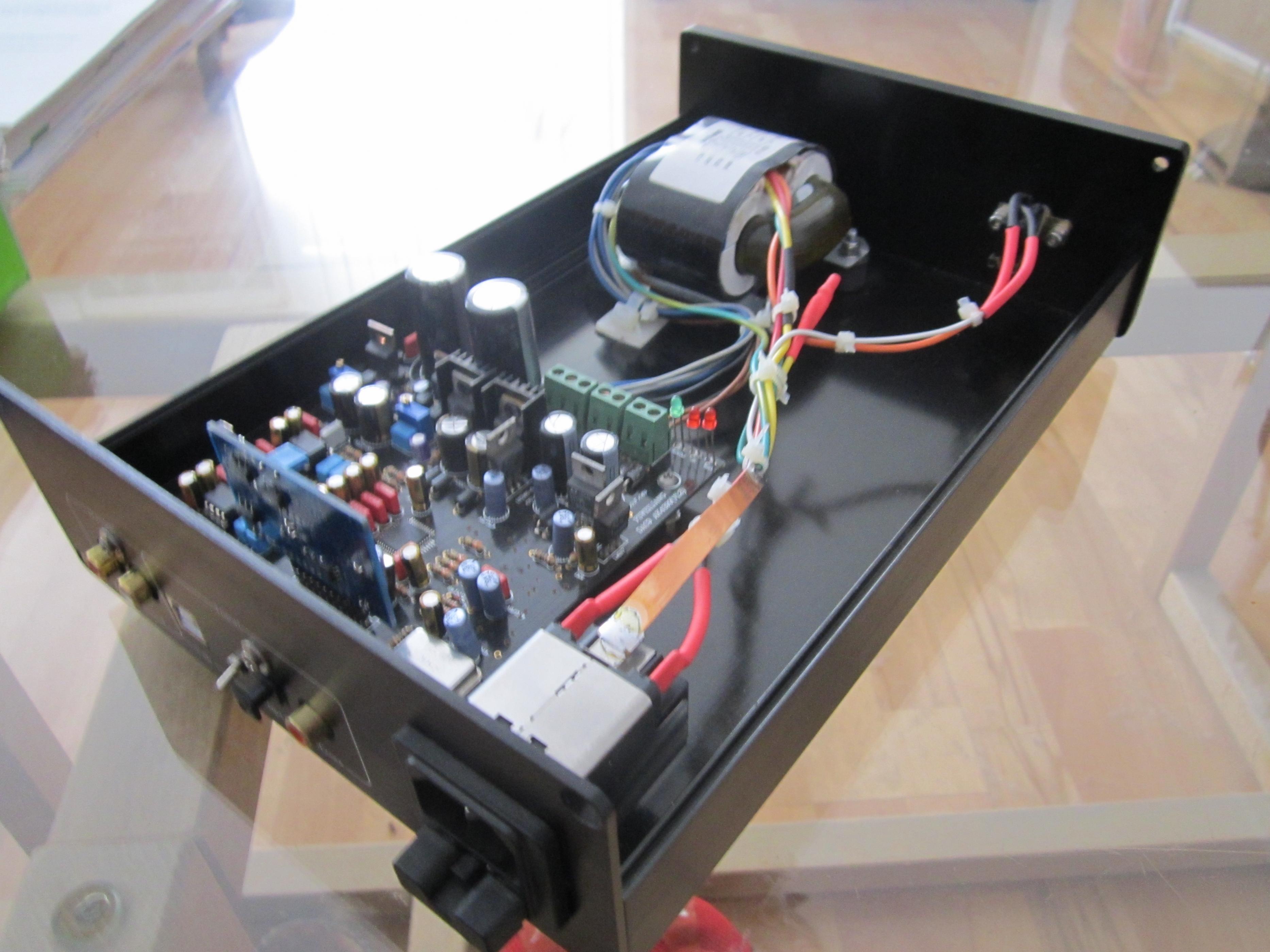

I finally bought the dual AK4399 DAC with an r-core transformer from minishow at ebay. He has answered all my questions promptly and I'm very confident about the purchase. I hope to receive the package soon, he provided me with a tracking number, very convenient.
I'm also interested in the dual AK4399 implementation.
Let us know how you like the DAC. Any comments on parts quality will be appreciated.
Hi Jaffar. I keep you informed, just received the DAC from China. There's another thread discussing this particular DAC also:

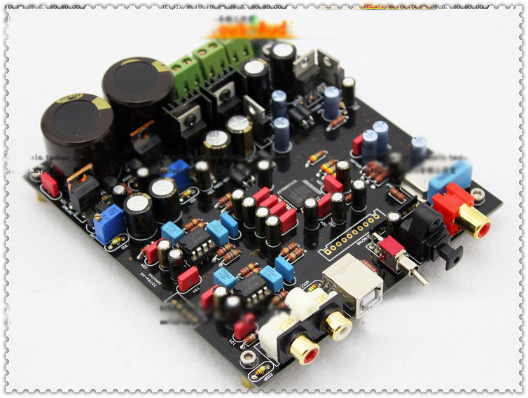

Hello, DAC9 needs 10 pins USB module,
and they are different direction
Chip of CM6631A on the module need to face to chip AK4399, your picture is correct.
but if you upgrade to XMOS in the future, chip XMOS on the module need to face to usb socket on the dac9
hope can help you
Is this DAC9 or some similar device ..
Does anyone have a schematic for some of them, or both ..
Hello,
the picture is DAC9 , but please note some sellers copy my board, such as I never use red color pcb, they are different quality PCB and components
please be careful, hope can help you, thanks
