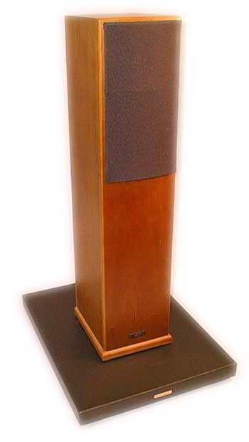

I read an article in Hi-fi Choice a while back and there was a product called a Townsend Seismic Sink (or something like that), which was a couple of overlapping steel trays with an air bladder in between them. On a concrete floor the reviewer said that the sound was not bad, but it really came into its own on a suspended wooden floor. So that might be something to try - put the speaker on a heavy slab sitting on top of an air spring, which could be a bike inner tube inflated to a suitable level. The whole arrangement would be like a mechanical low pass filter. The only problem that would need to be solved would be stability, so that the whole arrangement doesn't rock too much.

Do you mean <a href="http://www.townshendaudio.com/products/speakerplatform/speakerplatform.htm">these</a> Mick.
I've never used them myself, but have heard some good reports in some instances. might be worth a DIY effort like you described. I've seen similar DIY versions using air bladders under TT's to good effect.

Yep - they're the ones.
I'm considering something like this for my project, as I have suspended floors, but first let's finish the speakers.
Mike - these Townsend thingies probably won't be great for stopping your speakers from falling over. I think that the article did mention that the speakers can be a bit wobbly.

Mick,
You can also try a sandbox, as wide and deep as SAF and speaker height requirements will allow. Spike the speakers on to the top plate for stability. Also get some angle Al or steel offcuts, and screw them to the bottom of the top plate of the sandbox, as deep as possible into the sand without touching the bottom. They will act like keels and stabilise it. Use the finest grain clean sand you can find.
Even less work and money are a couple of 600 x 600 concrete pavers. Spike the speakers to the top (because the pavers aren't flat) and try some thin rubber or cork underneath to protect your floors. Its best if either the sandbox or the pavers bridge across a couple of floor joists.
Neither of these should wobble.
