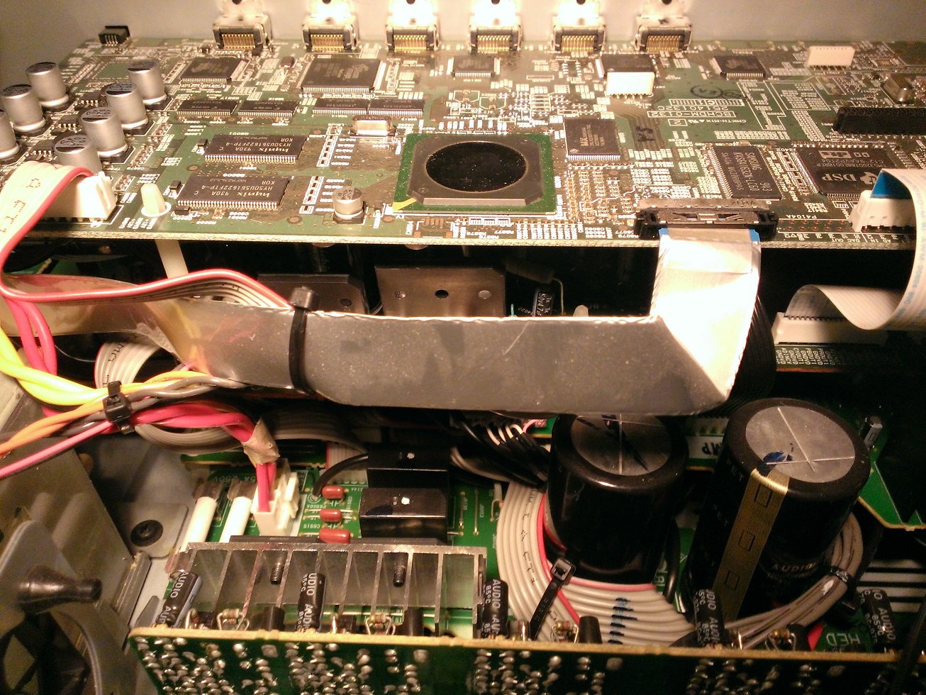

Picture showing the HDMI PCB of my dead receiver:
attachment.php
Hot BGA chip that is further heated by a hot bridge rectifier below.
Notice the silly print "audio" on the closest small elcaps (power amp frontend). But they cannot cool the chips. :headshot:
